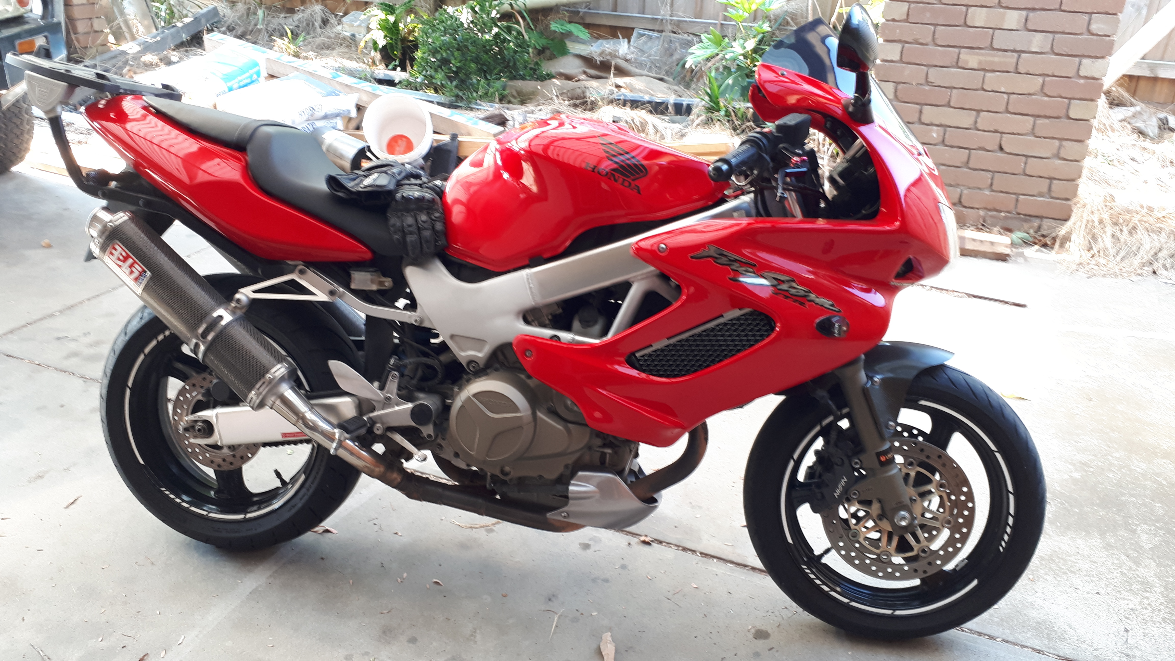

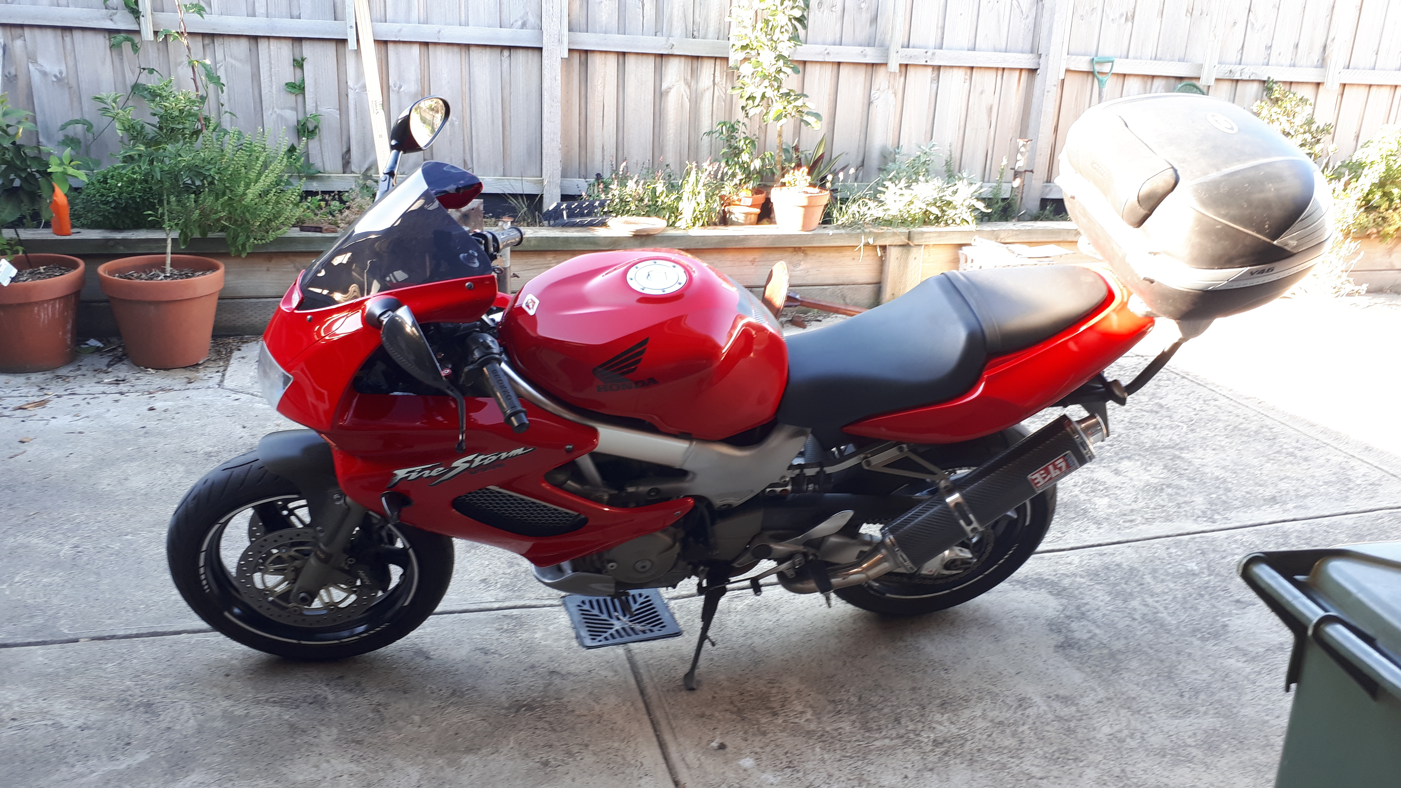

Just picked this beauty up.
40k km
Wilbers remote shock and fork springs
Yoshi pipes
Bunch of other stuff including lights and luggage and gizzmos and all the original parts Goes good
Slightly alarmed at the rising temps on a 27c day in melbourne traffic.
Was staying at 100c, getting up to 104c
Going down to 90 ish at 80kmh.
Idle was hunting up and down a bit. Getting up to 1300 one minute and stalling the next.
40k km
Yoshi pipes

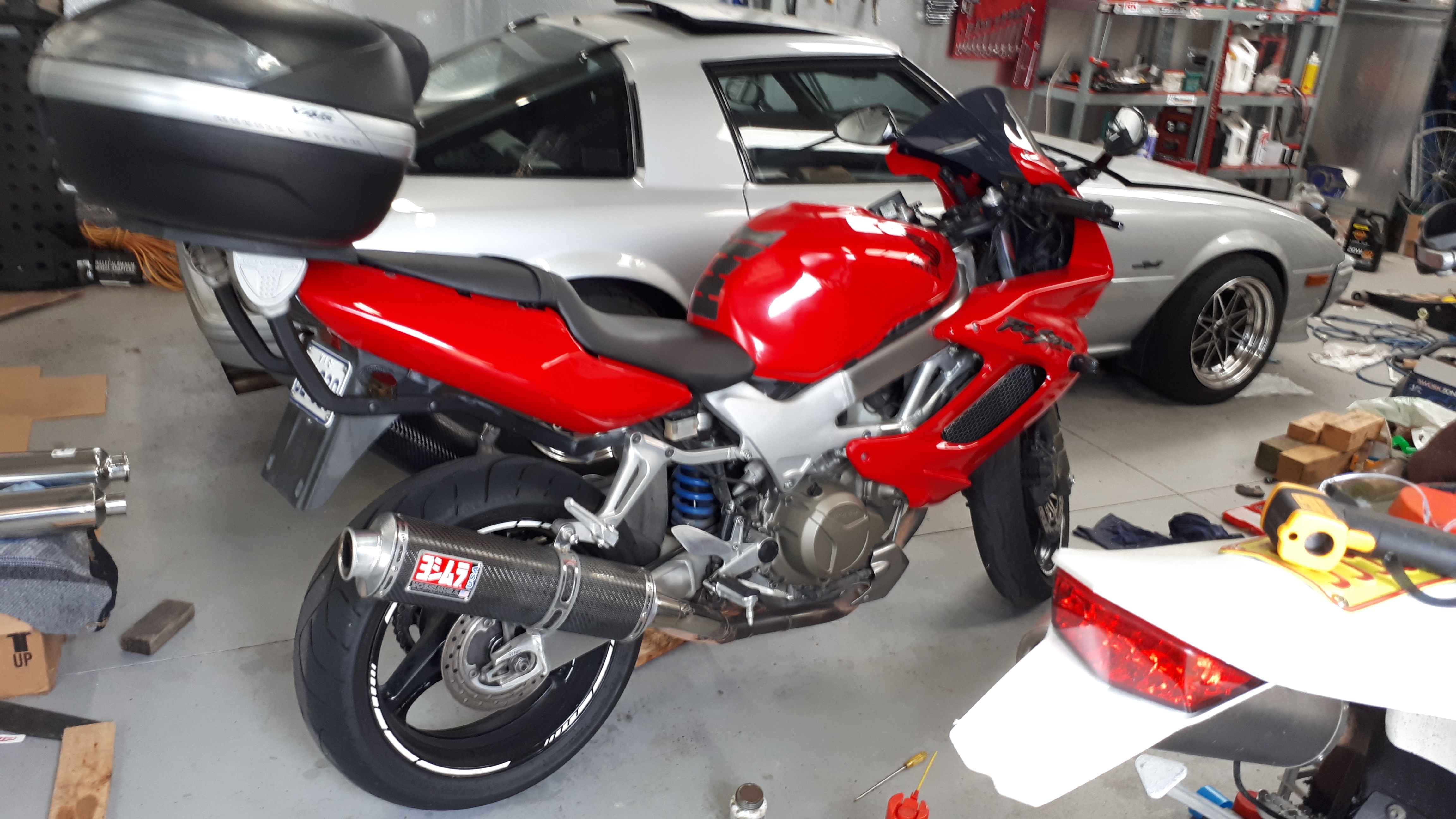

Having a little play, putting the pillion pegs back on so i can start up my taxi service, i reckon it actually looks better with the stock lowmount with these pipes. Dont get me wrong, highmounts like yours are AMAZING, but with mine it just made them sit on a silly angle,,,, anyway its more functional now.
Stock windscreen, indicators and taillight are next. Tailight is a smoke/led arrangement with a programable flasher module. I like the idea of a flashing brake light, but its just not very bright so will put the ie one in.
Indicators pulse more than flash, not sure whats going on there but they are naffy fake carbon which is a pet irk of mine.
Hes also got an HID on it that isnt that amazing so ill chuck an led in there ive got lying around.
Hes also got additional front parking lights leds in the rad vents and red leds in the rear mudguard that lights up the back tyre with the brake lights.
Might be deleting some of that even though its good for visibility, im not sure im a flamboyant enough character to quite pull it off lol. Ill see if i can remember to take a pic next time its dark. pic
