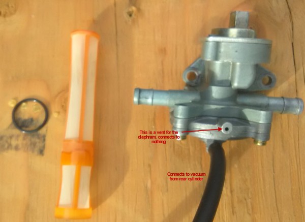

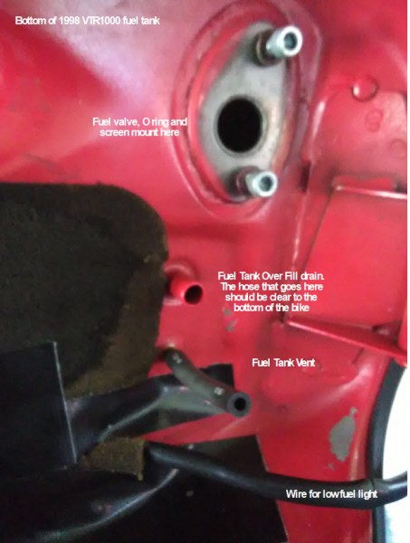

I did try opening the tank and tried running with it open with no change in symptoms. I was CERTAIN the vent or screen or diaphragm or vac source had to be causing a fuel delivey problem, it just makes too much sense. I also bench tested the tank and valve by providing mouth vacuum to the valve. I'm aware of the similar but incorrect nipple on the fuel valve that is the vent for the diaphram. Photos of the tank bottom and fuel valve are attached with comments. I welcome your suggestions, there are plenty of times I have missed something and the symptom is so indicative of a fuel problem.

Peeb wrote: Mon Mar 11, 2019 5:45 pm Image
Unless I'm mistaken the take off spout for the rear cylinder vacuum hose on the petrol tap is normally at 90 degrees to the vent spout, not sure if that would make any difference :eh:
Re: Engine Loses Power after 1.5 miles
Yes the angle on the reassembled vacuum spigot plate could possibly be interfering with the proper action of the diaphragm.
Definitely worth swivelling around to rule that out so its pointing horizontal. And a chance to check its sited well and doing its job.
High Chris, I can clock the fuel valve so the vac is 90 degrees to the vent. I did flow test the tank on a bench by applying vac to the valve and the fuel drains out the two supply pipes so fast it's empty from 1/2 full in just over a min. Thanks for thinking and helping. Peeb
