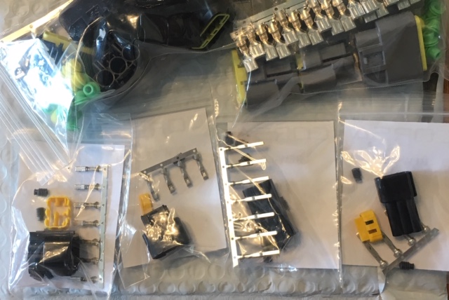

The Postman giveth ...
Let the games begin
