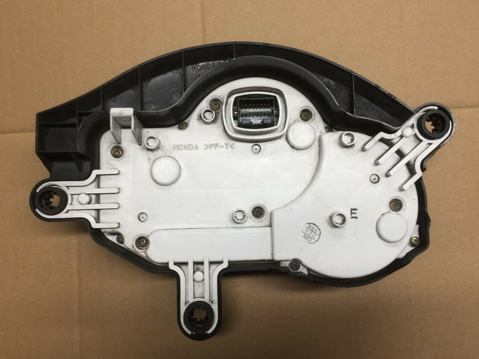

Late clocks...

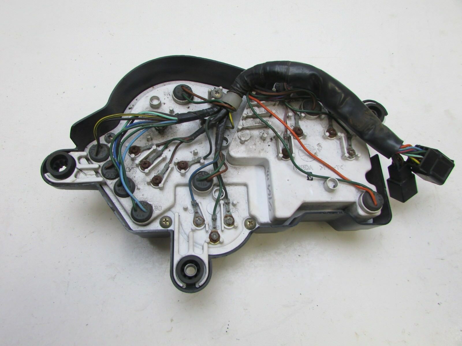

Compared to early clocks...
On the early the row of 4 grey plugs with wire coming out are the bulb holders, in this case the stand, hi beam, nutral light ect The other ones are for the illumination bulbs...
I assume that the late modle clocks have the same just hidden under the panel...Maybe thy decided to make it more waterproof because of the LCD section...
Strangley on the fiche it only shows one bulb for the late clocks... https://www.bike-parts-honda.com/honda- ... 01/2/11482
So you would have to split the case for access & find out how many there are...It cant be just 1 ? Can it...
