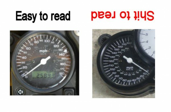

VTR Speedo, easy to read on the 1998-2000, crap to read on the 2001 and up.
The backlighting on 2001- up has white light through red plastic overlay is crap compared to the white back lighting though white on the early models.
Adding additional lights on the front side helped https://www.superhawkforum.com/forum...ighting-33868/
The later model speedo face has smaller digits and those digits cramped closer together on the late model speedo face, and the dual markings of KPH all add up to a mash up blur "stuff" when trying to take a peak at your speedo in use...

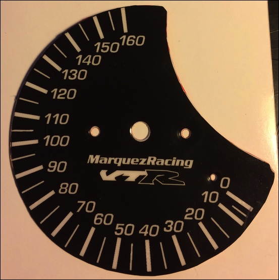

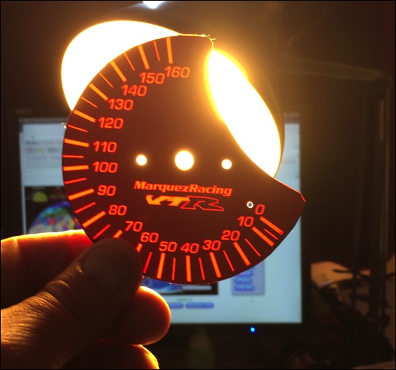

So the task was a new speedo face that got rid of all the "unneeded" stuff.
The VTR in stock and even modestly modified form is not capable regardless of what your buddies uncle said the bike would go before he sold it to you...
Add to that I run lower gearing, and max speed it 148 at redline (which my bike pulls quickly vice a stock geared one that....well argue that on a different post along with talk of unicorns, 100 MPG you get from your VTR, that time you went 186 MPH and other fantasy topics)
For me, a speedo face that had numbers above 150 or so was a waste of space...
Plus I don't need the dual speed markings so we can do away with those as well for a cleaner uncluttered presentation.
An idea was born.... create a new speedo face with the numbers and hash marks larger and more spread out using a smaller speed range and remove all unneeded markings.

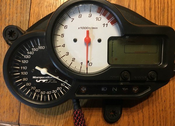

To do this you need a electronic speedo correction unit and a new speedo face....I had the correction unit already (HealTech V4) and a Mate here with the ability to make the new face...
The install was done weeks ago, but just got around to working on the correction factor that allowed near perfect MPH readings at 10-140 ^
I run 15/43 gearing,180/55 ZR 17 73W Pilot Road 4,and right now the V4 is at -14.8%
I made several runs past a radar gun last night, and confirmed my GPS findings that I'm off just a hair at 30MPH, and 1/2 mph at 100 or so and up.
Changing another .1% takes it further off so I'm as good as I can get with this gearing / tire size
