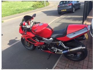

Hi all,
I have been wanting one of these beasts for years. Finally purchased a good second hand one locally.
Comes with 12 months mot, manual cams done 1997 vintage in red and looks really good.
Started it at the guys, took it up the road left it idling loaded it in the back of the van got it home, took it down the road and chug chug to a stop. Got it home, started eventually took it out again and same thing.
I was told by the owner that it has to be full of petrol all of the time else it bogs down.
I discovered the low fuel light was not working last, it is the sensor as bridging the gap on the connector makes the light come on.
Do the sensors go wrong, are they easy to fix.
I drained out around 3.5-4 liters of fuel out of the tank. Would only this amount of fuel in it cause the problems.
It sounds to me like its a fuel problem as everything else works as it should.
All of the pipes look ok, i have no splits in them or fuel leaking so all good here. I want to get the low light working.
The next job is to fill up the tank as much as possible to hopefully eliminate the above.
Sorry for the long message but wanted to paint the picture.
I am a newbie so any help you can give me will be appreciated.
Denzil.
