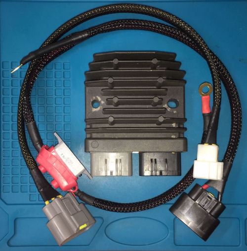

A good way to address all the above possible issues is to install a modern MOSFET RR using quality connection cables pre-assembled. One part of that fix is the MOSFET RR, like a known quality Shindengen FH020 model. BUT the cables to connect it are vital to a good install and life long upgrade of the charging system.
Yes I sell a plug and play kit made specifically for the VTR, but my kit, another kit or one you make yourself.. just make sure the connectors are 1st quality, like sealed style Furukawa 250 QLW Series R&R Connectors, not aliexpress Chinese pattern parts, and please NO hardware store individual crimp connectors.
The RR to stator connection can be soldered as my 1st and 2nd Gen kits were, it works. But means you need to have the tools and know how to make a proper soldered joint, and protect it after. It also puts a stress point in the wire you can avoid with new cable and correct connectors that allow the RR to be connected directly to the stator.
All terminals need to be correctly crimped with an F crimp on the wire and O crimp on the seal for best performance and reliability. Heavy duty brass ring terminals, charge wire circuit protection with a marine rated circuit breaker or ATO style Maxi fuse. Cables should direct fit, no excess wiring coiled up and stuffed.
Cable harness should have stress reliefs, terminal seals, adhesive lined heat shrink tube, cable sheathing to protect against abrasion all contribute to a life time fix and upgrade.
If its not a quality kit and install, you are just kicking your charging problems down the road to appear another day
