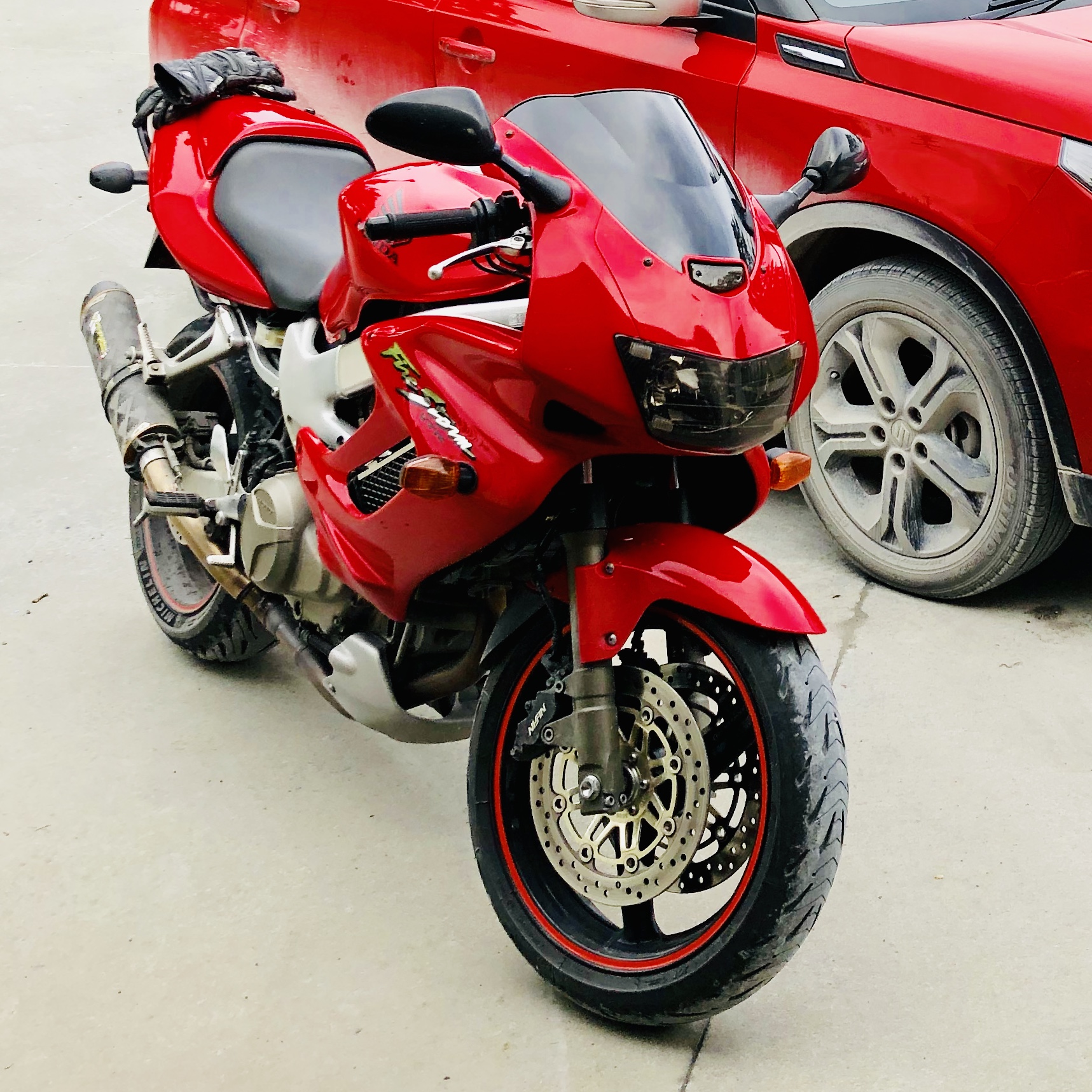

I’m convinced it’s mechanical so will check out what you’ve suggested and check that link. In terms of rear shock - see pic - does the shock look normal? Looks a little short :lol: How else can I check it? When I bounced the rear of the bike it returned to normal position.

There is definitely something amiss and I’m blaming the shock. What do you guys think? See pic - I’ve not taken a close look at the shock before and assuming this is normal?
I’ve no experience with removing rear shocks or testing them - but I suspect I need to get it rebuilt or maybe buy a replacement after market one. I used to have a Maxton on my Falco. I’m in the UK in a few weeks so may take a look (cheaper than here I suspect). Other than bouncing the rear of the bike up and done and looking for oscillations, what else can I check?

I would'nt bother testing the shock,just bin it and buy a trusted new one......
Then get it set up by a tech.

Interesting. Could the linkage be badly seized but not showing any external indications? If not, it must be the shock?
Re: Loving the bike... but what just happened?!
have you had the rear of the bike of the ground, as in all weight taken of the rear wheel and checked for play in the linkage? it may look ok from the outside but a needle bearing could have fallen to bits inside and its a common problem on vtrs.
if you dont have oil running outa the shock and its returning to full extension without, pinging back up its prob grand, or as grand as a standard shock can be, my yellow one dumped its oil in the space of about a mile but the rear of the bike was covered in oil so easy to spot.
swingarm bolt still tight?

As a matter of cource you should at least strip and inspect the shock linkage bearings - you won't be able to see what's going inside just by looking externally at em. When were they last looked at? - I'd guess 20 years ago when it was assembled at the factory.
Stock shock is overly hard,, with front forks squidgy soft - plenty of choice on aftermarket alternatives Which Rear Shock ????
