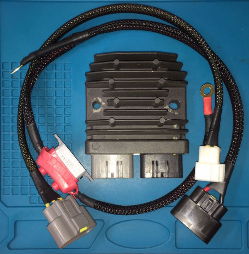

GEN III UPDATE 13 MAY 19 Superhawk MOSFET RR Kit
E.Marquez
Posts: 635
Re: Indicators, reg/rec & battery cooking...
Post by E.Marquez »
MMS GEN III RR kit.jpg (75.21 KiB) Viewed 1562 times
One kit, all common charging system issues addressed.
Spend the money once and be done with it.
If you make your own kit, invest in the tools and proper quality components to do it right, or your just kicking the problems down the road.
