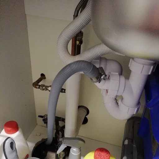

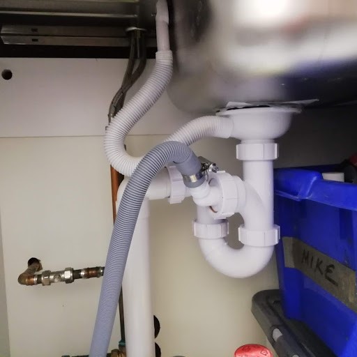

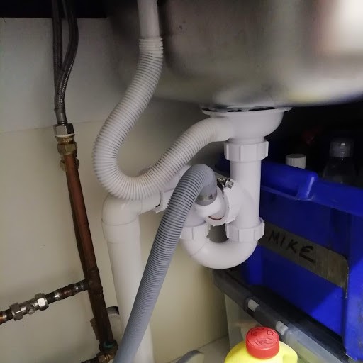

In late June I had a new kitchen sink. Some time (6 weeks ish) afterwards it started to smell when I drained a load of water away. Smelly air being forced up the overflow. Is there anything wrong with the plumbing? I've sent loads of noxious chemicals down it but that hasn't made a lot of difference. Note, the grey flex is the washing machine drain. The white flex goes up to the overflow.
Expert advice much appreciated.

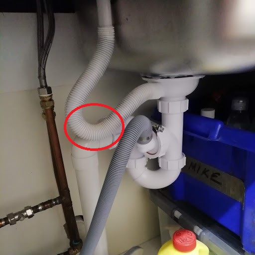

First of all I'm not a qualified plumber, although I have done a fair amount of plumbing over the years which include fitting many new kitchens where I did the plumbing myself.
Looking at your photo's I would say your sink overflow waste pipe is too long. Due to that you have a self made trap (where I have put the red oval marker in the photo) where dirty water from the sink is being held, that would lay there and only be flushed through when the sink is filled up and water is going down the sink overflow again. That water being held there would go stale, then when you empty the sink the water going down the main outlet would push the smells back up through the sink overflow pipe.
You need to cut the sink overflow pipe shorter so there is no trap, it will then empty when it has water going through it.

Oops two minds think alike :eh:
By the time I got the photo sorted out and posted it with my reply Pete had beat me to it :lol:
