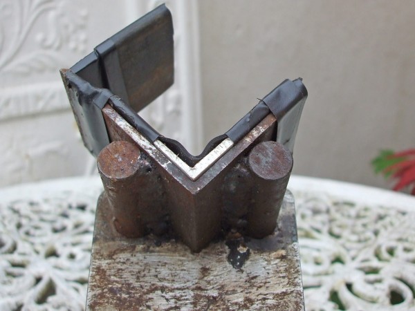

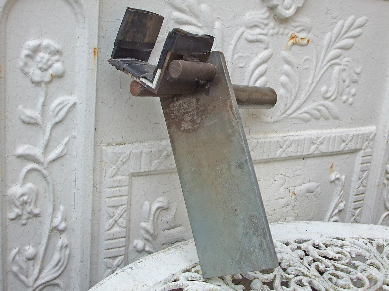

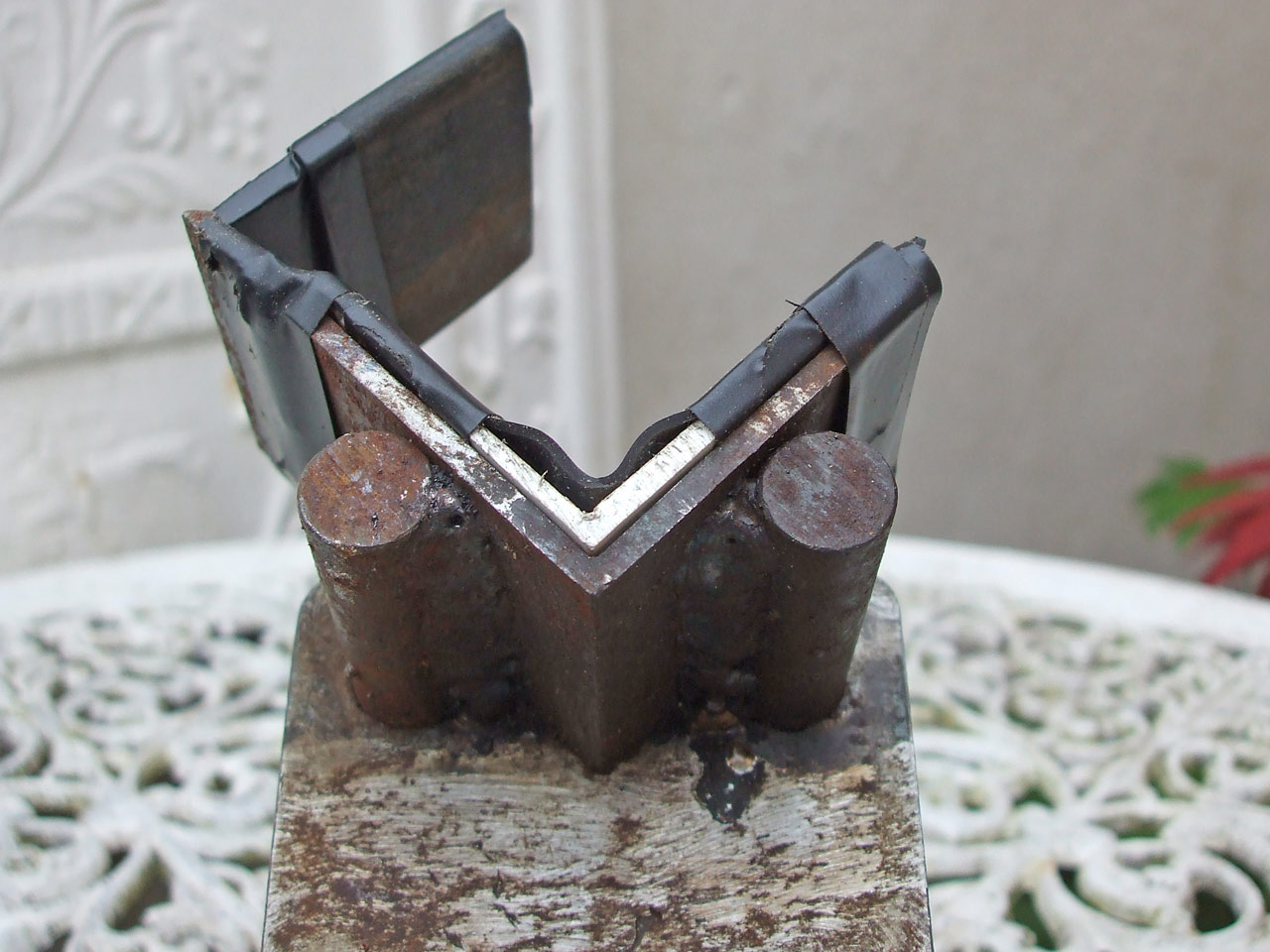

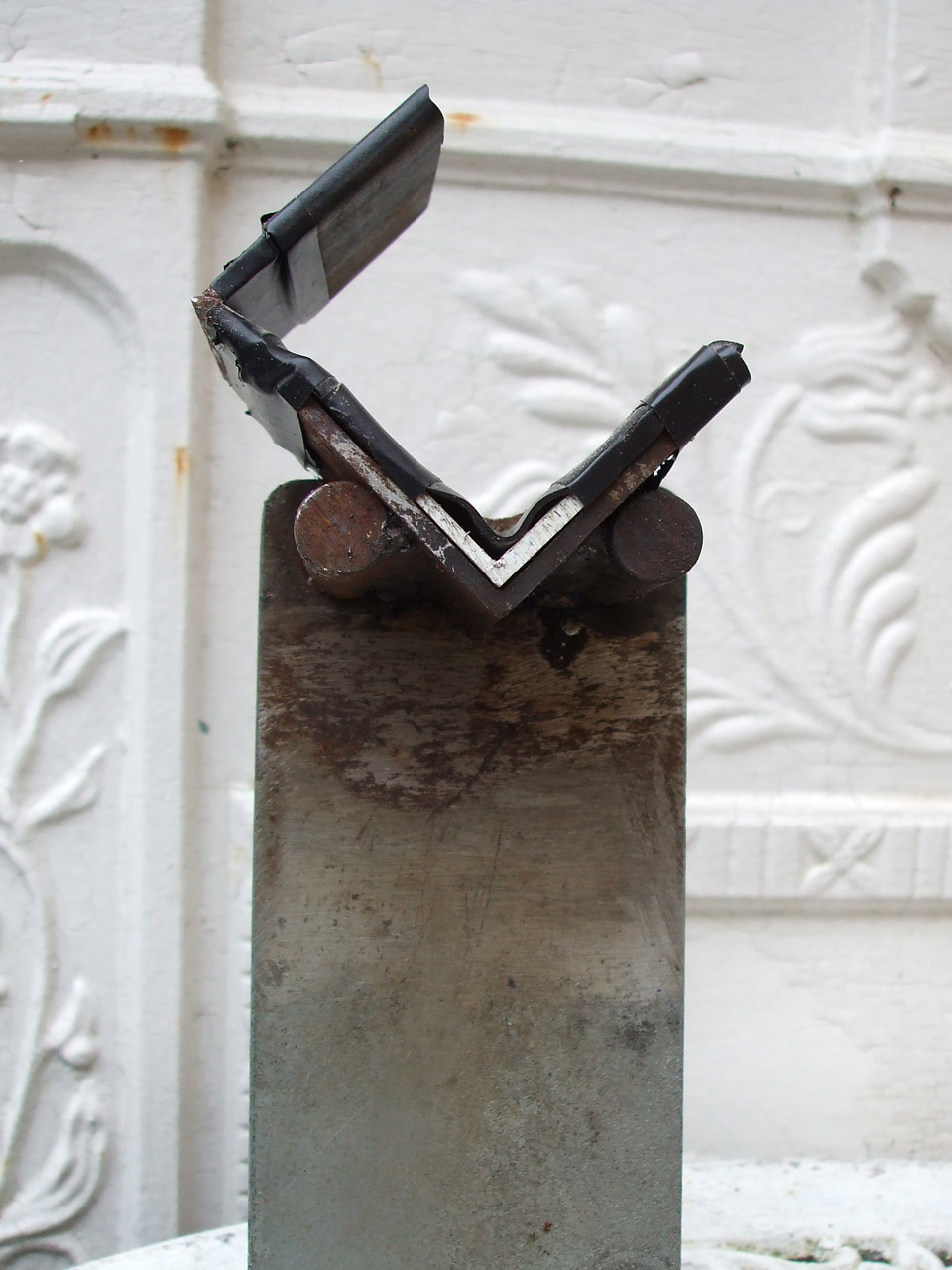

Many years ago I made my own front stand based on the two pins model as TaxiDriver has above. Knowing what I know now I probably would have taken a different route. I found the fork legs very easy to slip out of the two pins, you had to watch very closely (both sides) as you lifted the bike up on the stand, sometimes even moving the position of the fork legs in the stand while holding the stand part elevated which was not easy. So I can see why TaxiDriver has modified his :clap:
Not happy with that I modified mine so that the fork legs cannot jump out. Okay it means this stand will only work with forks the same dimensions as the Firestorm/Superhawk fork bottoms are, but that is fine for me.
I used angle iron for this modification welded it in position. I have an inner tube cut and fix in place with insulation tape to protect the paintwork on the fork legs.
It doesn't look the prettiest in the photo's I know, but it shows you what I have done.
