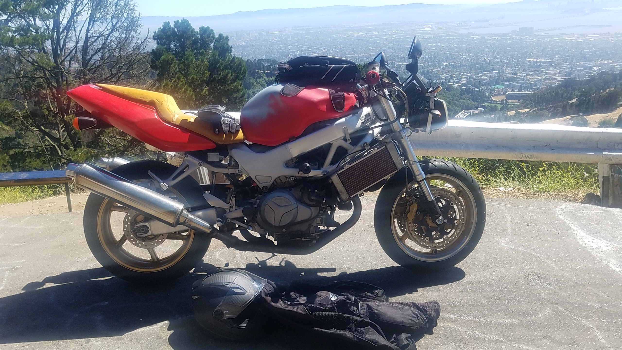

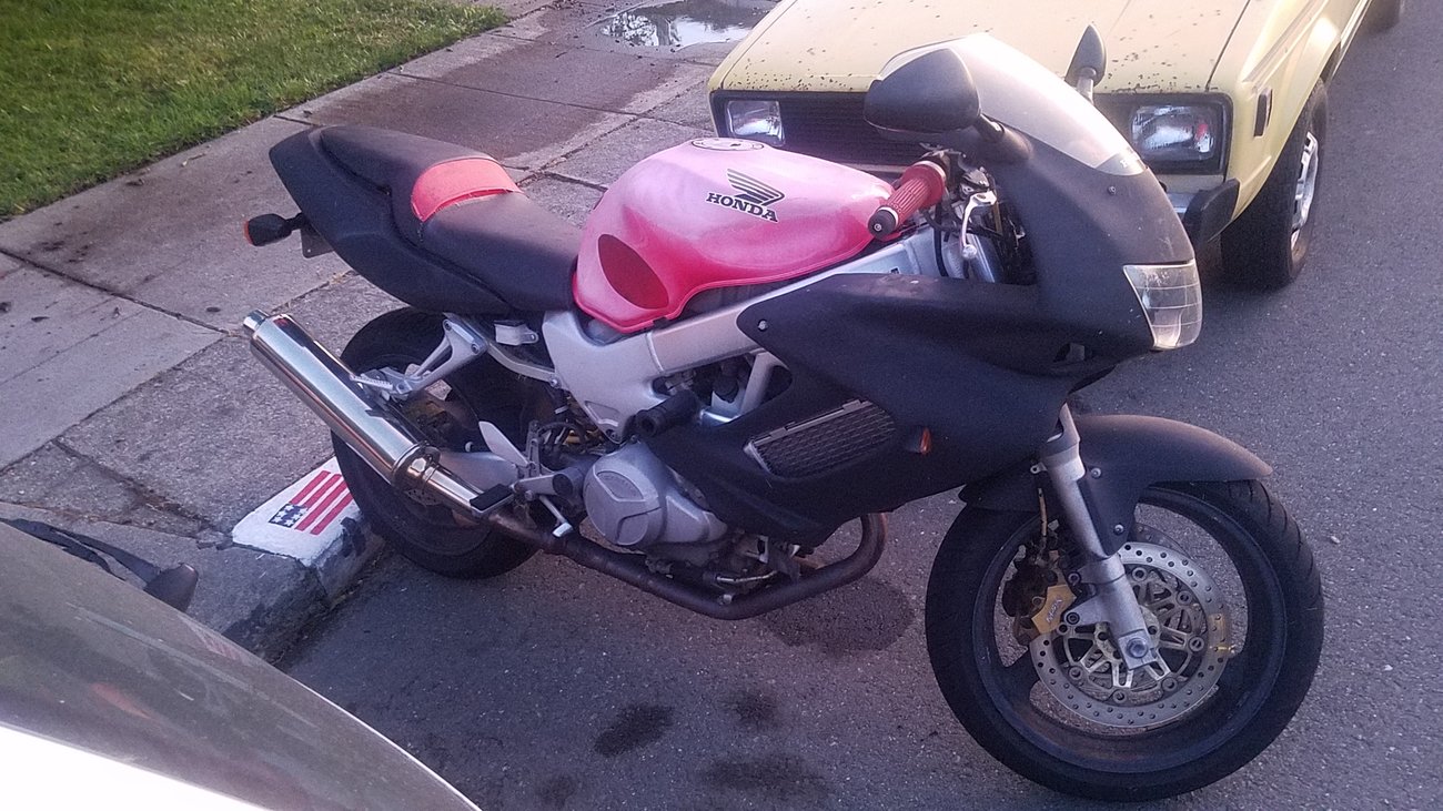

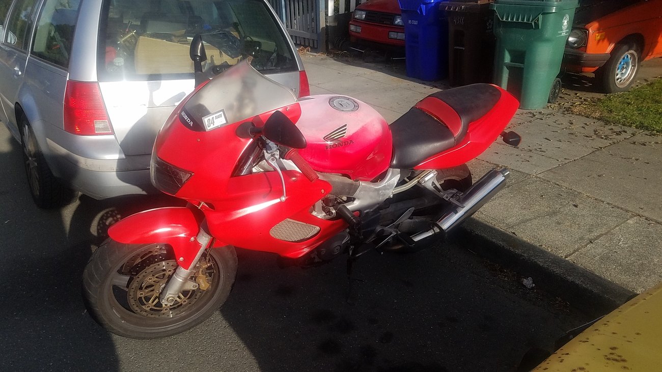

So... My brother offered me his old '98 Superhawk the other day... This is it when we got it off the truck...

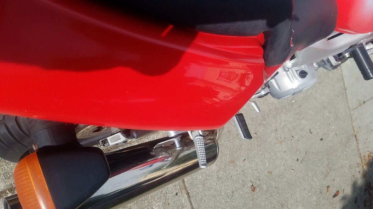

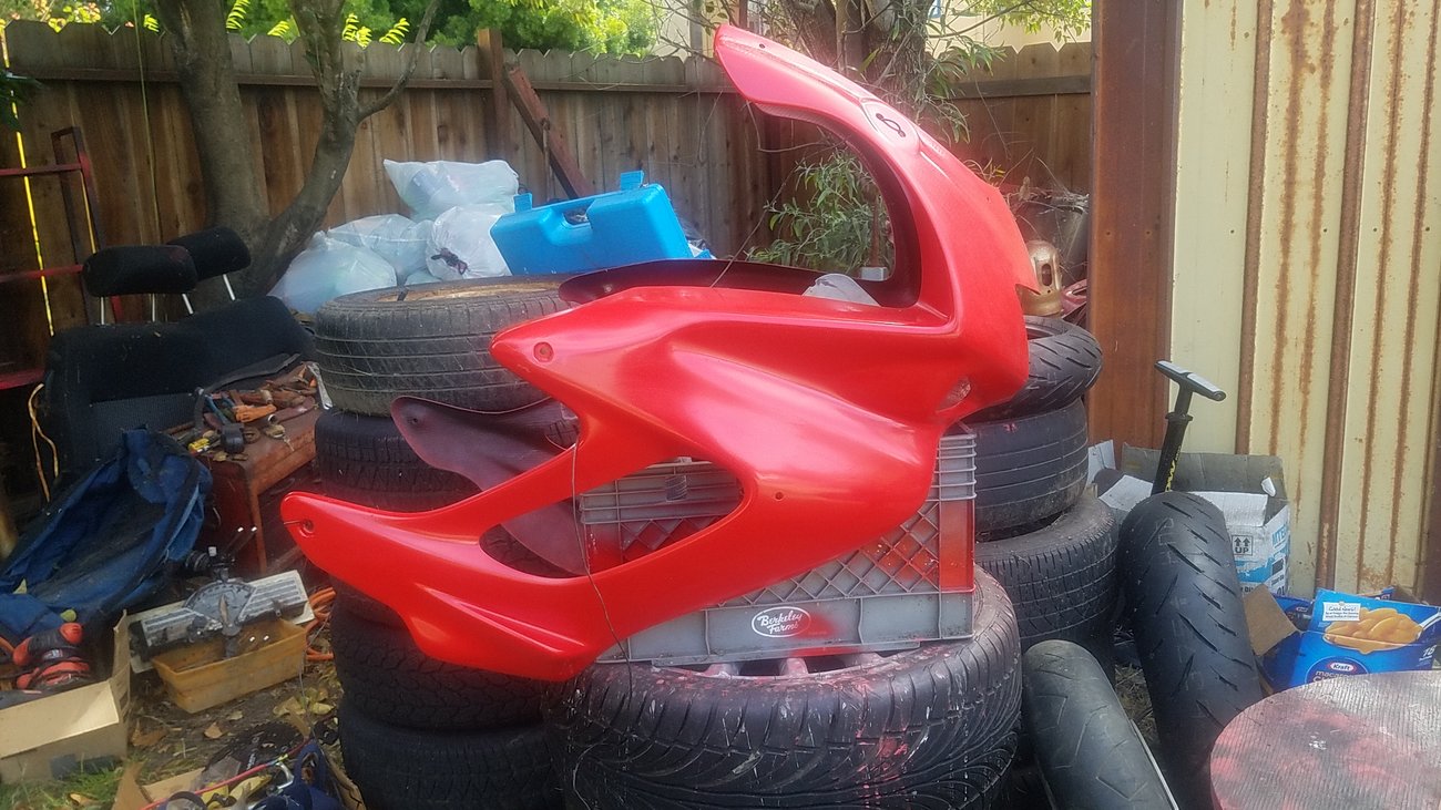

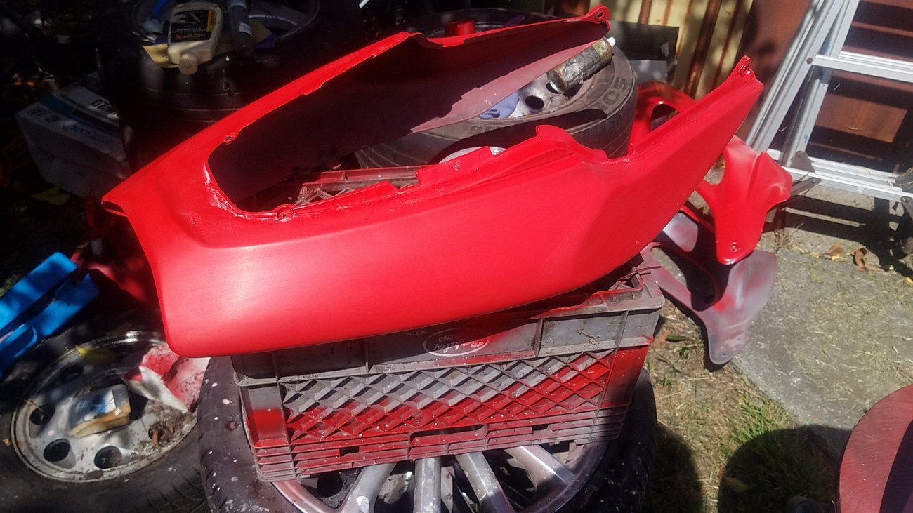

Got some rattle can paint and started prettying her up.... 3 coats of base, and 7 coats of clear wet sanded and polished....
Had a crash a few years ago, and the front fairing was replaced with a "race" one piece fiberglass...
Still have to finish the tank.....

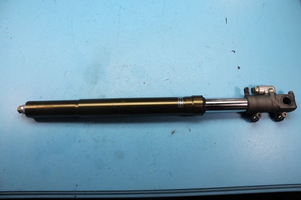

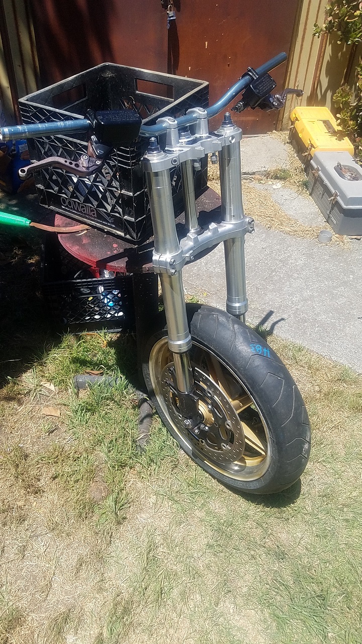

From there, I was just going to throw some new tires on it and ride..... So, naturally, I bought a new front end and wheels.... CBR954 front forks, LSL top triple with bar conversion, and rc51 front wheel carefully re bearinged and spaced to work in the fork.
And matching(ish) cbr900rr rear wheel....

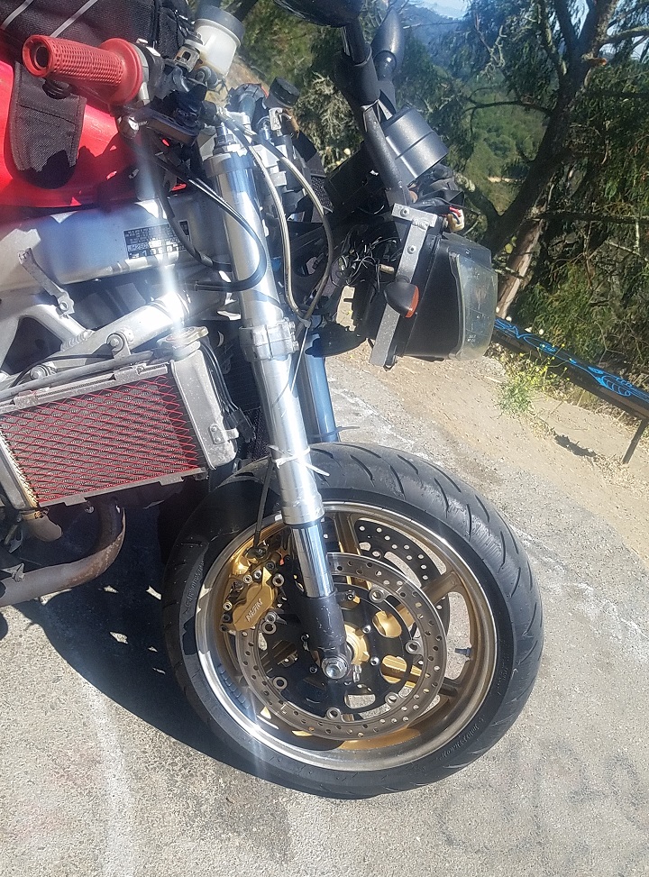

I got the RC wheels in anticipation of a full RC suspension swap. Only reason I have the 954 front end on, is I wanted the lower triple, and the forks came with them.... :D
Now that I actually have the SP1 fork tubes, I can start the front...

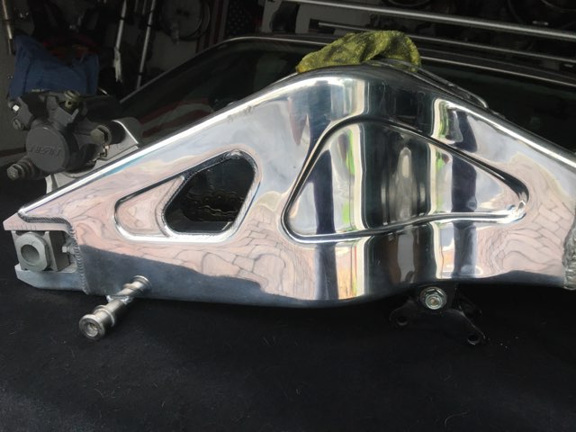

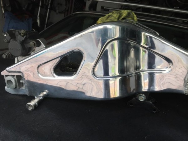

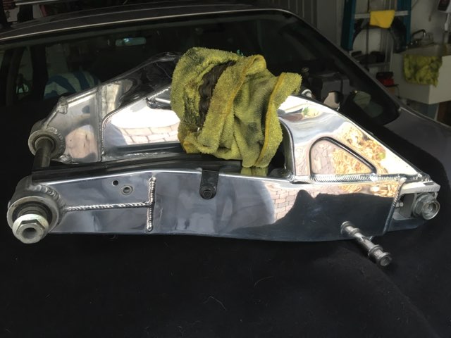

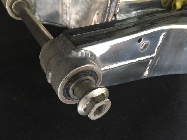

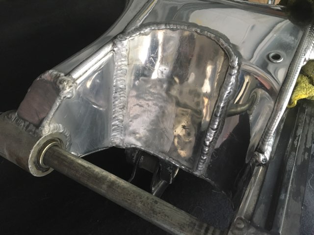

Then, I get to install this beauty.... RC51 rear swingarm that has been modified to fit the Superhawk.... Shortened, SH pivots welded on, and clearenced for shock.

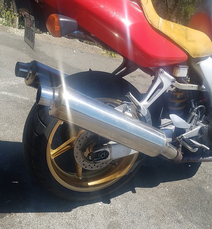

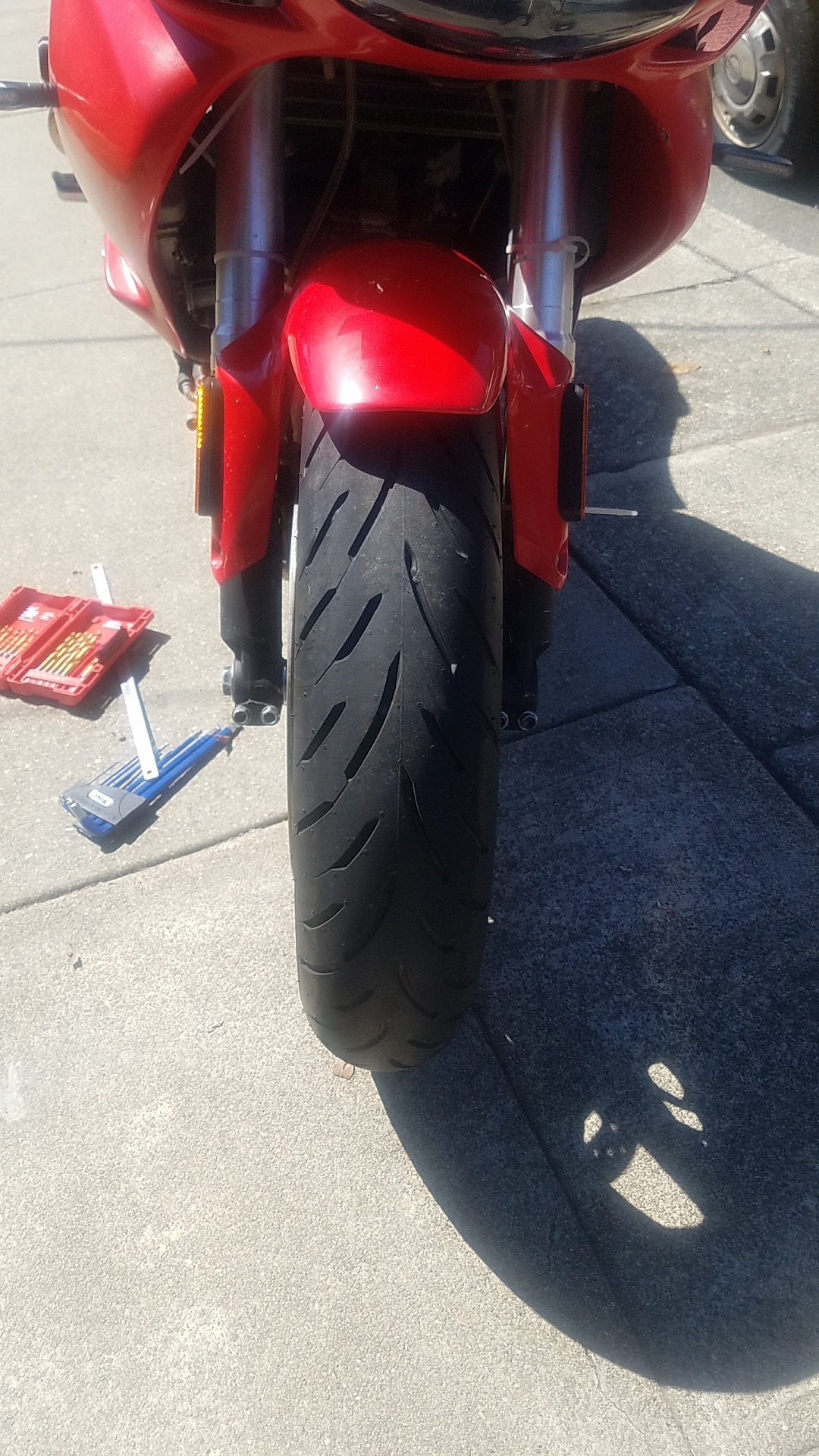

Had to do something.... So I added a front fender from an Aprilia... Much cleaner look than the stock options.... Even came in red.....

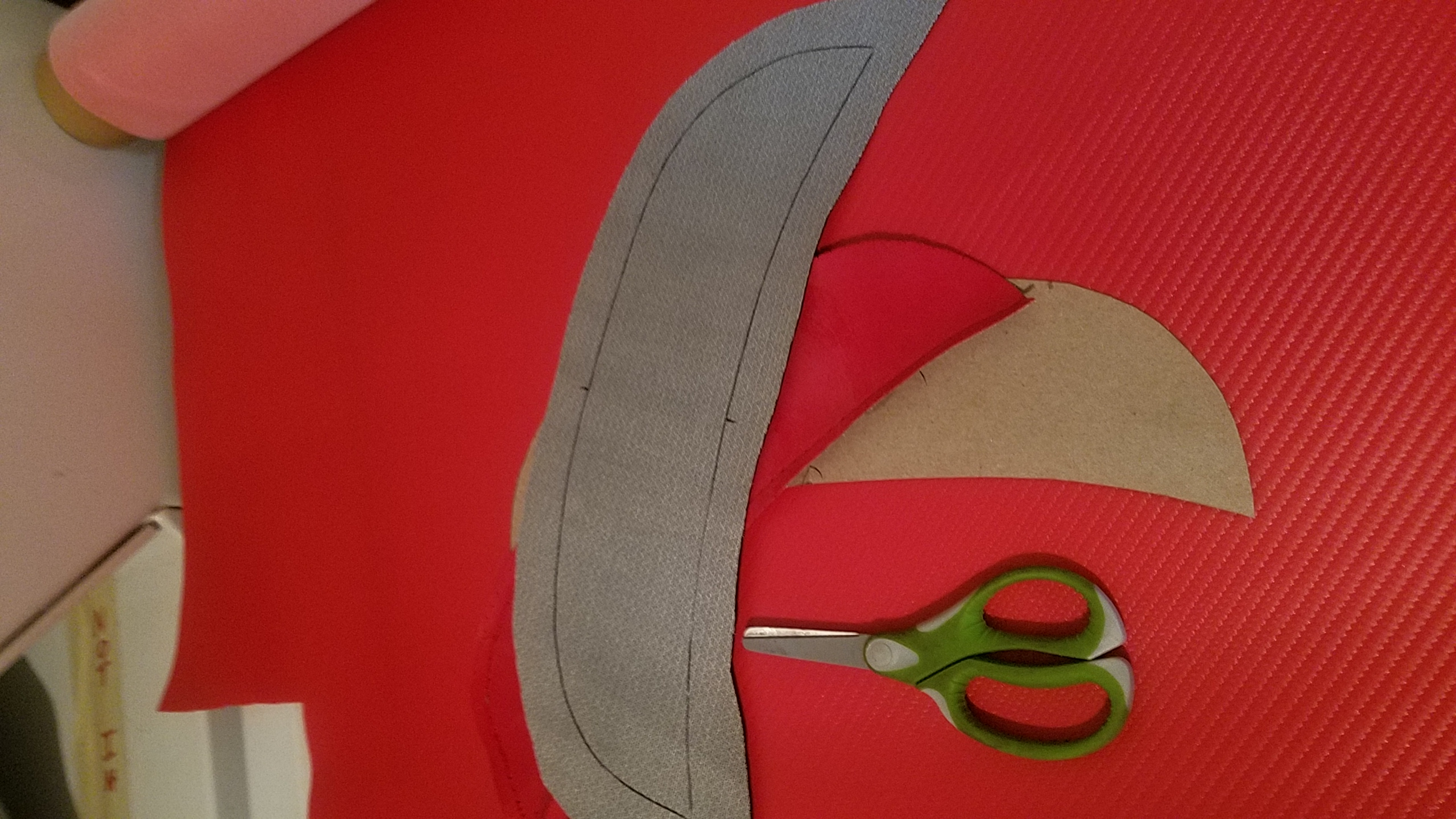

I am going to spend the evening attempting to sew together a cover for my "Sunshine" seat..... Got some red and black "carbon Look" marine vinyl....

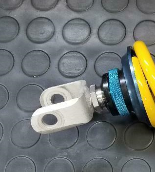

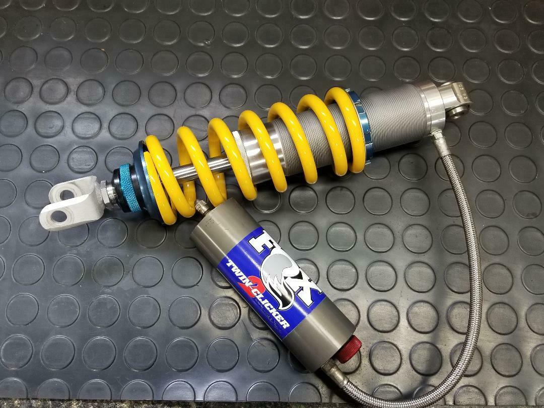

Just picked up this beauty to add to the parts list... Minty Fox Double Clicker... It is from an early Ninja 600 (zx6r) but is the right length, and stroke. Just need to change out the bottom eye. Friend says he might have one for me.. :D Also know a guy with quite a selection of used springs.. I am going to borrow a few to try to figure out the right rate...

Re: Brother's old Superchicken
"It is from an early Ninja 600 (zx6r) but is the right length, and stroke"
VTR Shock Length 346mm, ZX6R (03-04) 340mm (+12/-0)
VTR Shock stroke 60mm, ZX6R (03-04) 72.5mm
https://www.customfighters.com/forums/s ... hp?t=12827
Looks like length can be made the same - just the different stroke length.
My aftermarket shock was originally for a Suzuki GSXR750 and came my way via being used in a Fireblade - Had it rebuilt to suit the VTR.

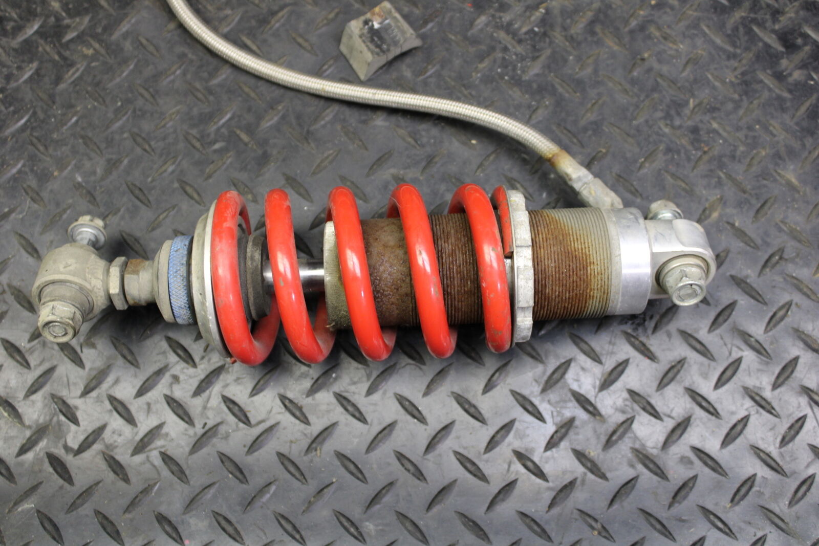

It is the exact same body and stroke as what they sold for the VTR. Only difference is spring rate, and lower mount.... Just picked up a junk cbr shock to rob parts from. It has the right bottom eye...
I hope between the two, I can get it right....

Posts: 7299
Great build Eric!
I've never seen a RC51 Swinger fitted to a Super Hawk before. Most people said it couldn't be done and was too much effort.
Kudos to you for proving them wrong :thumbup:

There are a few guys over on the Superhawkforum.com that have done it.. Most are full length, and have cut off the shock mount, and welded the superhawk mount on. It is mostly a game of spacers to get it to fit, then you have to come up with a different solution for foot pegs.
This one was shortened, and since theSuperhawk pivot points are used, I can keep my foot pegs.... Can't waitto get it on... But I think I should swap out the pivot bearings first...Kind of Chunky..
