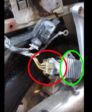

Just please do not but the cheap ones off the bay of evil from china... See pic below.

NOT mine BTW but this is what can happen hence the trem Rectum Fryer...!

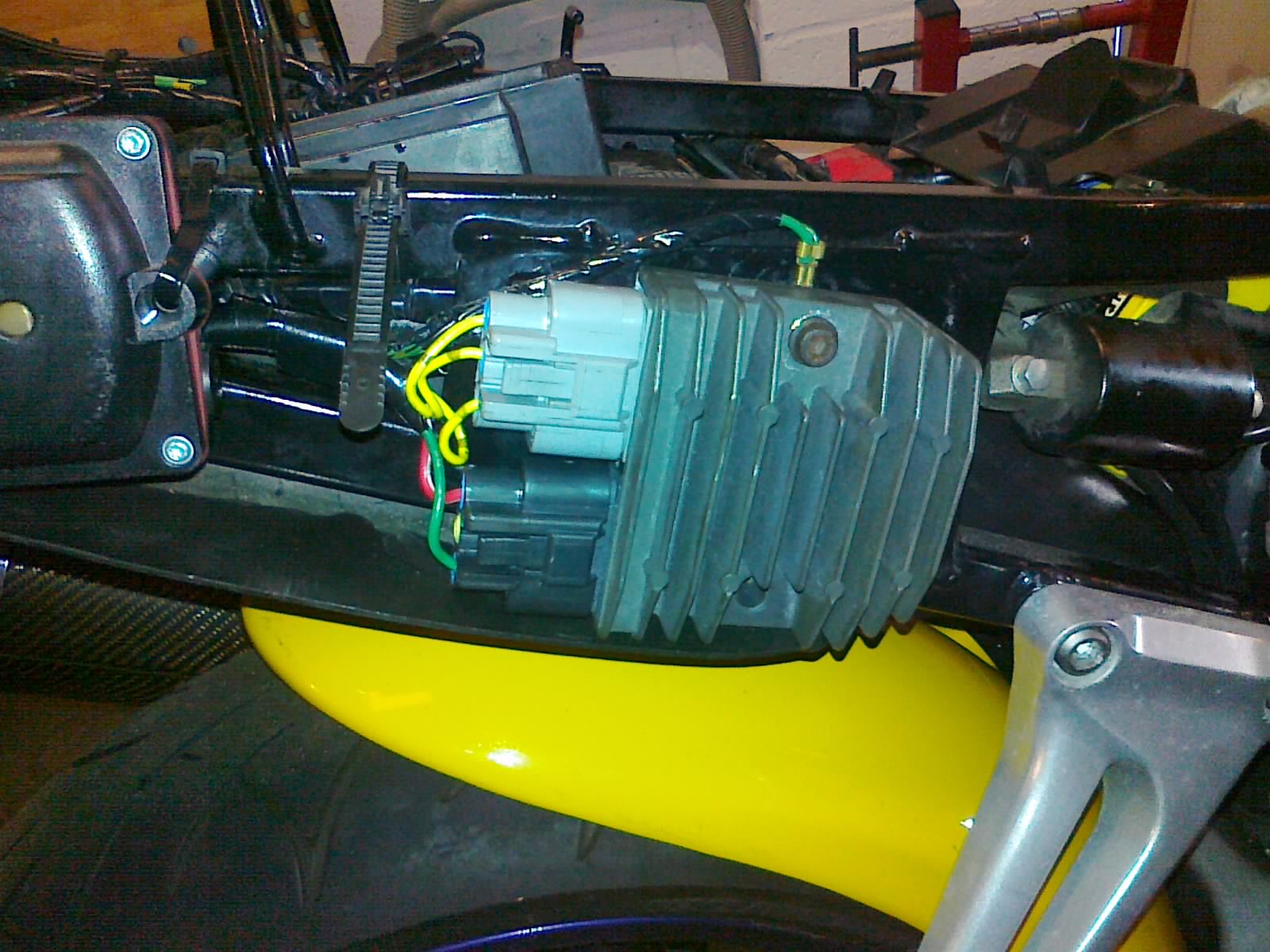

Or if your handy with the wiring get a late year Yamaha, Triumph Or I use BMW S1000r ones...
They are much bigger so you need to relocate the indi relay in the pick above the extra box is an alarm but thats been sacked now...
Your choice here with the rewire is to buy a separte fitting kit or you can un pick the the conectors from the old block & just plug in.
What ever way you do it the yellow wires can go in any order but the red & green have to be the right way as is in the pic above Red left, green right... That one is fitted with the fitting kit so wires cut & re crimped with new conectors.
