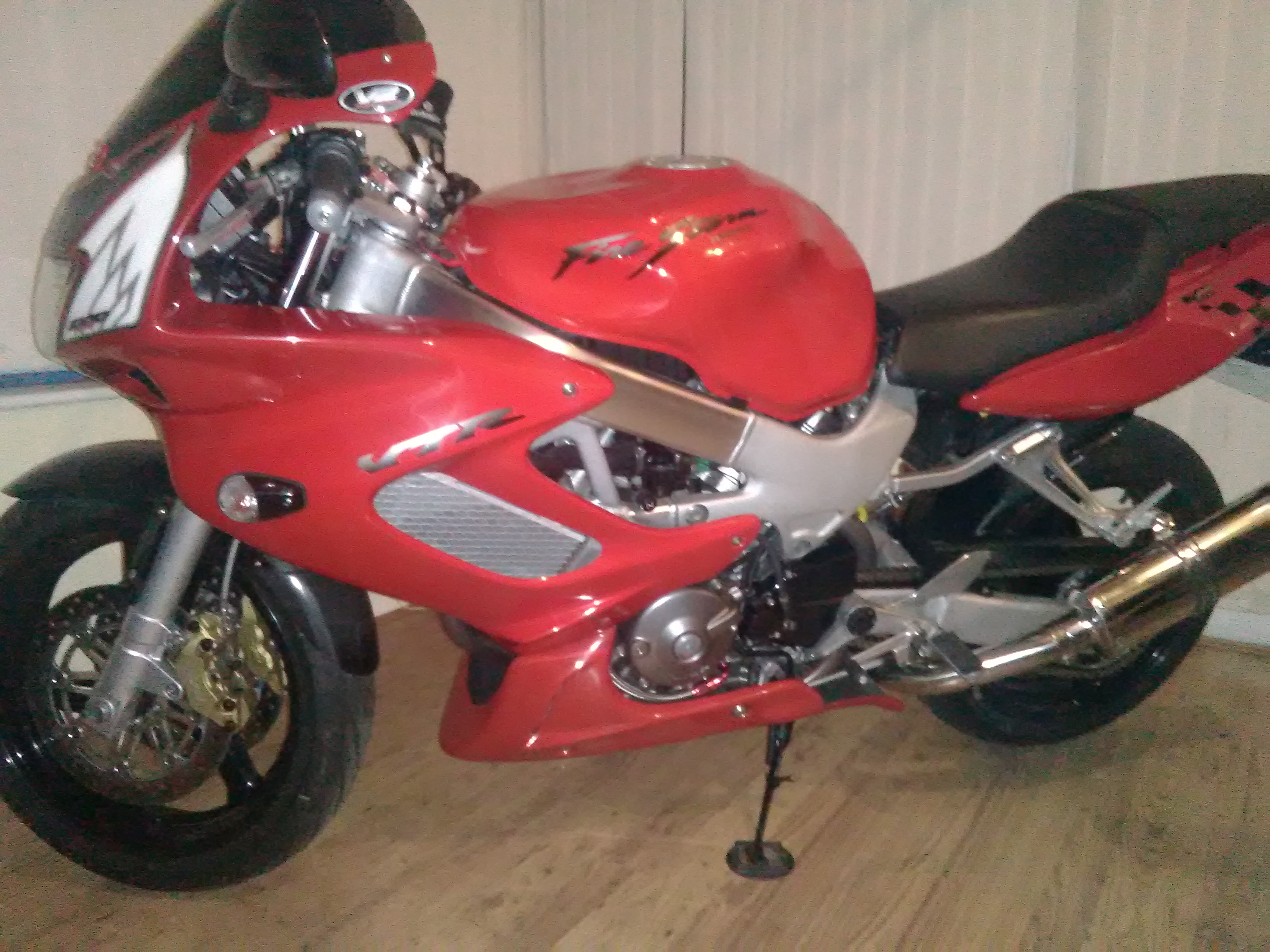

Finally got a firestorm. Guy was asking dealer price but it was only down the Rd from me when I seen it it looked like a 6 month old bike iam sure it's been rebuilt. If I'd of walked away I'd be a fool. So picked it up next day and broke down on way home. It had been sat 6 month🤔. So drained carbs and sprayed carb cleaner through them. The plugs were black and wet. Mixture screw are out past the flange casing. Looks like it had dyno jet's fitted as has delkavic pipes on it. Do I adjust mixture as any carb. I need to get a bendy screwdriver unless you lads know of another way.

Cheers I have good read through that. Got it running revs up OK no delay or misfire but tick over is bit up and down sometimes cuts out but starts up OK. Still trying make something up to adjust mixture screws. And I will try post a picture

I try answer few comments. When I took tank off there's a k+n air filter and dyno jet sticker on air box. Tick over sits about 1200 rpm then drops down to 600/700 rpm then up to 1500 rpm small burp from front carb then stalls. It smells really rich I changed plugs as they were black and wet. Iam not confident to take carbs completely off. I've tried to bendy extension screwdriver bit. Allenkey with bit on and can't quite reach mixture screw. My eyesight doesn't help so specsavers here I come.
