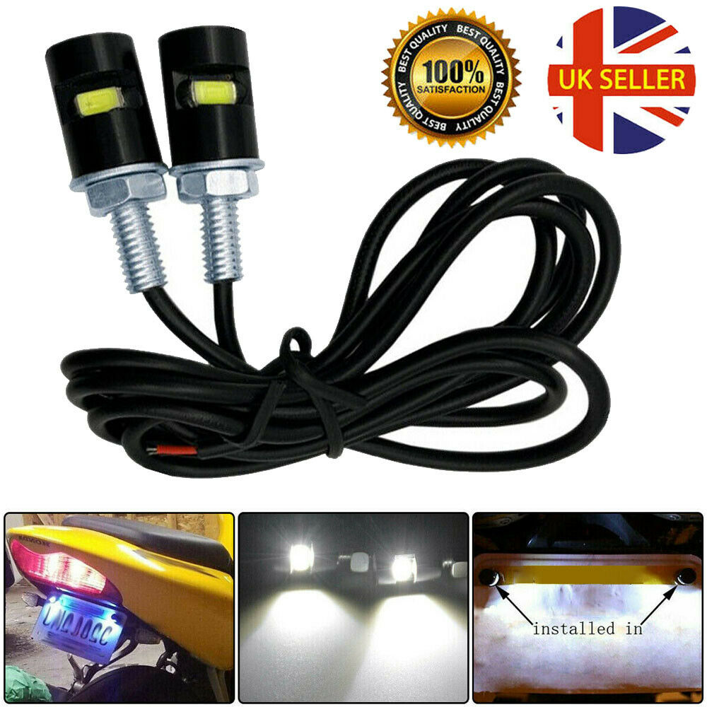

Has anyone fitted an LED rear light and if so how did you get around providing a number plate light?.
Re: LED rear light
That is a job I need to do sometime :lol:
I intend to use 2 LED bulbs like these below. There are plenty for sale on Ebay.
I think on the Firestorm you can fit these above the number plate :?:

The only think you will need to do besides the number plate illumination bulbs is to blank off the clear plastic window that allows light to shine down from the original bulbs to illuminate the number plate. If you look at some (if not all) LED rear lights for the Firestorm, that part is blanked off for that reason.
