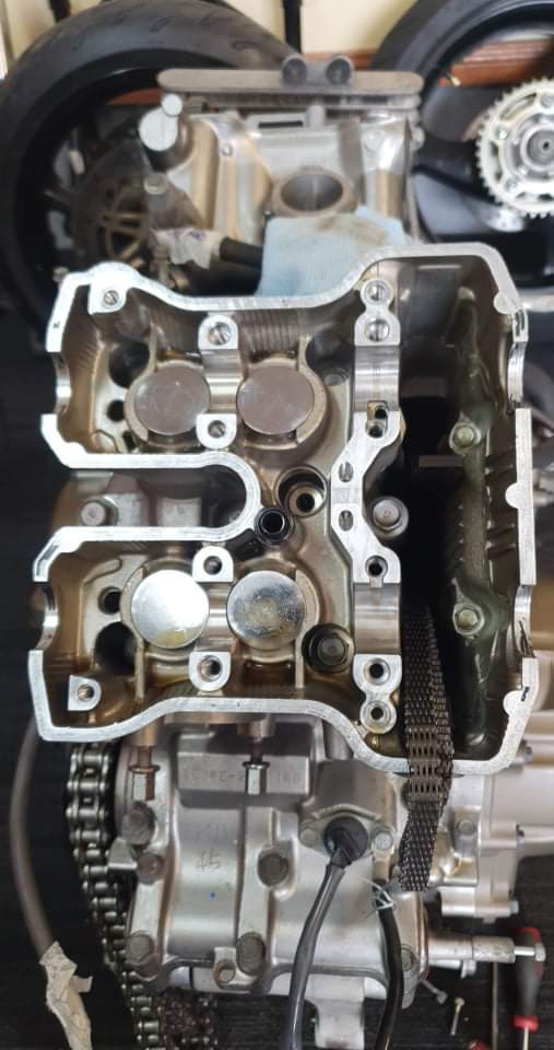

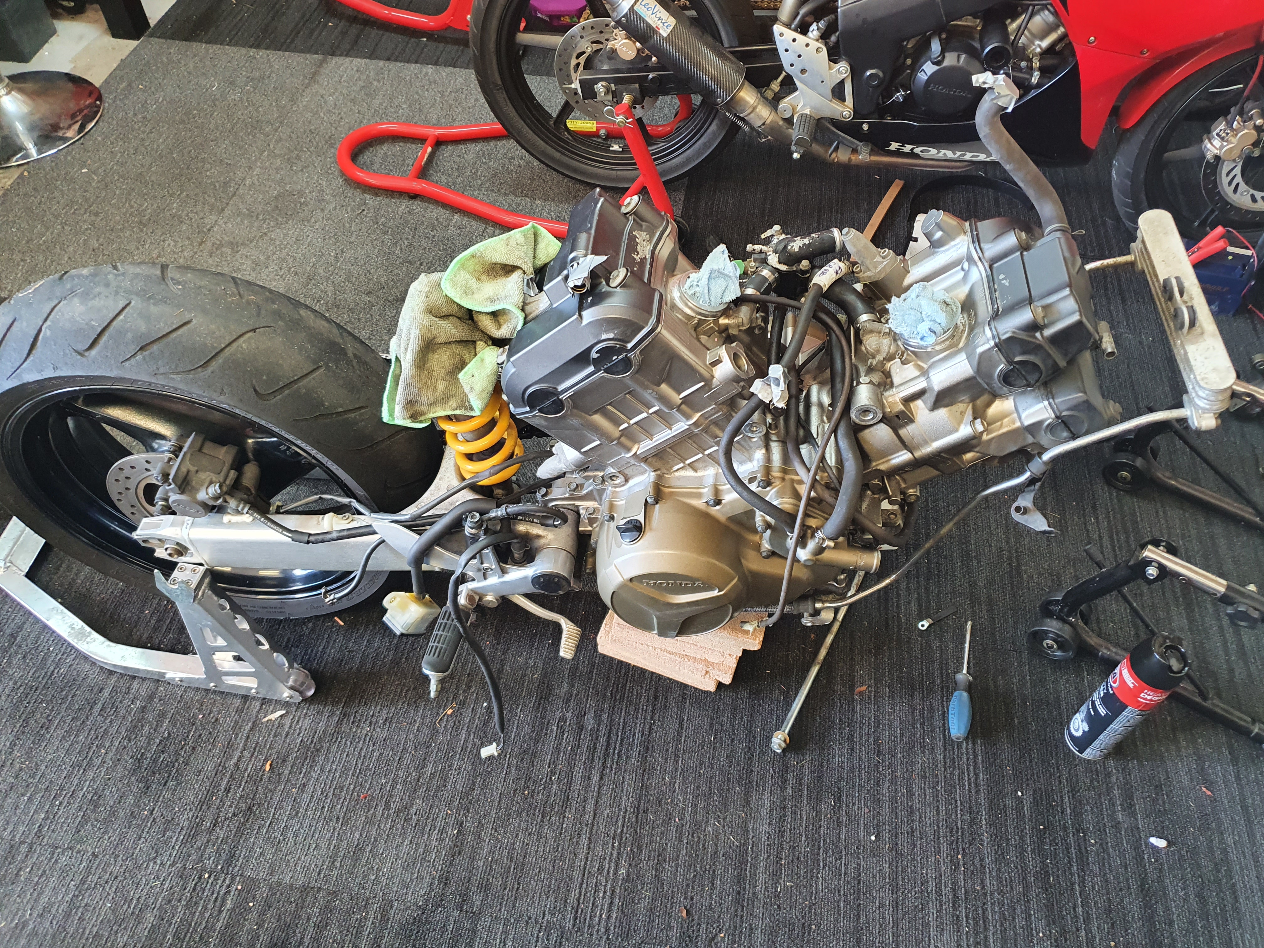

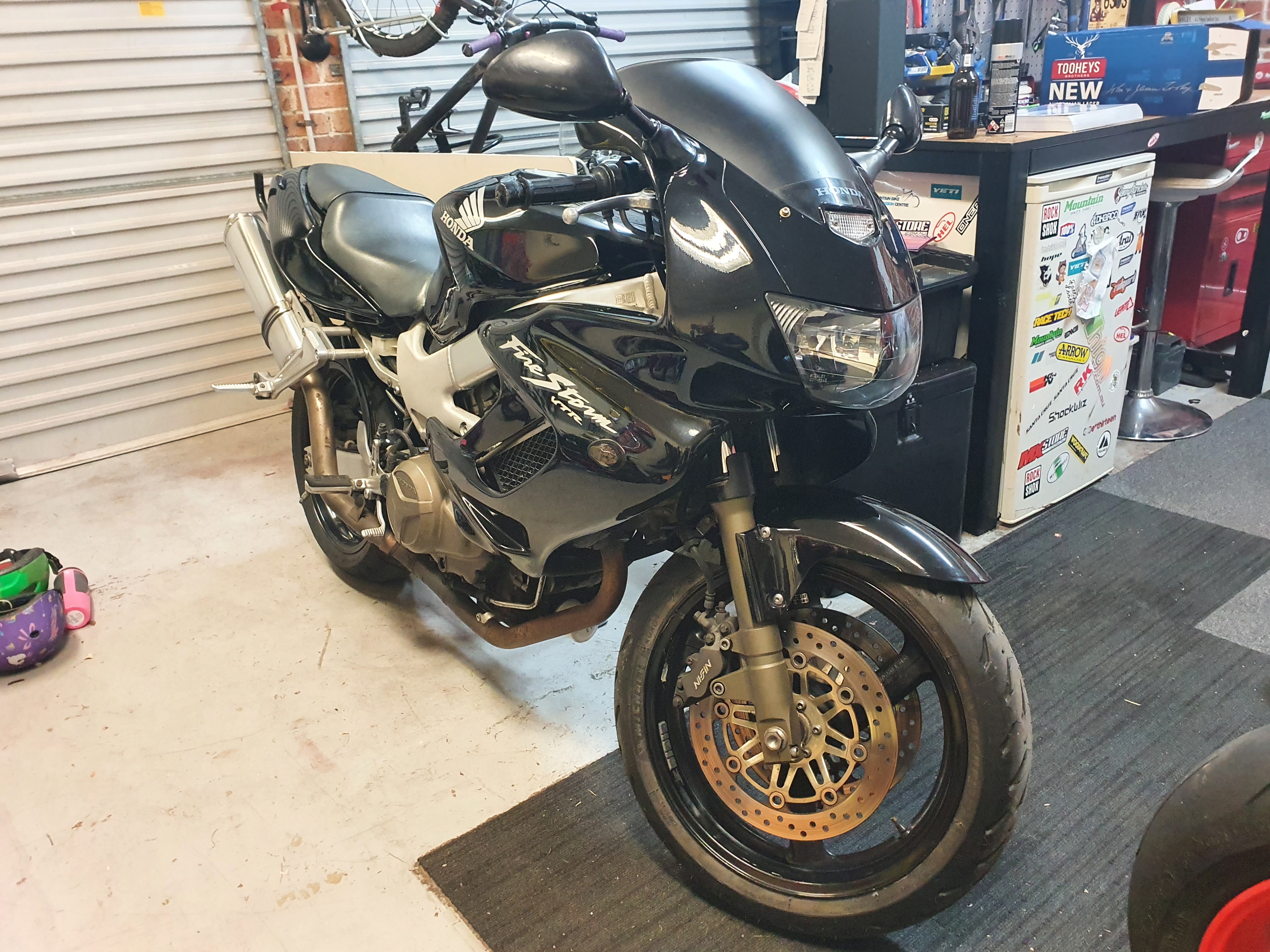

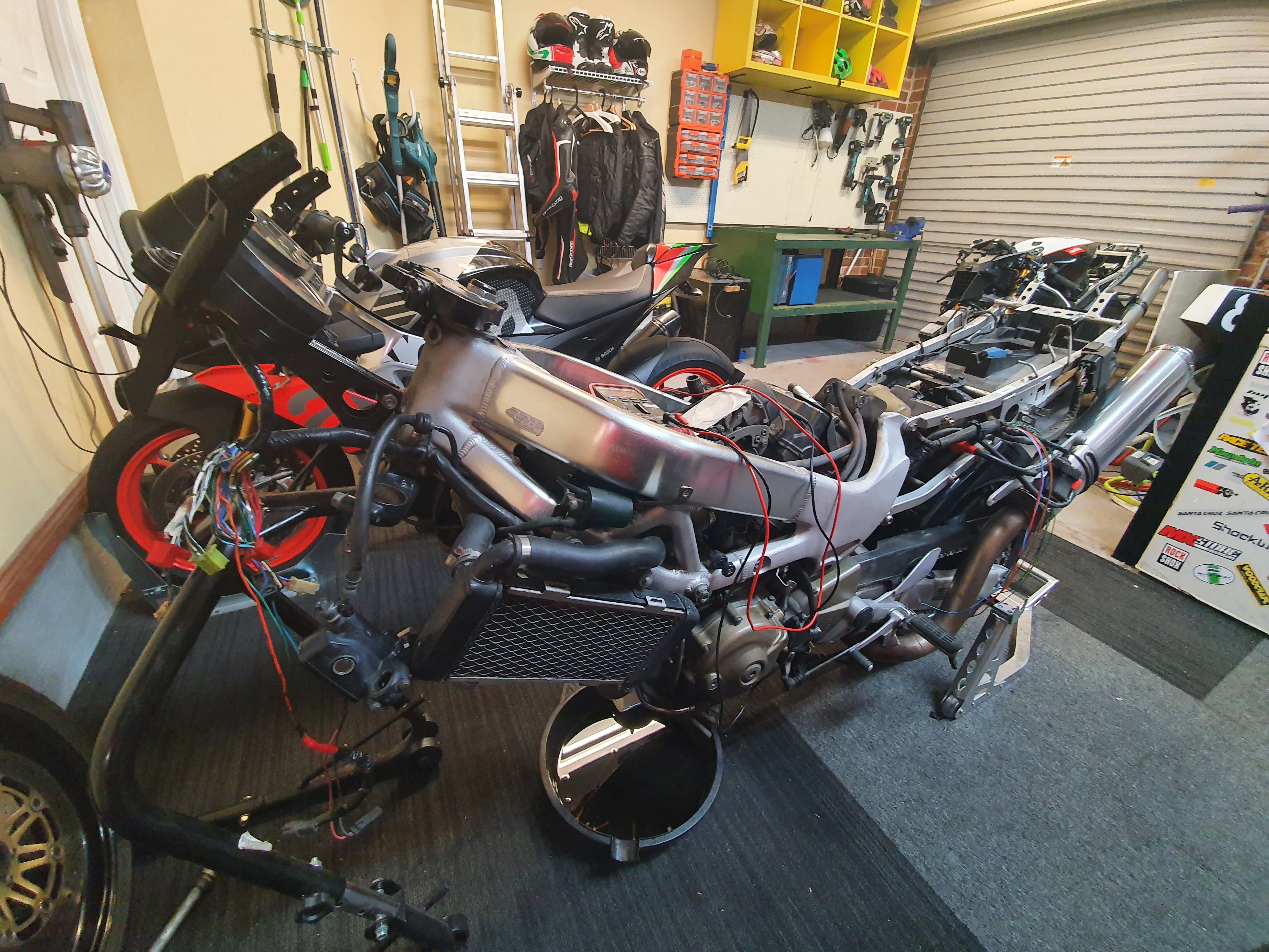

A few quick pics of progess.
Complete strip down, valve clearance check(and adjustment) along with some MCCTs.
Ordered heaps of parts (including rear sets 8O )
Waiting on shims to arrive, then I can start building the motor back up again and reframe.

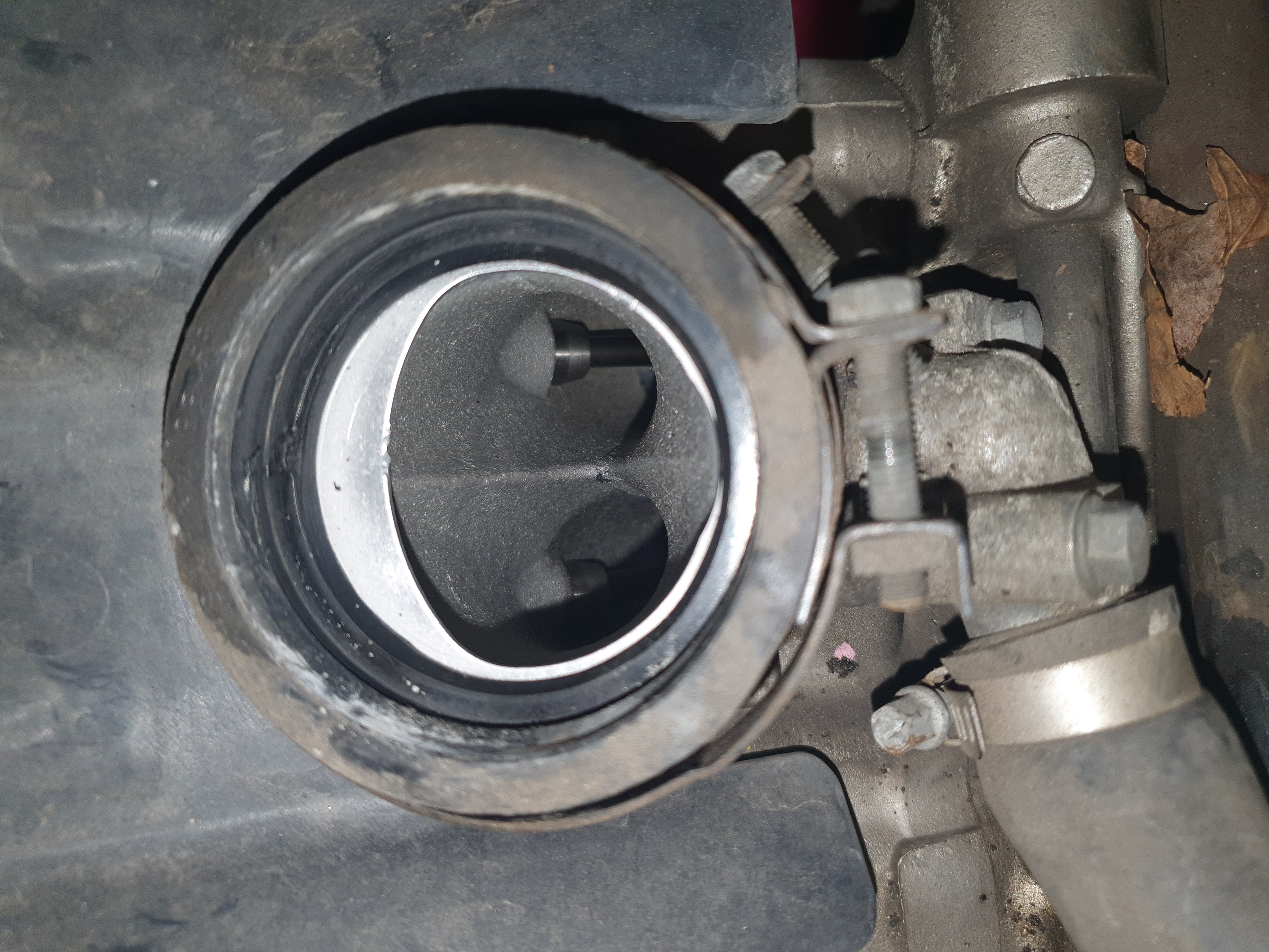

Found Honda's sneaky <100bhp restrictions that a pot of Aus market VTRs have. Dremel sorted this out.

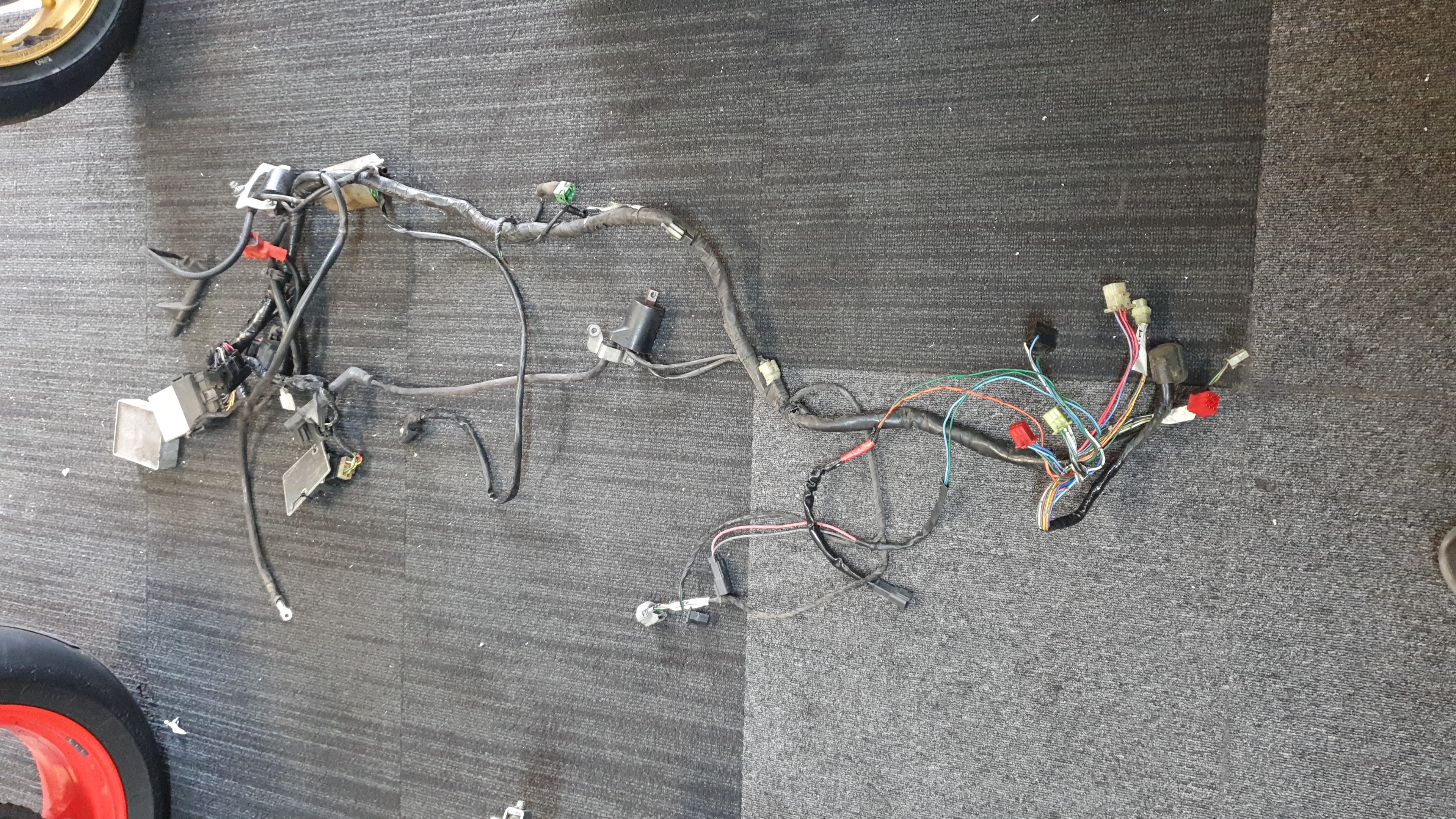

Loom is getting overhauled tonight, removing the junk that can be removed. Ill post some before and after once that's done.

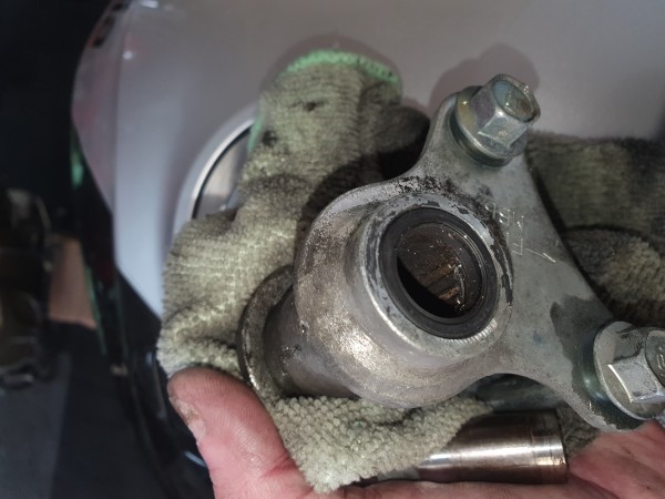

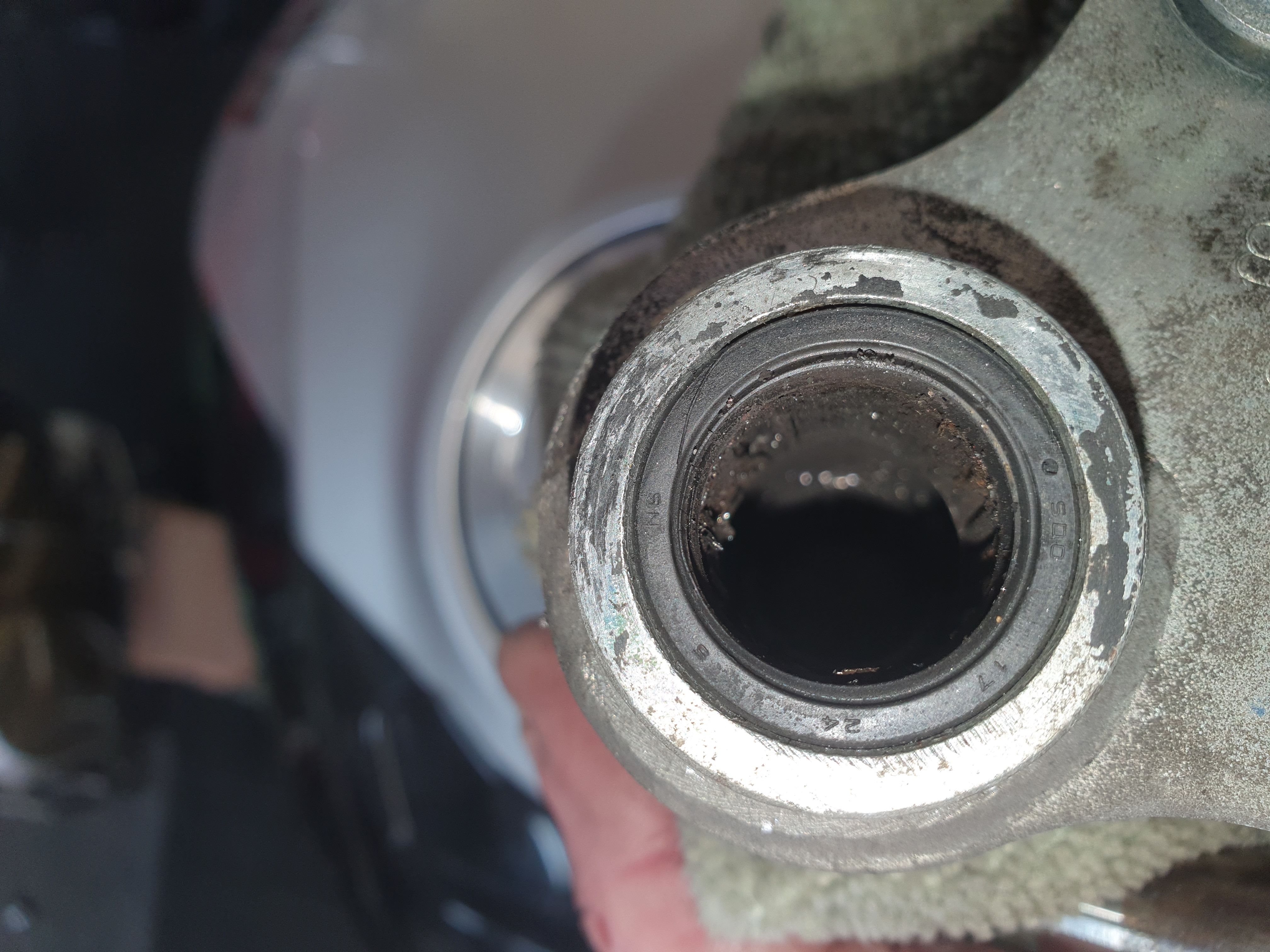

Swing arm linkage needle roller bearing are butchered. :thumbdown:

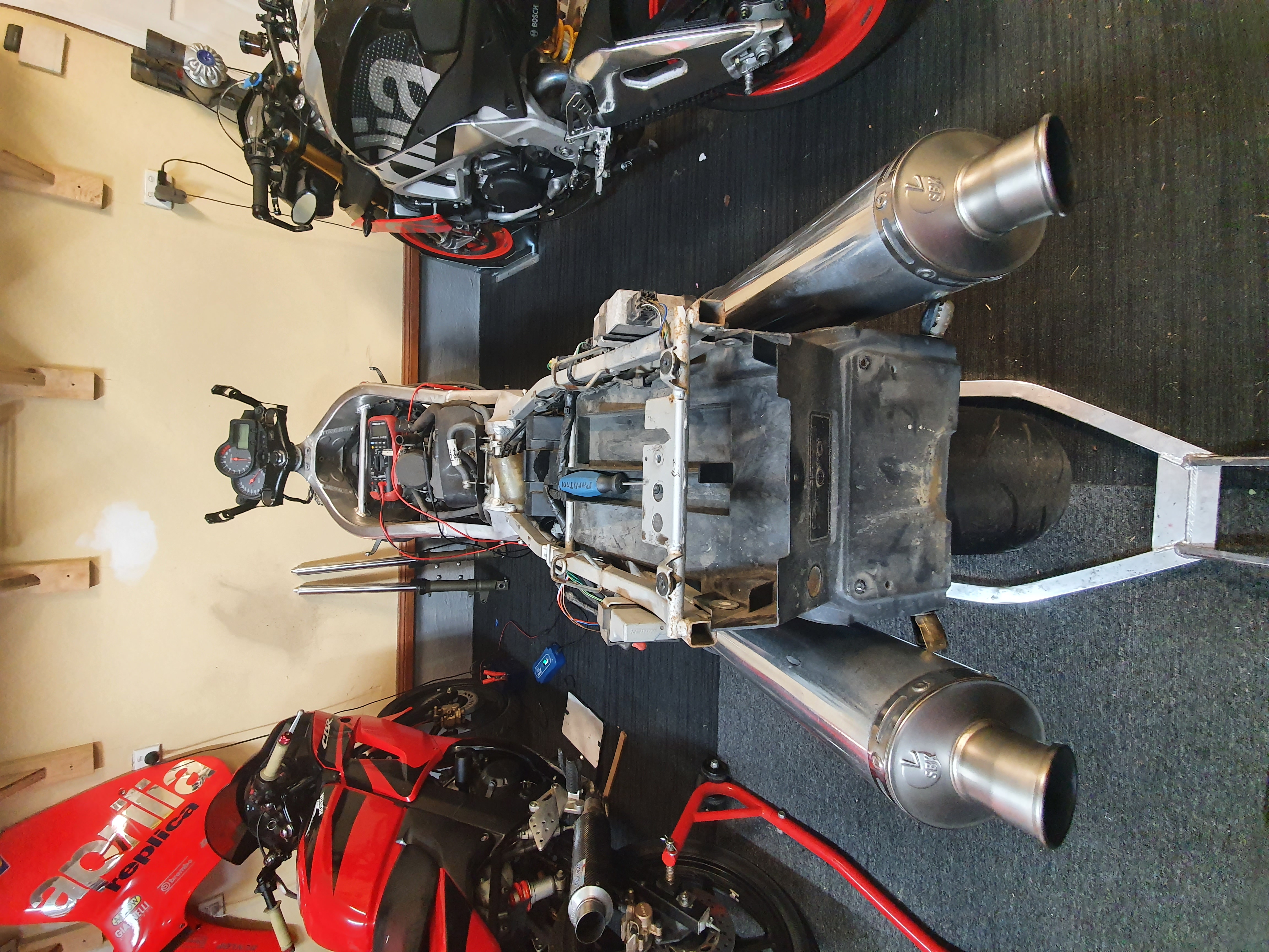

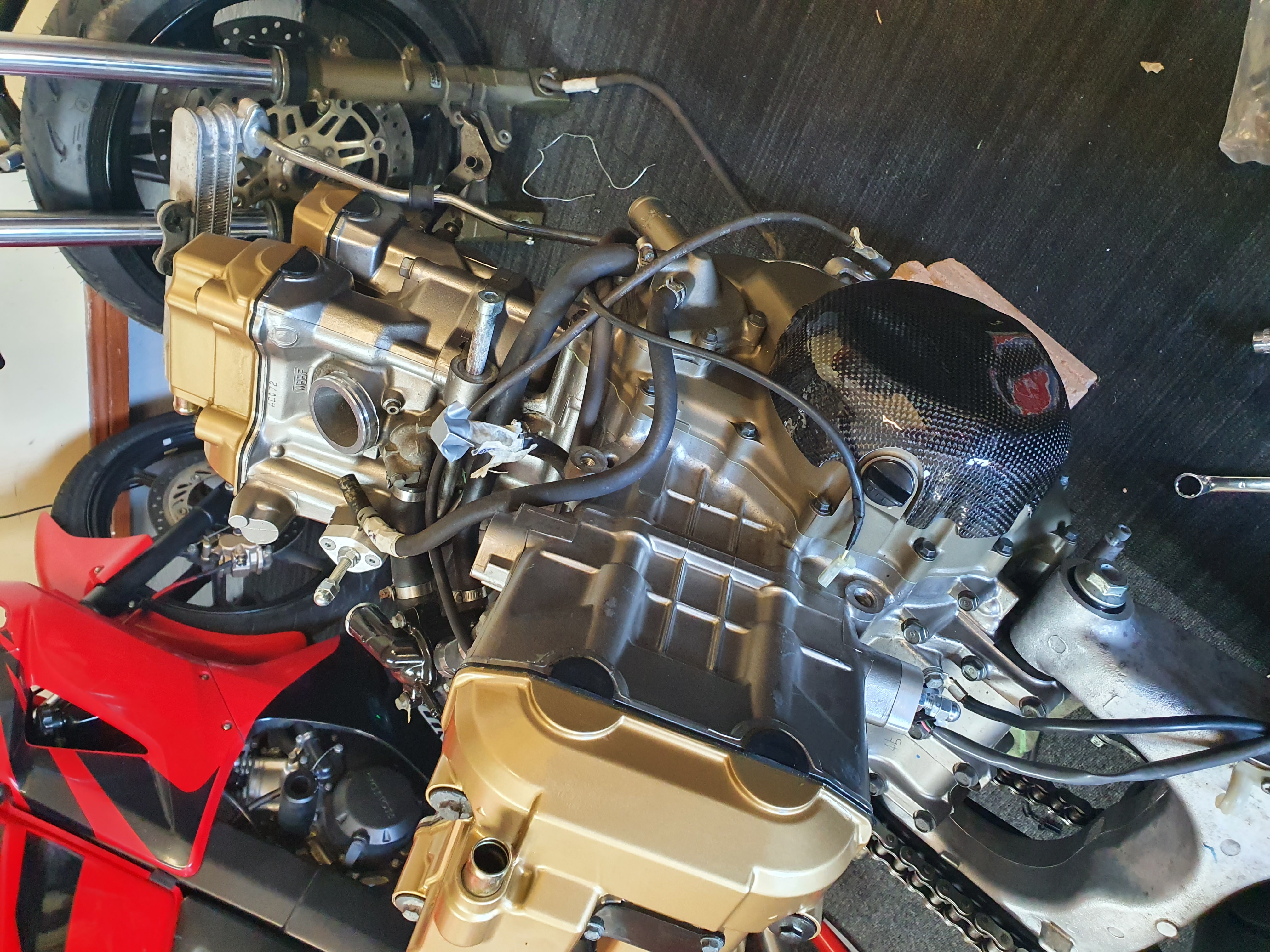

Frame has been tidied up, shims adjusted, rocker covers given a lack of high heat paint, loom stripped and its starting to be reassembled.
Still waiting on big ticket parts to arrive, most notably the rear shock and rearsets.
Silicone hoses are also enroute.
The subframe has been blasted and is ready to get adjusted to run the sensitive electrical on the inside for protection.
We've just been put on Covid lock down again, so should manage to get more work done over the next 2 weeks. :?
