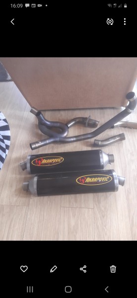

Well just to update this thread , i found a guy in france selling a full Akraprovic system, headers links and of course 2 huge akra cans. Its arrived today cant wait to get it on ,the whole system weighs apx 3 to 4 kg the cans feel like nothing they just about budge the scale to 1kg . Trying to put a pic up but its not happening.

Post by DJWALKER »
Re: Yoshi cans
I'm a bit biased but that system works very well....you just need to source some new stickers 8)

Sweet but thats just showing of pal , :D yes id like to find stickers. Have you run the bike on a dyno with the system.

Apparently the oem system weighs in at 4.5kg per can and pipes àpx 3kg apx 13kg total , i weighed this at 3 to 4 kg total i, thought the box was empty when it arrived haha

Haven't had the bike on the dyno with this system but I did need to drop the pilots down one size. While this might sound like you are loosing power it is just a quirk of these bike with the massive carbs. Speed up the airflow and the carbs become more efficient, so you need to drop the jetting. Much like running billet stacks where you end up dropping the mains one step. :thumbup:

You can have some fun by putting the system together off the bike and then ask someone to pick it up....the look on their face is priceless 8) :lol:
