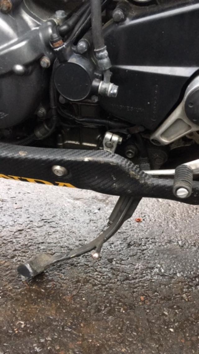

My kick stand is bent slight causing the bike to lean more then it would. The concern from my is that it will fail at some point and the bike will fall over. (like at a biker meet or something)
I would like to replace it, many exact replacements available on ebay but i also wonder if its going aftermarket and if so does anyone have any recommendations for one?
Picture in post below. the bike is on a paddock stand so straight.
Sorry if i made this in the wrong forum.
Thank you.

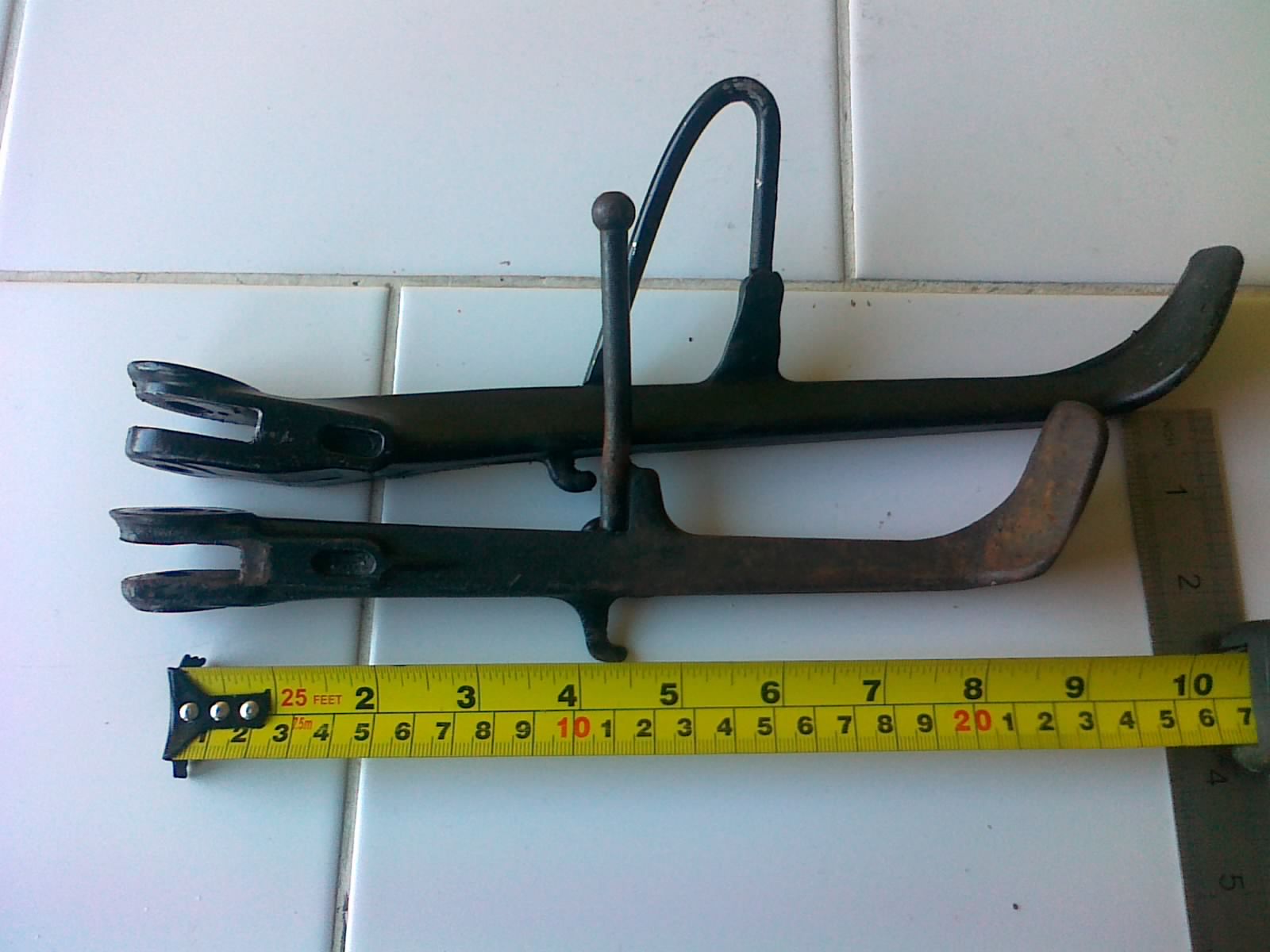

Honda Blackbird fits and is slighty longer.Some on here have fitted one,especially if the rear is raised with a spacer.
Re: Kick Stand
That not bent much.
Take it off, a bit of heat & a long bar/scaff pole should sort it out...
Do you have a shock spacer in ? As Alan said it will make the bike lean over more.
BB stand fits, but the prong is really short so needs a mod, weld a longer prong on...

I agree with Mac.
if you have a spacer fitted under the shock, then get a longer blackbird stand, if you dont have a spacer, some heat and brute force on the standard one.
even as normal the Storm leans over a fair bit on the side stand, so with a spacer it look very precarious
