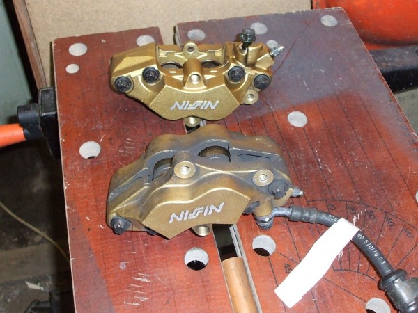

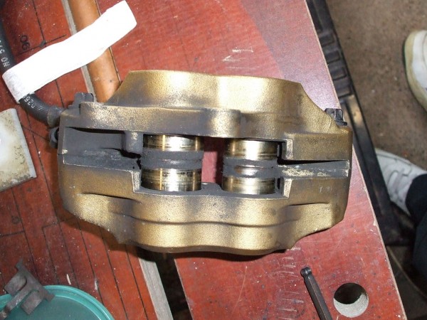

Ian, I haven't seen a video (or made one myself) but here are a few photo's of mine when I serviced them a while ago:
Pistons pumped out so they touch in centre of caliper more or less :wink:
The next two show brake cleaner is your friend.
One half of caliper (on the left) new seals, and pistons all fitted, the other half ready to fit seals and pistons.
I use red rubber grease on the seals for the pistons. Note two small joining seals in the caliper half on the right!

Thanks Chris, those pics really help, they give me almost everything I need to know.
I think that loosening the multipoint bolts while the calipers are still on the forks might be a good idea - they are probably pretty tight, and calipers are awkward things to hold. Same goes for final torqueing up. 32Nm according to the manual.
