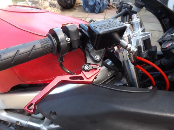

Just done one. I had an old set of fairings to trim & it depends on what bars you have & how much of a rise to how much you need to trim.
Bit of trail & error with lever postions & found it was fouling on the switch gear on full lock at the top & the starter & horn were touching the tank...
I have CRB600f4i callipers so getting a matching M/C, which is square & useing an adapter on the banjos sorted the angle of the bars therefore curing the starter/horn dilemma... Several bouts of dremlle action later...I trimed so its 3.5 cms down from the top of the fairing/bottom of the screen.
Get all the bit's together & if you come to mine I'll help you fit them...
