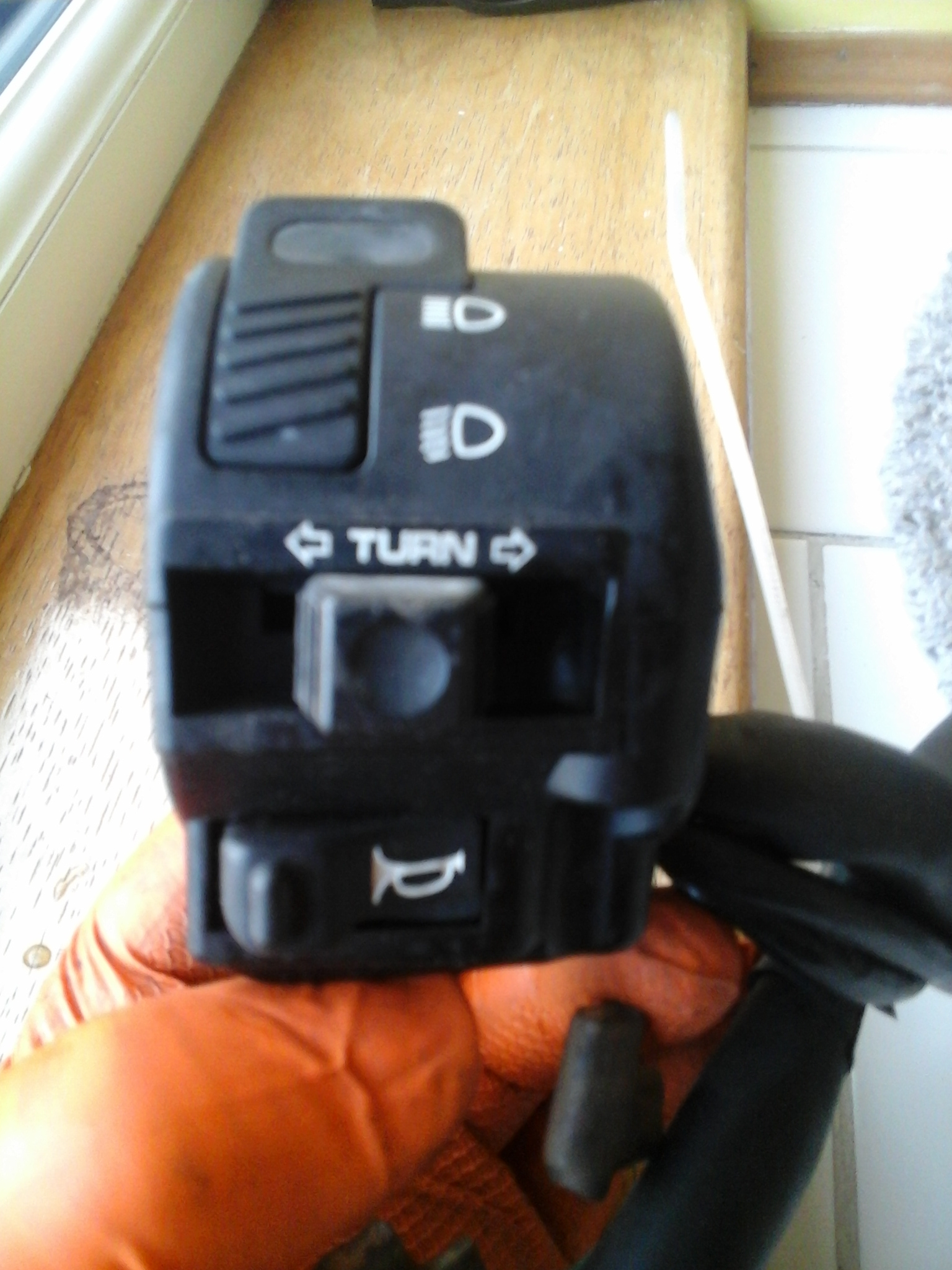

If your lefthand switch gear looks like this...
Your bike must be an import as there is just a rocker switch dipped on perm/full beam.
Some markets are required to run with dipped on perm.
Trust me I've looked & the plugs are diffrent so not plug & play...Thats not to say it cant be rewired.
Personaly I like a choice as well & my choice is to run with the the dipped on all the time, helps myopic drivers see you so a no brainer really...

What like this one...

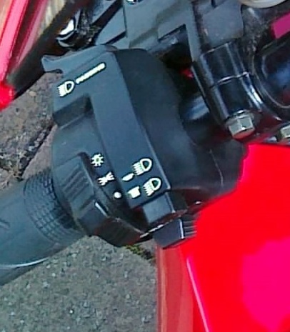

Here’s a picture of the light switch on my 03 F3 StormImage

Kev L wrote: Mon Dec 06, 2021 8:32 pm Here’s a picture of the light switch on my 03 F3 StormImage
OK well thats another different one then ! Weird ...much like the blob of hooman sitting on the bike... :wink:

bang on Kev L exactly like my bike blue 03 f3
i have original shipping order from brit shop and hpi both state non imported
my understanding is from a certain point in 2003 this was done for cheapness all bike across field ,lights on.
I am just going to get someone to put an inline switch in the wiring and mount it by the clocks until the i will leave as is
