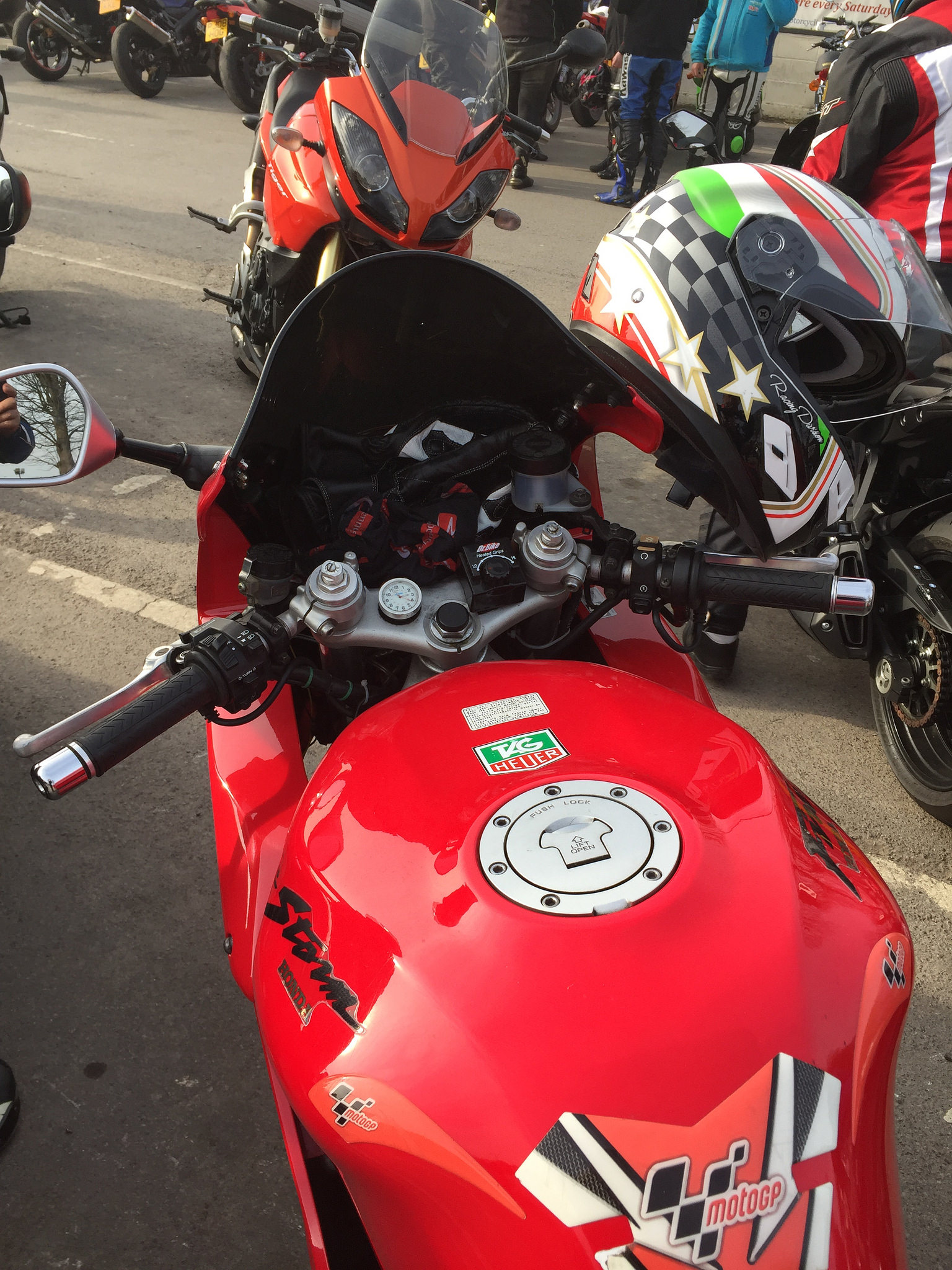

I don't feel up to,mechanically or financially,fitting the full Renthals so .......
Thinking of fitting these
https://moto-cnc.com/honda-bar-risers-firestorm-vtr1000
They need forks to be 41mm;my vtr is 2001/2;would they be 41mm or how can I find out?
There's a vfr750 handlebar swap;would these fit my forks and could they be combined with the risers?
I've previously had mechanics bend bar with a scaffold pole;could the present standard bars be bent slightly upwards!? :D
Has anyone fitted these or similar?
https://www.sportsbikeshop.co.uk/motorc ... rod/356552
My clutch wrist is killing me unfortunately.
Maybe slightly lower footpegs/slightly higher bars would help.

here is the easy way.. get a set of VFR 750 bars (check its the 41mm model,later bikes had 43) job done, totally transforms the riding postion.
option 2. again check they are 41mm, they may have changed in later years, fit Suzuki SV 650 bars.. not just as high as the VFR bars but a good halfway house between them and storm bars :thumbup:
option 3. later facelift storm bars, they are generally black instead of earlier silver, they arnt a lot higher but sweep down less.

Just to confirm, Firestorm standard forks are 41mm in diameter for all years.
Another option for you to think about :wink:
I have not tried this myself, but I have seen on here standard Storm handlebars turned upside down, it would definitely give you an upturned angle, take a look:
