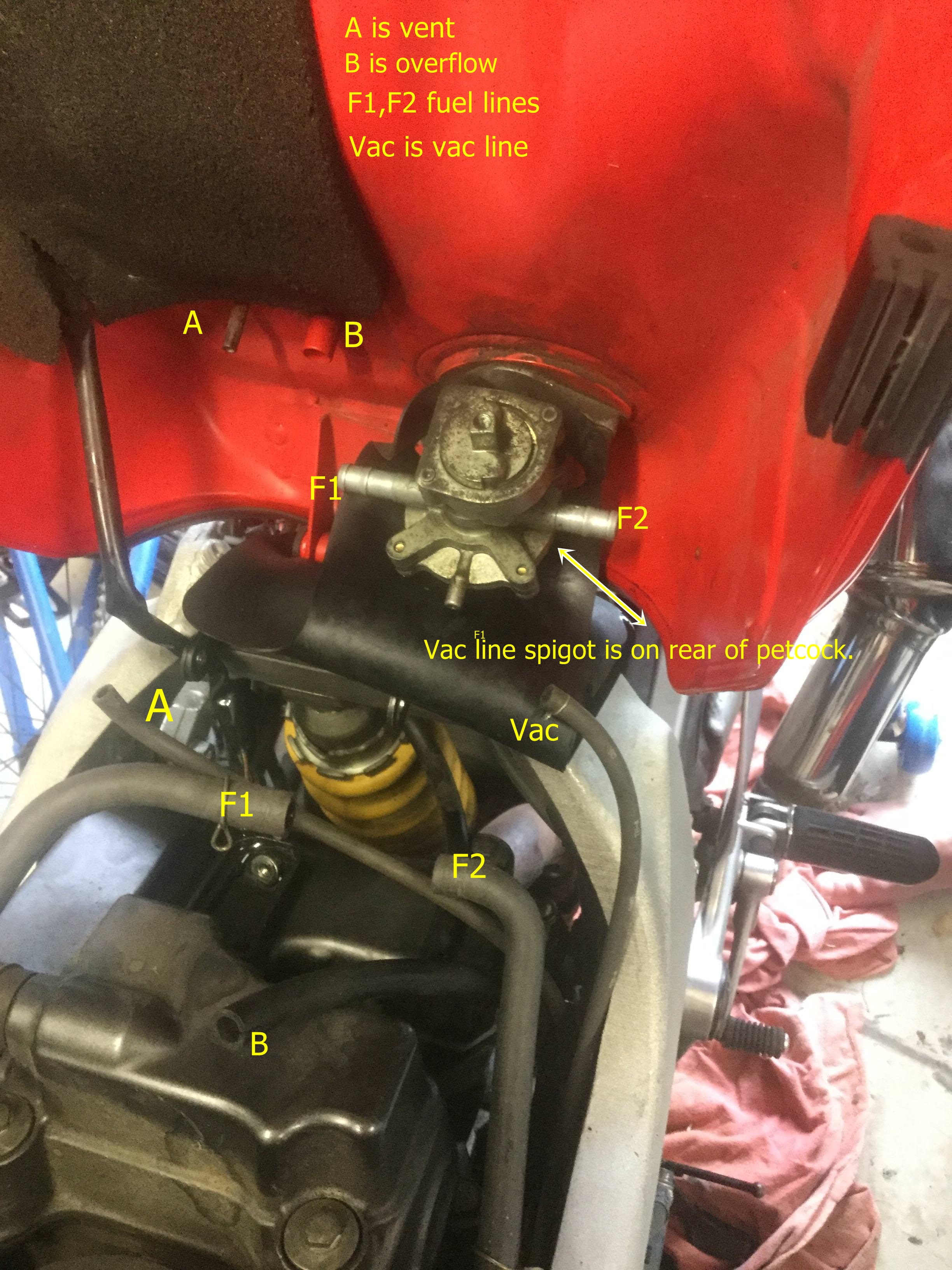

Did you take the tank off?
Sounds like you have the vacuum line on the wrong petcock spigot.
It should be on the 9 o'clock one, not the vertically down one, that stays with nothing connected.

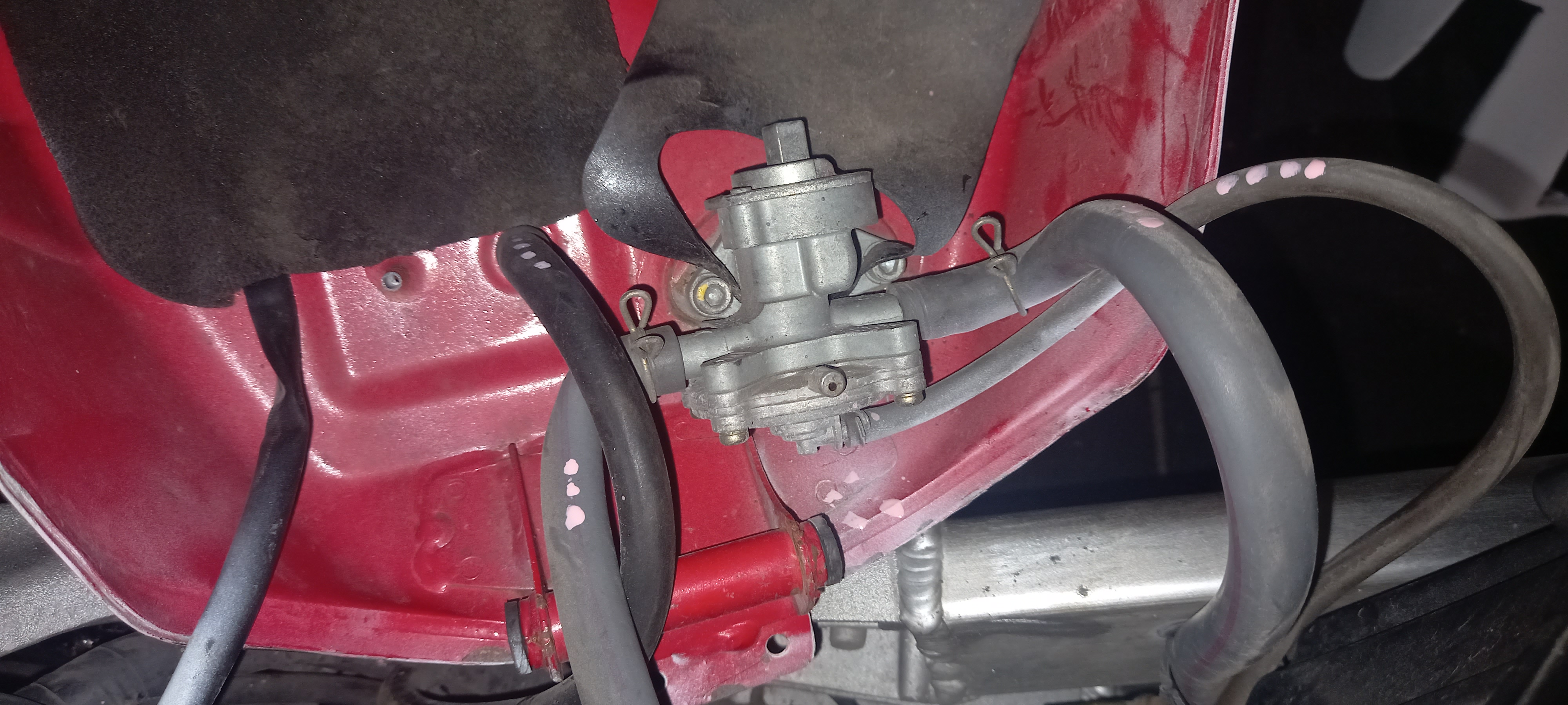

Yes tank was removed. Took pictures and marked the pipes. Ill double check them when i get home. Might have them wrongly connected. Cause while shes idling and i open the throttle quickly nothing happens. After a second or too she will just die.

Thats how it was connected before removing.
Re: Running problem
Your picture is correct.
Because the vac line also fits on the lower stub and from the angle you look at it, it's the only one you see, it's easy to mis-connect.
The fuel connecting hose on the right in your pic doesn't have the clip in the right place, though.

Check the vac pipe again. Looks ok TBH. You didnt turn the petcock off did you & forget to turn it back on...?
But it looks like you dont have a tank breather pipe conected...
'A' in the pic. If thats blocked you will get an air lock in the tank.
Pop the tank open & if you hear a rush of air thats your issue...
You can get an air line onto that & blow it through...

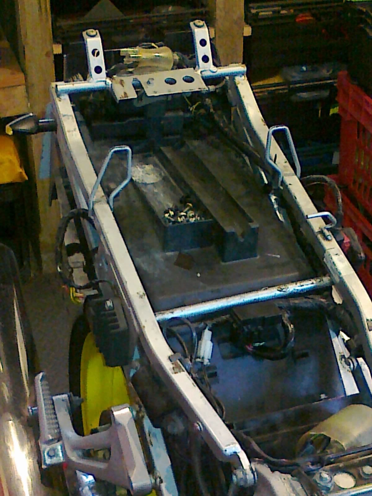

Can you post a pic of this 'Round thing' on the subframe please... Sounds like from what you say it's the coil for the rear pot, that would be the only round thing in that area...

The round thing is on the right hand side of the subframe. Rec is more to the back. Round is situated about 10cm to the front from the rec.
Re: Running problem
Johannvw10.ZA wrote: Mon Apr 11, 2022 8:59 am The round thing is on the right hand side of the subframe. Rec is more to the back. Round is situated about 10cm to the front from the rec.
Thats a bit of a crap pic can't really see it clearly...
Looks like its the coil though...

Yes thats the one. The coil. Ill check tank hoses and all connections again. How would i go about eliminating the coil as a cause of my problems.
