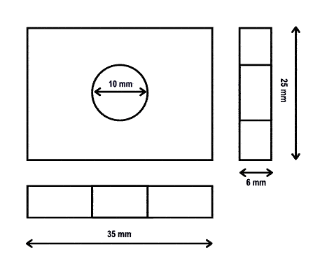

Yes they do but only go max 6mm... & dont buy them make them...
Shock spacer.gif (4.54 KiB) Viewed 3068 times
No ally plate to hand, steel will do just heavier & harder to cut.
Or just use washers, still cut the groove easier to fit...
Tank off, loosen the shock top bolt...DO NOT REMOVE!
Get the rear of the bike up so the shock drops down. Either lift by the sub frame if solo or if you have a helper tip up on the side stand... If the shock does not drop down a gentle tap to help it...
The spacer fits inbetween the the top of the shock bracket & the frame crossmember.... NOT under the nut !
Put the spacer in so the open end is facing towards the rear.
Lower the bike, tighten up the shock top nut to correct torque setting...Jobs a good un.

Knock them up out of 2mm thick ally plate, then you can try one only = 2mm, two together = 4mm then three together = 6mm,

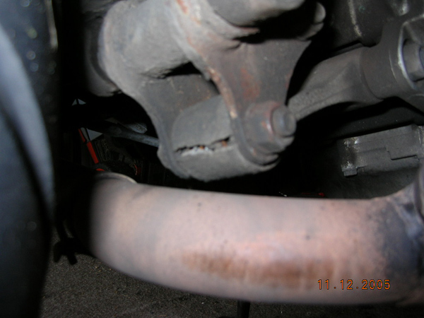

Make the shock linkage check a priority... If its never been done it will need a seeing to even if it's just a regrease... Fine waiting to winter untill it seizes up on you before then...
Rear linkage split.jpg (103.64 KiB) Viewed 3017 times
Not mine but I know of two that have gone this way & I've seen plenty where the main conection of the triangle to the swingarm is seized solid...
