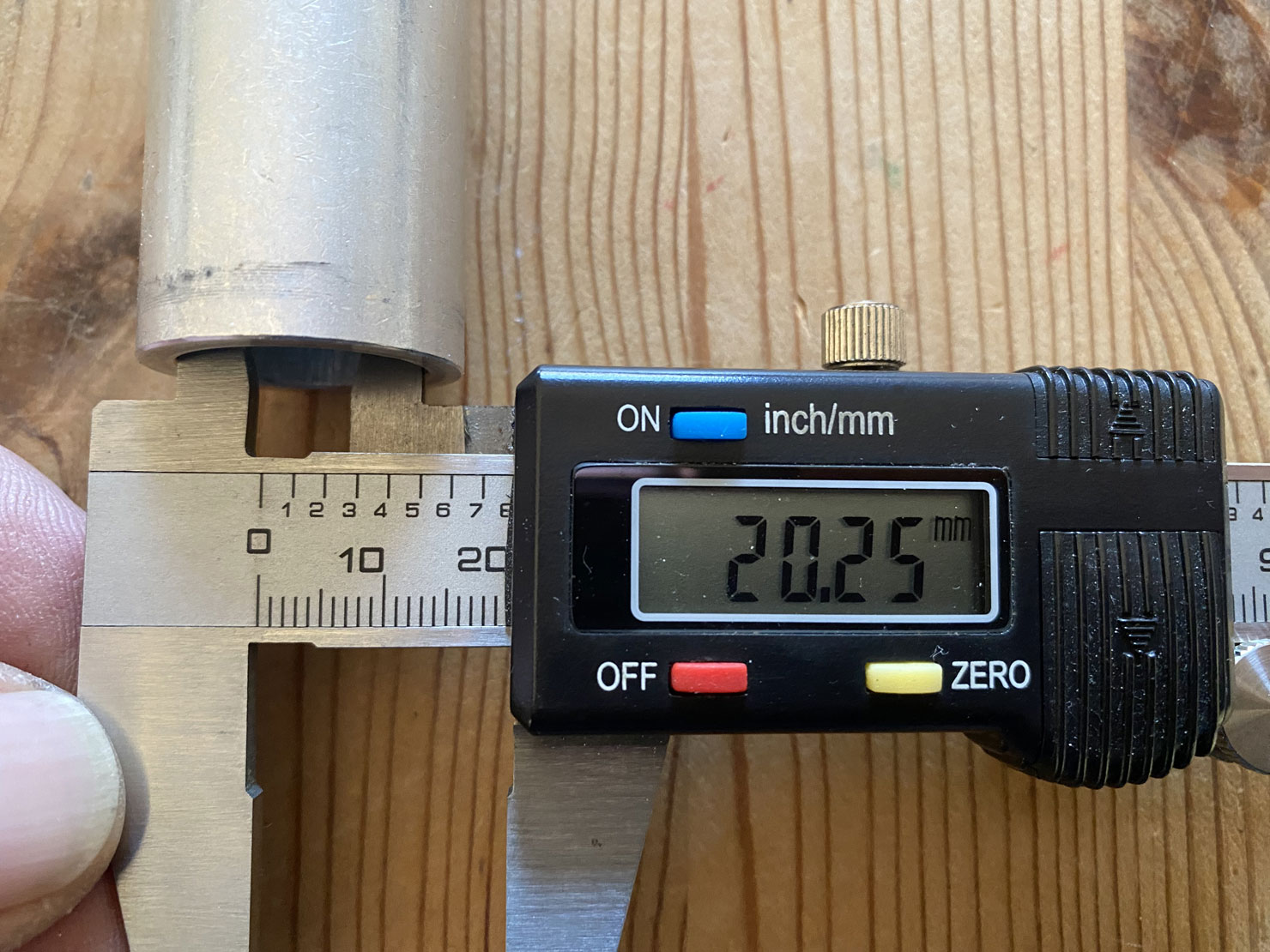

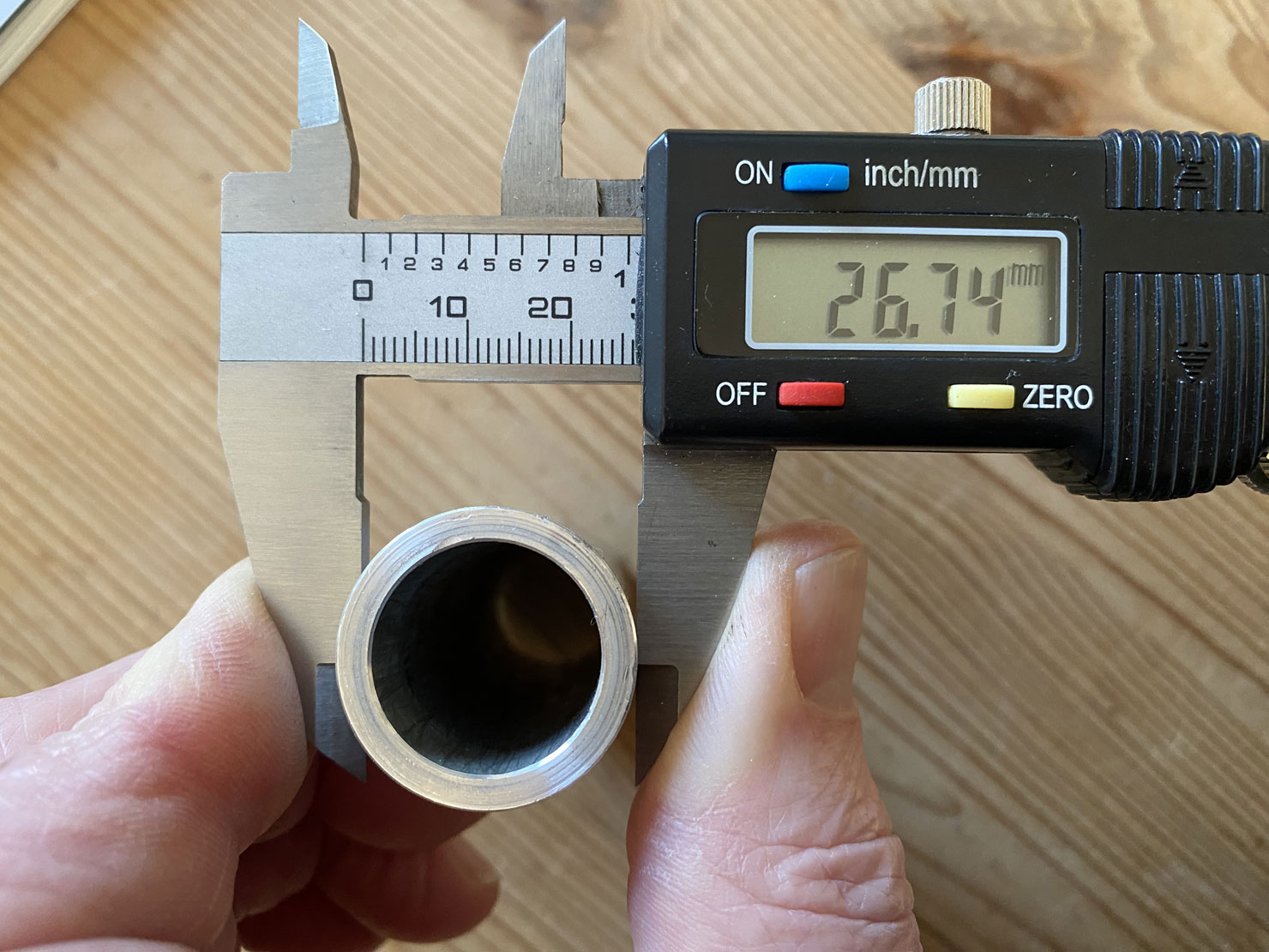

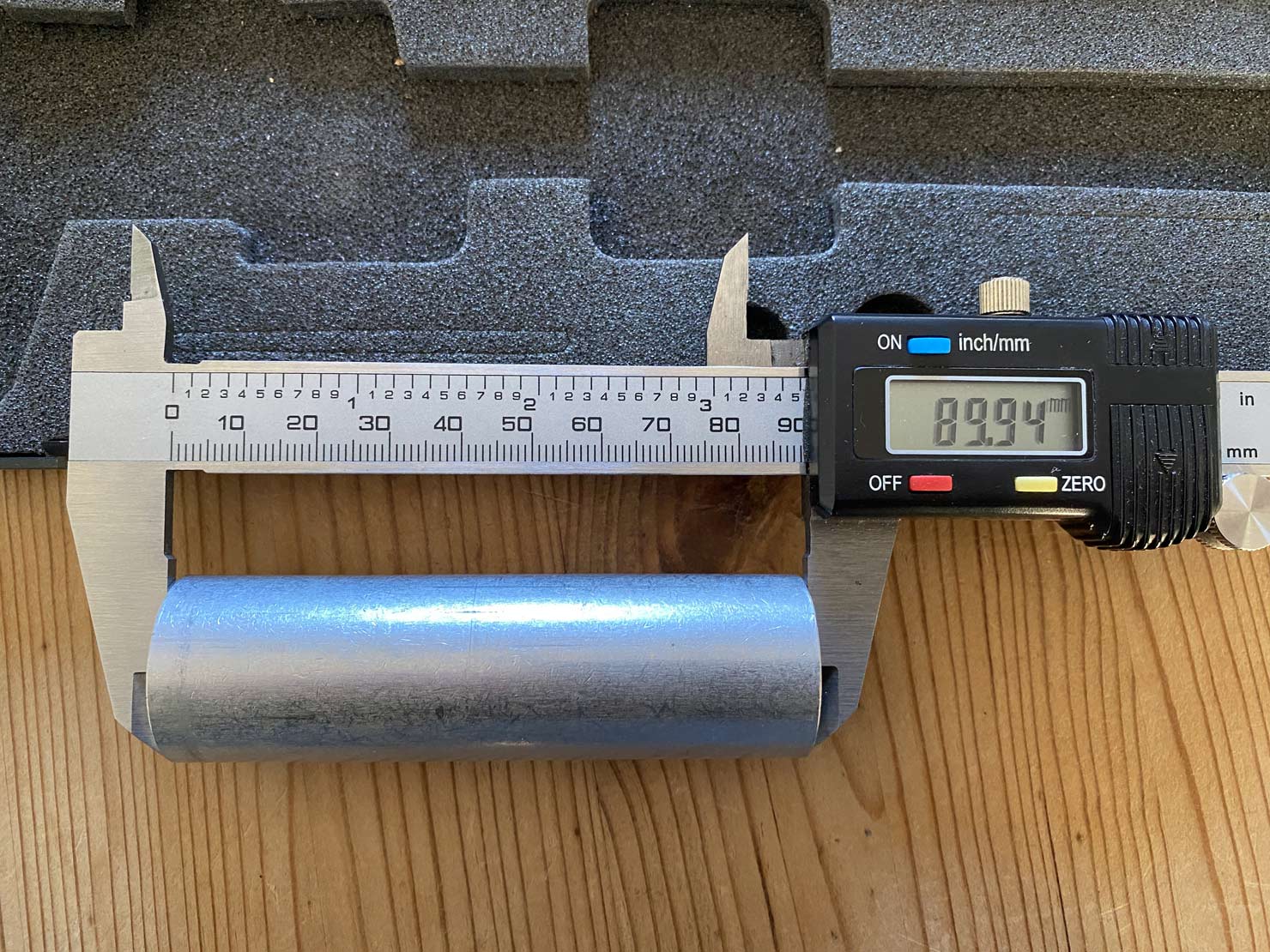

They must be all alloy as that is what this one is made from too, definitely not mild steel/steel.
HTH's Nick:
I know you only asked for the length, but I have given all the dimensions so you can check them as well for piece of mind,

Mine measures exactly the same so I'll see what happens when it goes back together.

All I can say is, the front wheel I took that bearing spacer out of is the original wheel that came fitted to the bike when I purchased it, it was 21mths old back then. So I would expect it to be the original OEM wheel, but obviously I can't prove that 100%.
The fact though the dimensions from both spacer match, plus they are both alloy is a very good sign I would say,
