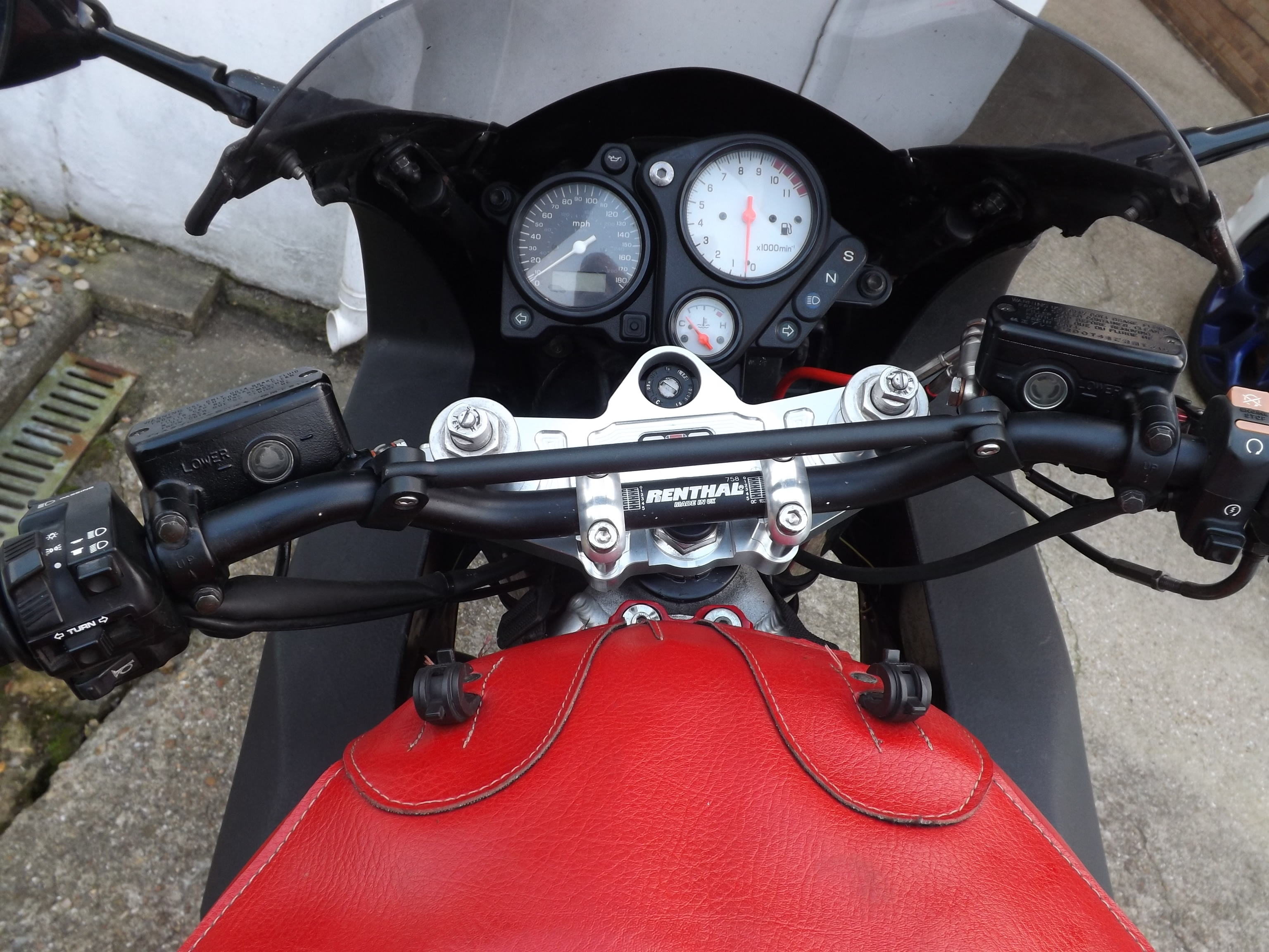

You can have a read of what I did to my Firestorm when I fitted Renthal Ultra low handlebars, although I have kept the fairing and headlamp etc, but you may still find some useful information:
viewtopic.php?f=31&t=41099&p=447870

Keep the fairing. Any straight bar set up will fit with minor trimming.
I uesd an CnC yoke, Renthal bars & CBR f4i masters. I have CBR f4i callipers on my one so the masters needed changing anyway.
Just trimmed the fairing to take the 'ears' off to clear the masters. As for the mirrors I have extenders on the OEM mirrors.
If you go with the flat bars you'll need less trimming & might be able to use the std m/c's.
As it happens I have a ABM kit that could be for sale. New from ABM they are 329 euros prob + shipping & import duties.
ABM kits are a plate that goes over the the std Yoke so you dont replace the top yoke like the CnC one...So you dont need to change the ignition over.
These bars have quite a bit of rise to them & are wider than the Rentals I use. there are some bar end mirrors with them as well.
