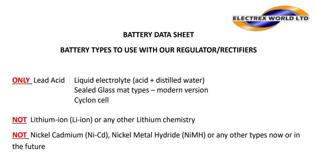

There is also a pretty expensive job online made by Electrex see screen grab. Again, you guys might have heard of these. This is my last question on this, promise, just don'twant to make an expensive mistake!

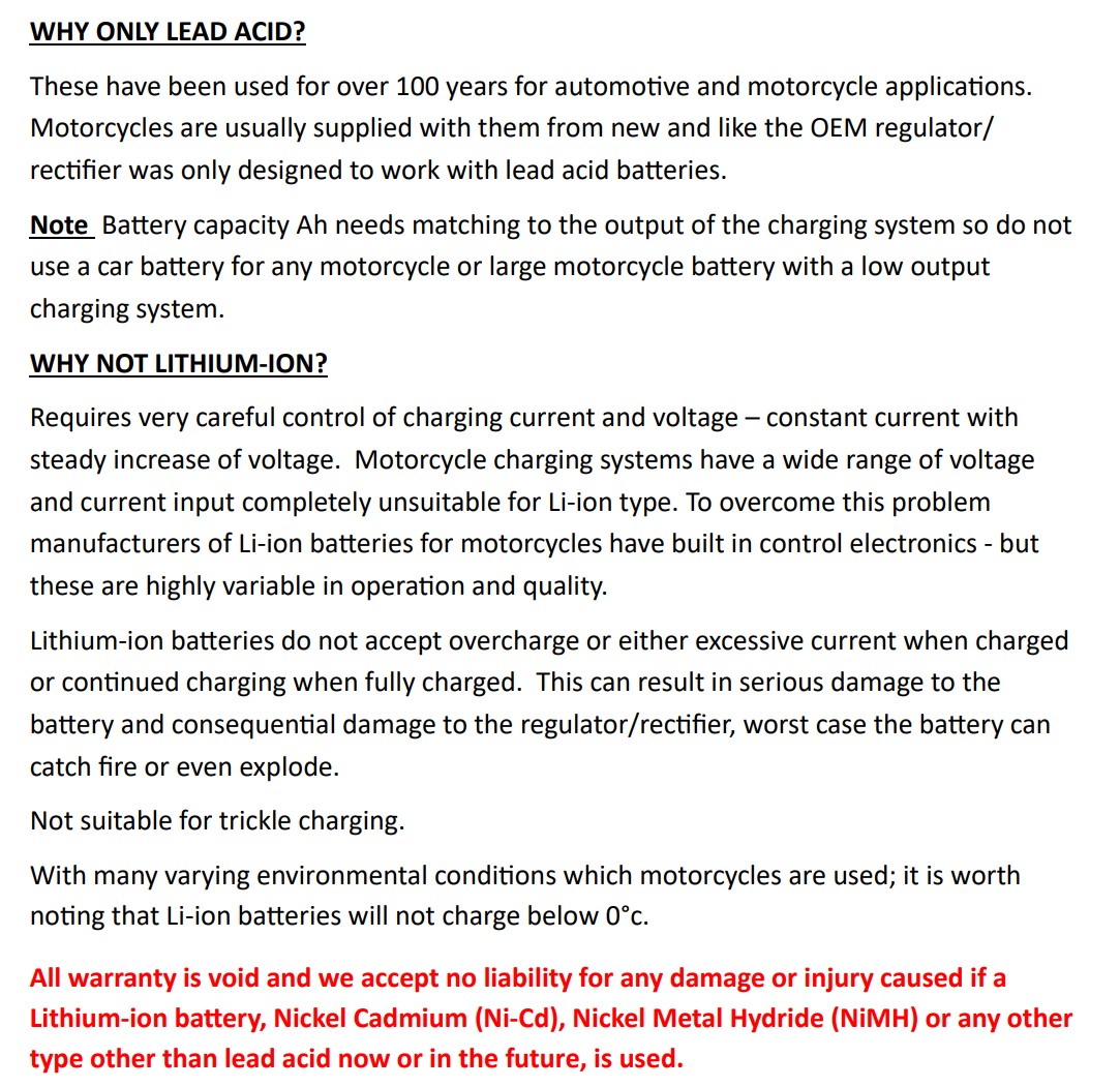

I see Electrex say Li-ion batteries are not suitable to use with their rectifier's :problem:

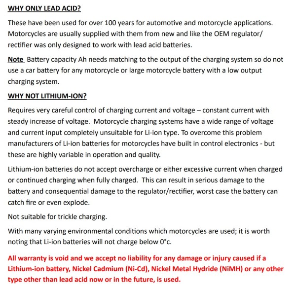

I was just surprised to see that, as I don't think anyone on here has ever mentioned that when they have upgraded to a Li-ion battery.
I thought it worth pointing out in case you were intending to upgrade to such a battery later on.
Quote from Electrex site:

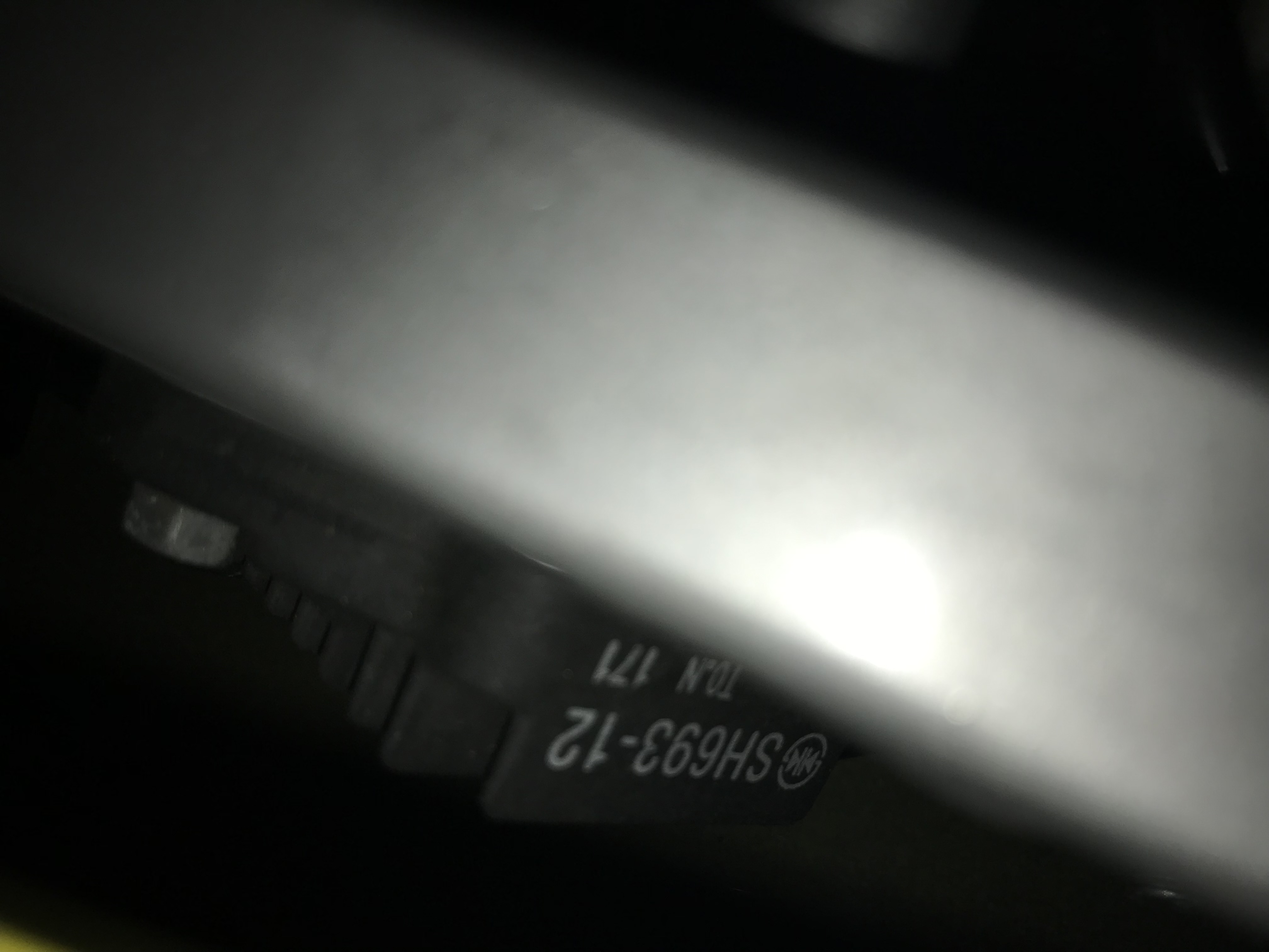

I took a photo of the one fitted mine at the moment- I see at least it is finned, probably becuase it is the newer series 2 version from 2001 - would the serial number tell anyone if it was the original Honda or not?
Number on it is SH693-12 and under that T0.N 171

Stew1000 wrote: Tue Feb 28, 2023 9:16 pm Thanks again - I think you're right about these replacements, must check any replacement is Shindegen then, everyone on the forum seems to recommend this.
Might help if I'd done this earlier!
I'm pretty sure the SH693-12 is a OEM Honda rectifier/regulator. As it's finned it's better than non-finned, but not a good as a MOSFET,
