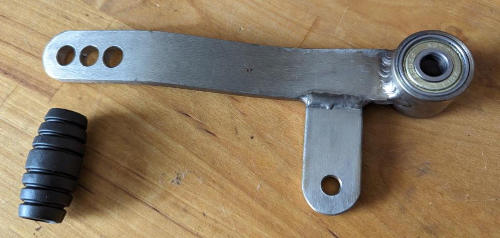

In case anyone fancies a stainless DIY shift lever with roller bearings, the BOM contains
- 2 bearings 22x8x7 from Inliner rollers.
- 30x2 stainless tube
- 20x5 stainless flat bar

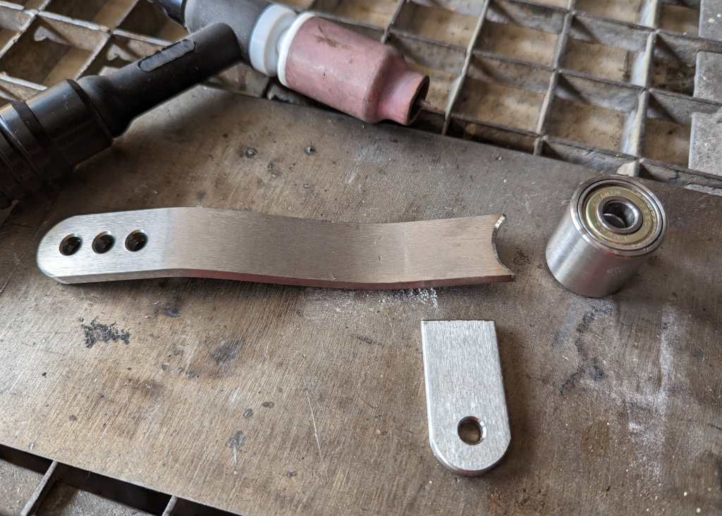

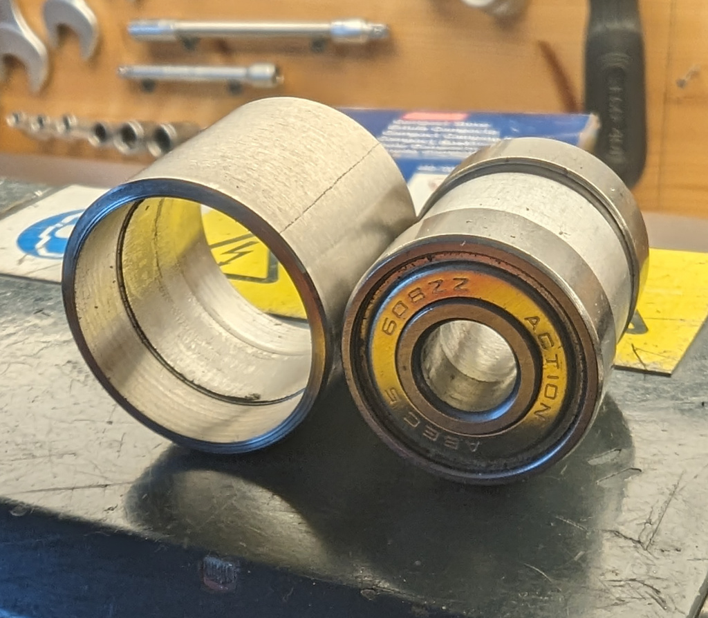

Use a small lathe to manufacture the bearing seating surface in the tube and a spacer in between.
Cut, bend and weld the rest.
Bye

What does it weigh, compared to the original?
MK_WF
Posts: 148
Re: DIY shift lever
Post by MK_WF »
Haven't put it on a scale, but it's certainly heavier considering it's made from stainless steel instead of aluminum.
Also considering we're not talking about a Moto 3 high end competition bike and the usual VTR rider is kinda "plus sized", these 100g certainly won't affect riding performance...
At the end nobody said it has to be steel. You could always switch to aluminum, if your welder supports that option.
In this case I'd use thicker material though.
Bye
Martin

Great work!
Is the function better with the roller bearing?
Maybe more precise than the original shift lever?
:thumbup: Twinfreak
Re: DIY shift lever
At this age most of the originals must be a tad slack :D
Re: DIY shift lever
I like the idea, well done :thumbup: :thumbup:

twinfreak wrote: Mon Aug 28, 2023 11:28 am Is the function better with the roller bearing?
Yep, less slack yields to more precise shift operation.
