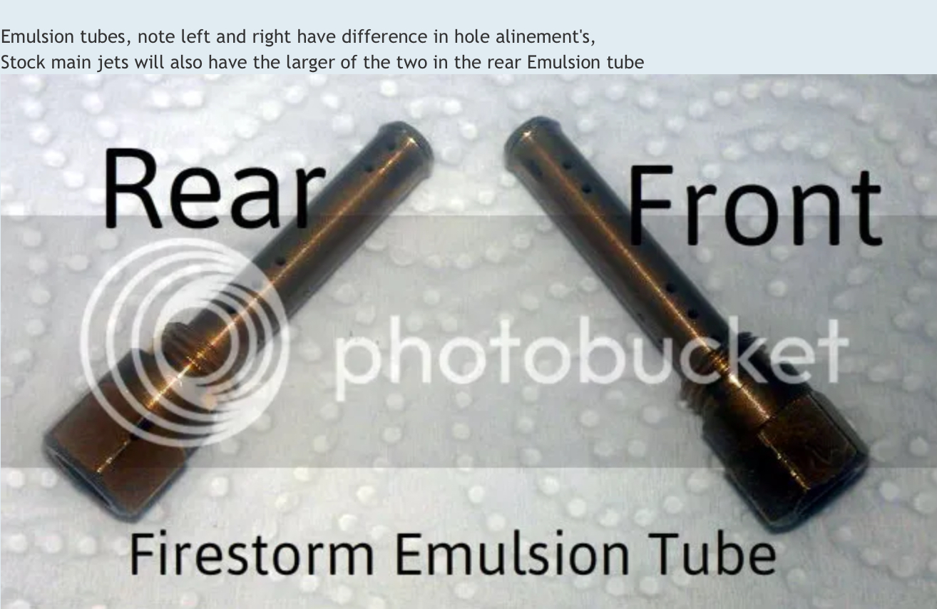

I have a 170 and a 172 by the looks of it. Very hard to see.
Also the main jet tubes are slightly different hole patterns. Same layout and number of holes, just moved along the tube. See pic.
Can someone point me in the right direction of which goes with which and where? I’m assuming that the 172 is a slightly bigger opening and would go on the rear to run it richer, but which tube/pattern does it screw on and if you can explain why that would be much appreciated.

The ones in your picture are the pilot jets, not the main jets.
They definitely aren't 170 and 172!
Those ones should either be 40 or 45 or something like that.

These ARE the main jets. They have a threaded part which goes in the top, which are marked 170 & 172.
The pilot jets are much smaller and both marked 45.

This is the link for you, see photo 21 ish down I think from the top: https://www.vtr1000.org/phpBB3/viewtopi ... rb#p214521

Awesome, thanks Chris. That’s solved it. So the tube that houses the main jet is actually called the emulsion tube. The rear one has the higher number jet as std and the holes furthest from the thread.

Donut 77 wrote: Tue Sep 19, 2023 3:47 pm Awesome, thanks Chris. That’s solved it. So the tube that houses the main jet is actually called the emulsion tube. The rear one has the higher number as std and the holes furthest from the thread.
Good man 👍
That's how I understand it :thumbup:
Normally going on it's good practice to keep all the parts from the front carb in a pot of it's own, and the same for the rear carb, also marking each pot before you start stripping the carbs down,

Yes, I do try to. The issue with this bike is that I had to buy a second pair of carbs, and on both sets the previous owners have put things wherever they felt like, so I don’t always trust my starting point. The emulsion tubes were the wrong way around. So were the velocity stacks in the airbox. I basically don’t trust anything now.

I remembered someone posting up a photo of the difference between front and rear emulsion tubes, I just had to remember where, although in the end it came to me who did that, so that narrowed it down a bit.
