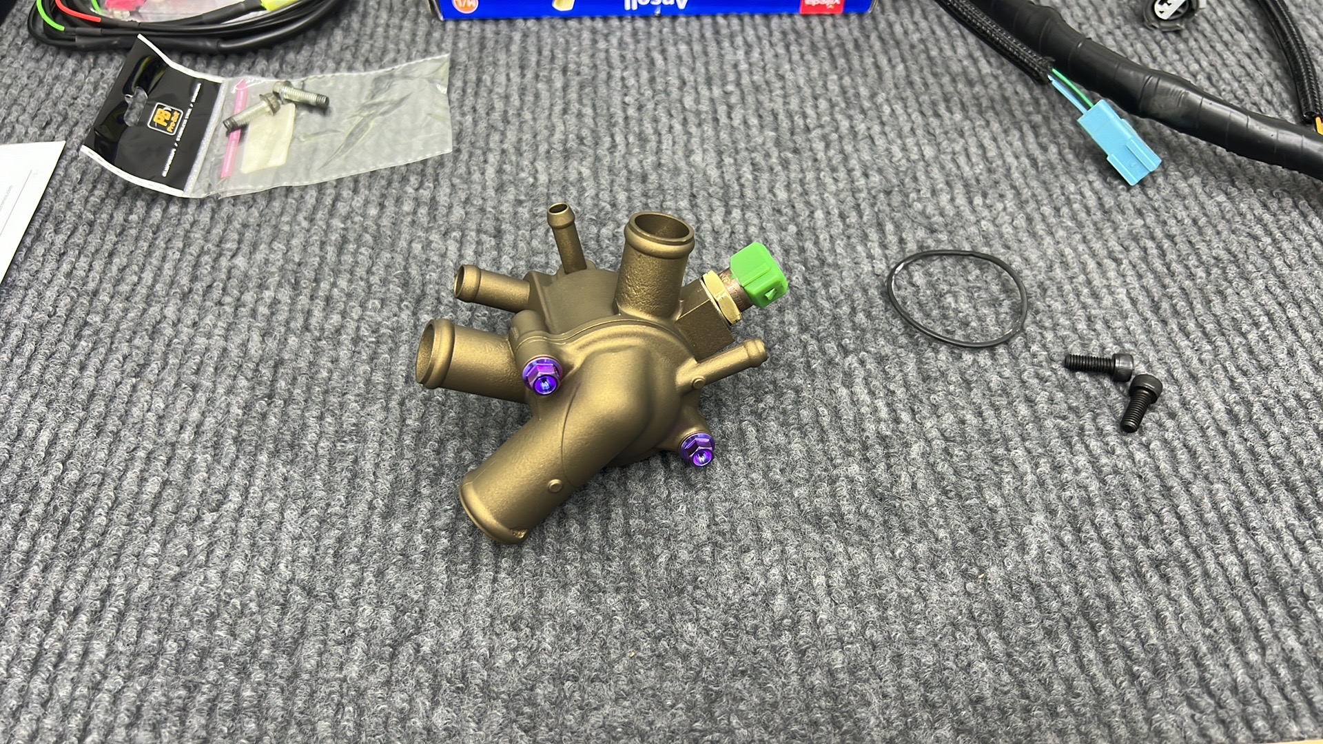

Well, it’s been slow going but this is the way of things. The engine has been completely stripped, bead blasted and I’ll Cerakote the cases in the next few days. There’s a brand new set of JE hi-comp pistons waiting to go in and all going well, I should start putting the engine back together in the next couple of weeks. Unfortunately the EBC SRK clutch kit that I’ve ordered is on back order and is apparently about 2 months away.
While I’ve been waiting for progress on the engine I’ve got a bunch of parts blasted and Cerakoted, some fasteners plated and the wiring harness has been stripped, cleaned, checked and is in the process of being rewrapped. Lastly, I ordered a Matris M46K rear shock and F15K hydraulic cartridge kit today so there’s more bling on the way.

I was with you all the way, up to the purple anodised bolts....
