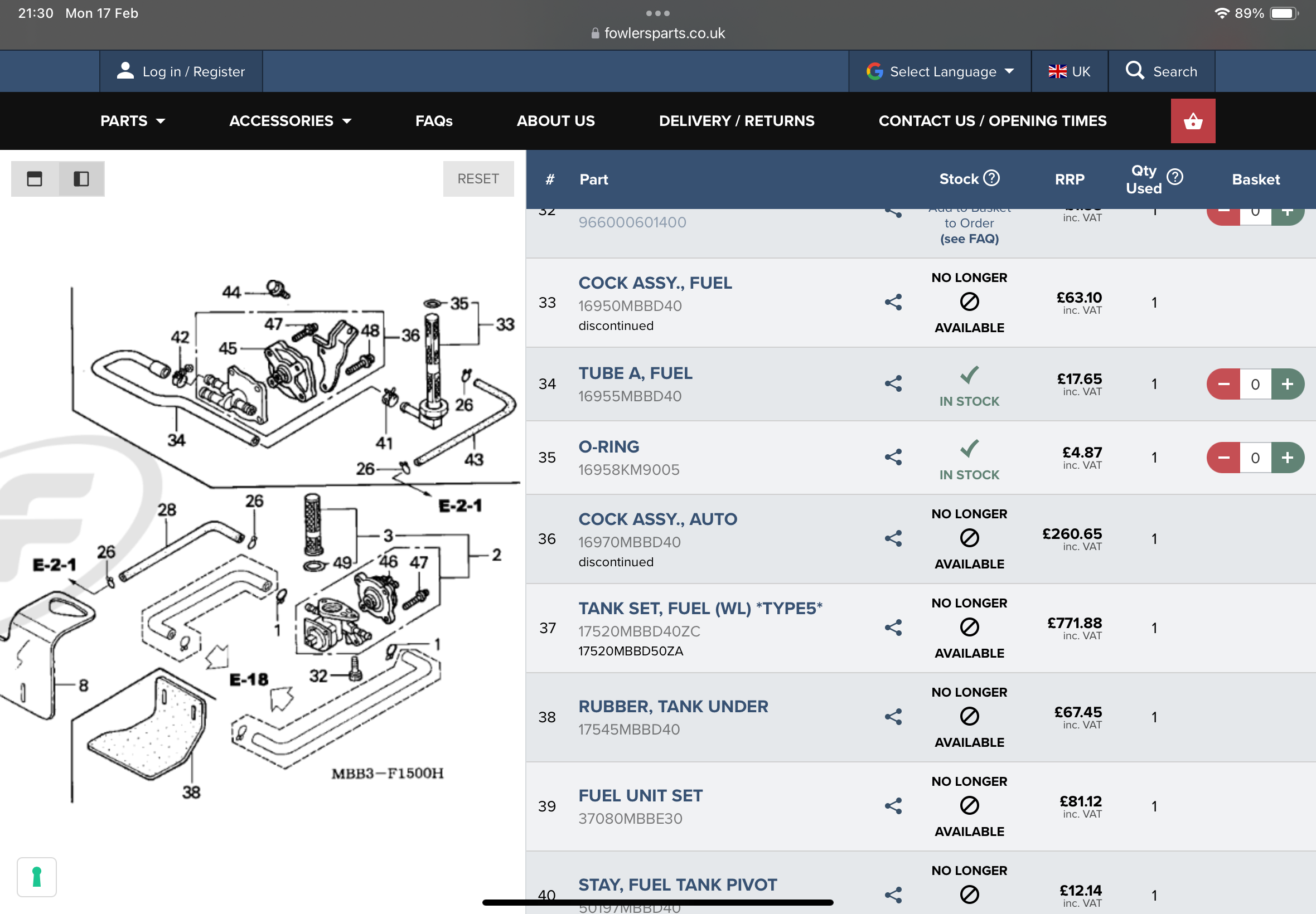

Jack, It looks like there should be an O ring fitted like you mentioned (No35 as below possibly),

Perfect thanks Chris, will try it with an o ring but in the meantime have ordered a CBR900 fuel tap as apparently this bolts straight on. One way or another hopefully this will fix it.
