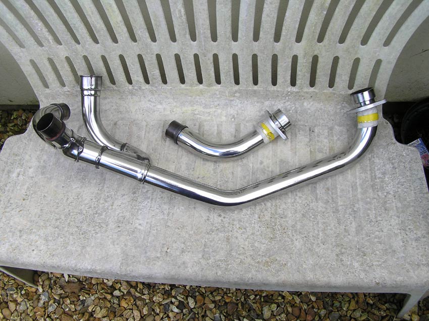

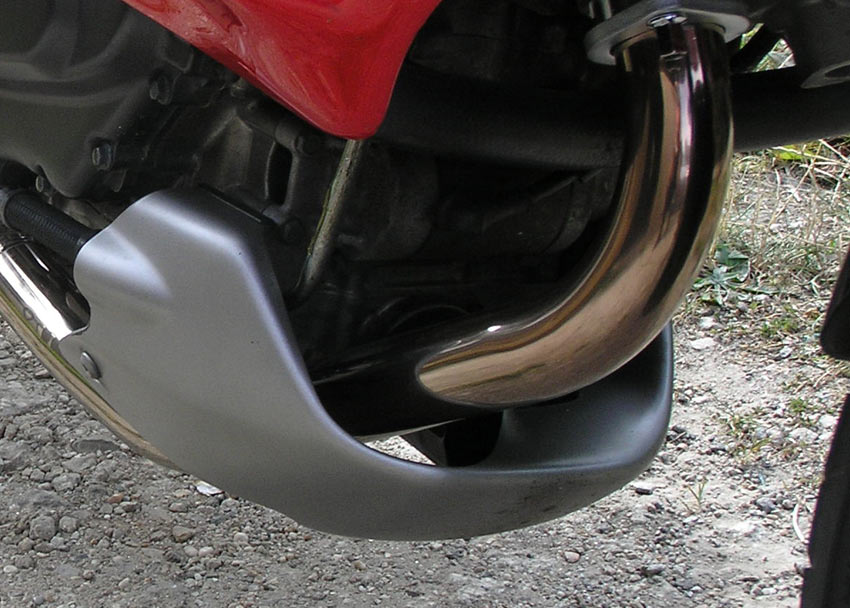

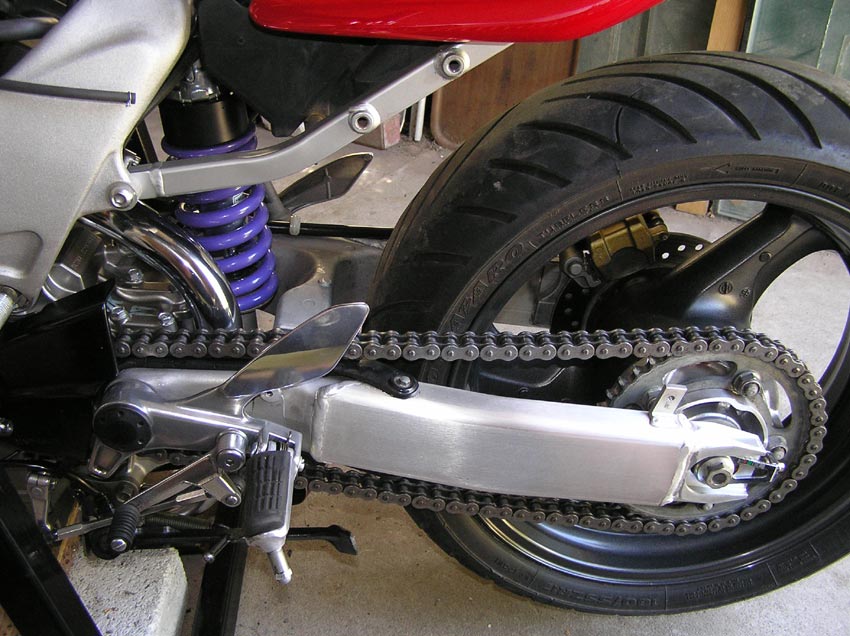

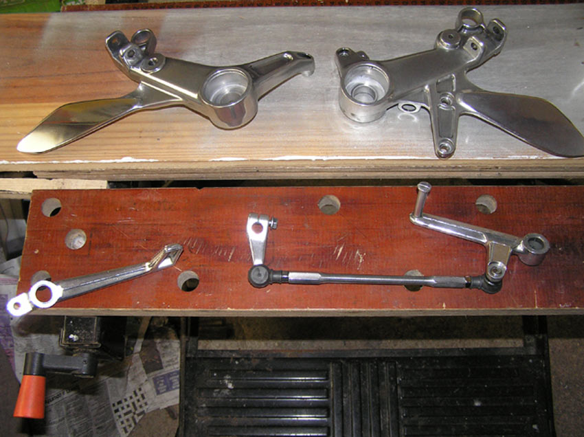

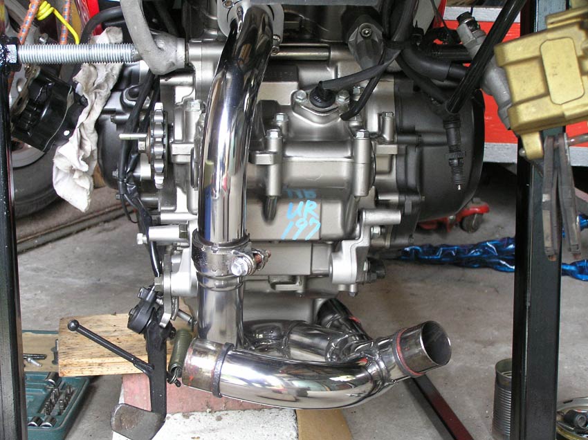

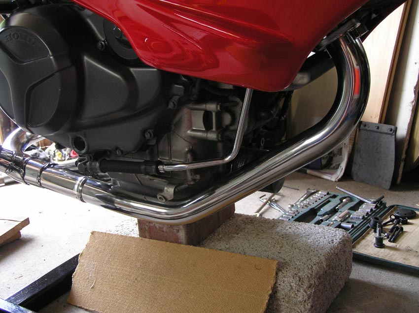

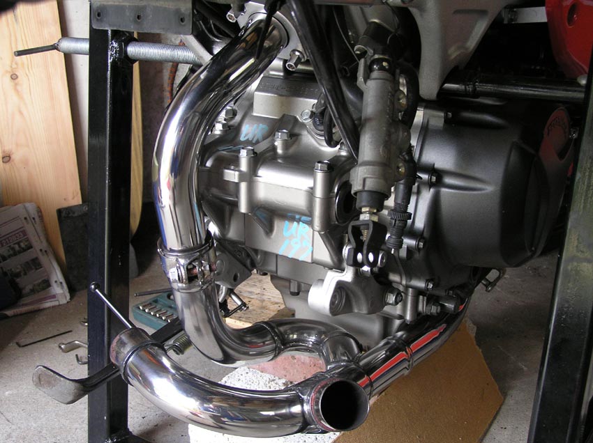

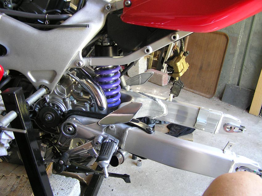

I finally got around to stripping out the swinging-arm and linkages to grease all the bearings etc! while I was at it I decided to polish up the exhaust headers and the rear-set footrests, also clean off all the muck that had come off the chain that builds up over the years, and give the chain a good clean while it was off!
The reason I got around to all this was I bought a Maxton spring for the rear shock so I had to remove some of the parts to fit that!

Love the look of the downpipes m8 how long did they take and what with?

dookie wrote:Love the look of the downpipes m8 how long did they take and what with?
Cheers Dookie,
After trial and error I ended up purchasing a set of three polishing wheels (3 different grades of wheels 4" and 3 different grades of compound) that attach to an electric drill, all for £20 from a local tool shop, the hardest part is the two crooked bends as the 4" wheel is to big to reach all of the pipework, so I had to revert back to the wet and dry and autosol for those areas.
I didn't really take much notice of how long it took, at a guess I would say somewhere between 6 to 8 hours just for the actual polishing, obviously that will vary on how bad your pipes are.

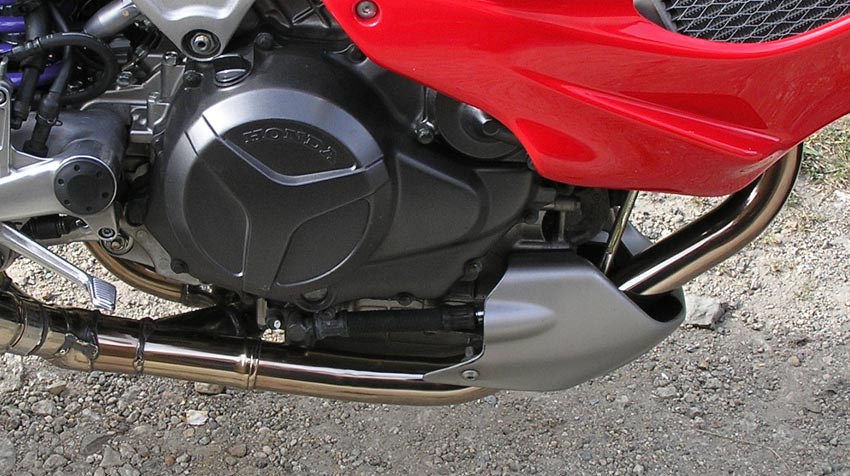

The only downside after all that work is after a couple of rides the headers have already changed colour, to a goldie bronze colour, which at first I was quite annoyed about but now I actually quite like it, imo it looks quite expensive. People have said that the quality of the stainless steel is not that good and I would definitely agree with that :!: Anyway have a look at the pictures:-

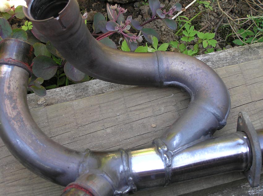

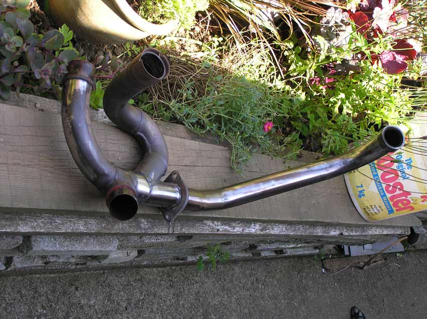

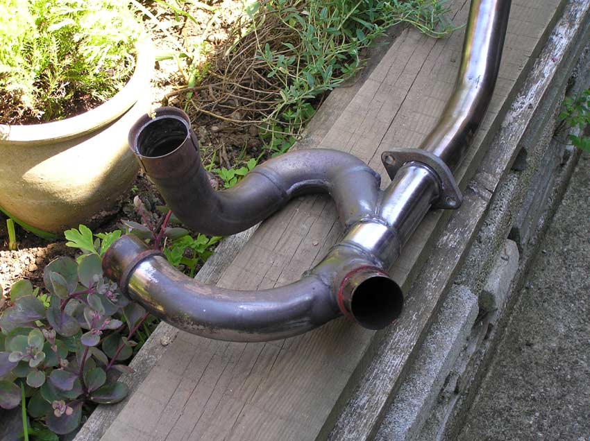

SterlingCG wrote: looks great... have you got any before photos?
Cheers Sterling,
I fully meant to do that, but forgot to at the very beginning, but here's a couple part way through the process:-
