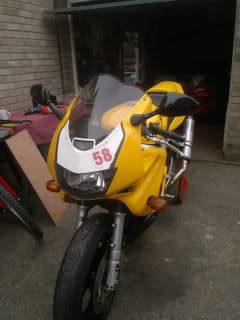

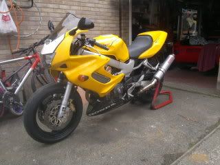

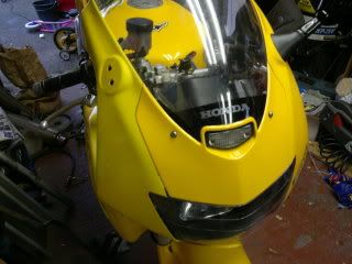

Thanks for the input guys, and I think the problem is combination of the ideas suggested in the last few posts, but first have look at this pic taken this morning in the sunlight.
Match looks much better under sunlight, and while it isn’t 100% perfect the strip lights in my garage highlight the difference, I now think the mix is actually pretty good and believe the problem is in the application, now I’ll admit to rushing the job a little to ensure it was painted for Friday this combined with the fact I just hung it from the garage roof when I shot the colour as resulted in an imperfect job, I may have got away with it had it been a solid or normal metallic shade but this pearl appears to need a lot more care.
Firstly I think as someone mentioned getting the right number of coats on is essential to achieve the desired shade, when I look at the panel I can see where it’s applied slightly heavier that the tone is richer, and also it seems important that the paint is applied in the same orientation across all the panels, because the tint changes as you look at in from different positions, I guess this the point of pearl paints,
So I think I’ll end up ‘carefully’ painting the whole front end ensuring the paint is shot from the same angle and direction on each panel and building up the number of coats till the necessary shade is reached, hopefully I’ll get it right the next time, thanks for everyones help and advice.

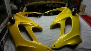

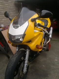

I'm resurrecting this thread because I'm sorting out the paint on the storm as part of it's prep prior to taxing it.
Other things it will be getting are a full service inc coolant flush and replacement, but at the moment I'm looking at the paint.
As described previously in the thread I'm having problems matching the pearl yellow paint.
These are the panels taken off the bike

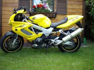

the colour on the right is more similar to the post '99 shade see below
the above bike is a later model with the slightly lighter shade that is more like the shade I had mixed than the original pre '99 colour although frustratingly they share the same paint code, nice one Honda,
As you can see below the right (O/S) panel I've tried o colour match is a different shade (slightly more 'lemony' and not quite as rich) from what people have said it is very difficult (impossible even ???) to archive a perfect colour match with this shade, however my paint supplier is going to try and 'tweak' the mix to improve it but I'm pretty sure it's never going to be 100%, where the panels join the difference is most obvious

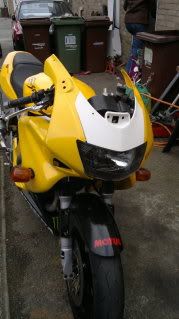

even if I blend it in I still don't think I'd be happy so I've got hold of a damaged fill panel and painted it white (it's only white primer at present) but it should go some way in diverting the eye from the slight difference in shade, plus it looks a lot like a anniversary edition only in yellow.

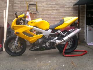

The pic below was taken last night and I think looks quite good, it's only assembled in mock up but and I still want to try to improve the shade abit but it looks an whole lot better than with the yellow panel.
So I'm going to get the paint done and then i need to decide whether to fit a clear or lt smoke tint double bubble screen in place of the OE.

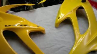

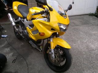

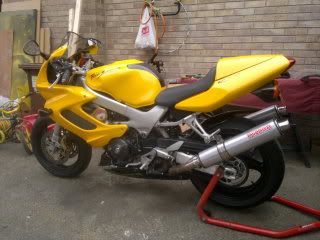

following the problems I had with colour matching the O/S fairing I decide to paint the N/S panel as well, my paint suppier tweaked the colour adding some tint to 'richen' the yellow compared to the previous mix, I've posted afew pics which look great but don't tell the whole truth, the co;our is now more 'orange' and to be honest worse then before but the pics don't show this and the match looks better than it is, so it's back to the drawing board, I'm pretty sure now I'm going paint the tank and tailpiece in thre new 'richer' shade, which is more like the ducati yellow, other than the issues with the colour match I think the bike looks OK I like the white 'number board' to which I've added a Marco '58', the jury is out on this but it's only a sticker and will peel off if neccesary, but it's staying for the moment, I've also added a light tint DB screen (cheers toecutter) which I also think looks good I've not rider the bike since I fitted it (it's getting taxed for apr 1st ) but I'm hoping it will stop some of the buffeting the OE screen seems to create.
So I've just the front mudguard and hugger to finish in 2K clear and the it will be good enough till I get round to painting the rest to match thr fairings, then it's a quick oil change and off to the Isle of Man at easter for the pre TT thrash

Screen looks good on it
I wouldnt have the patience to keep repainting it!
