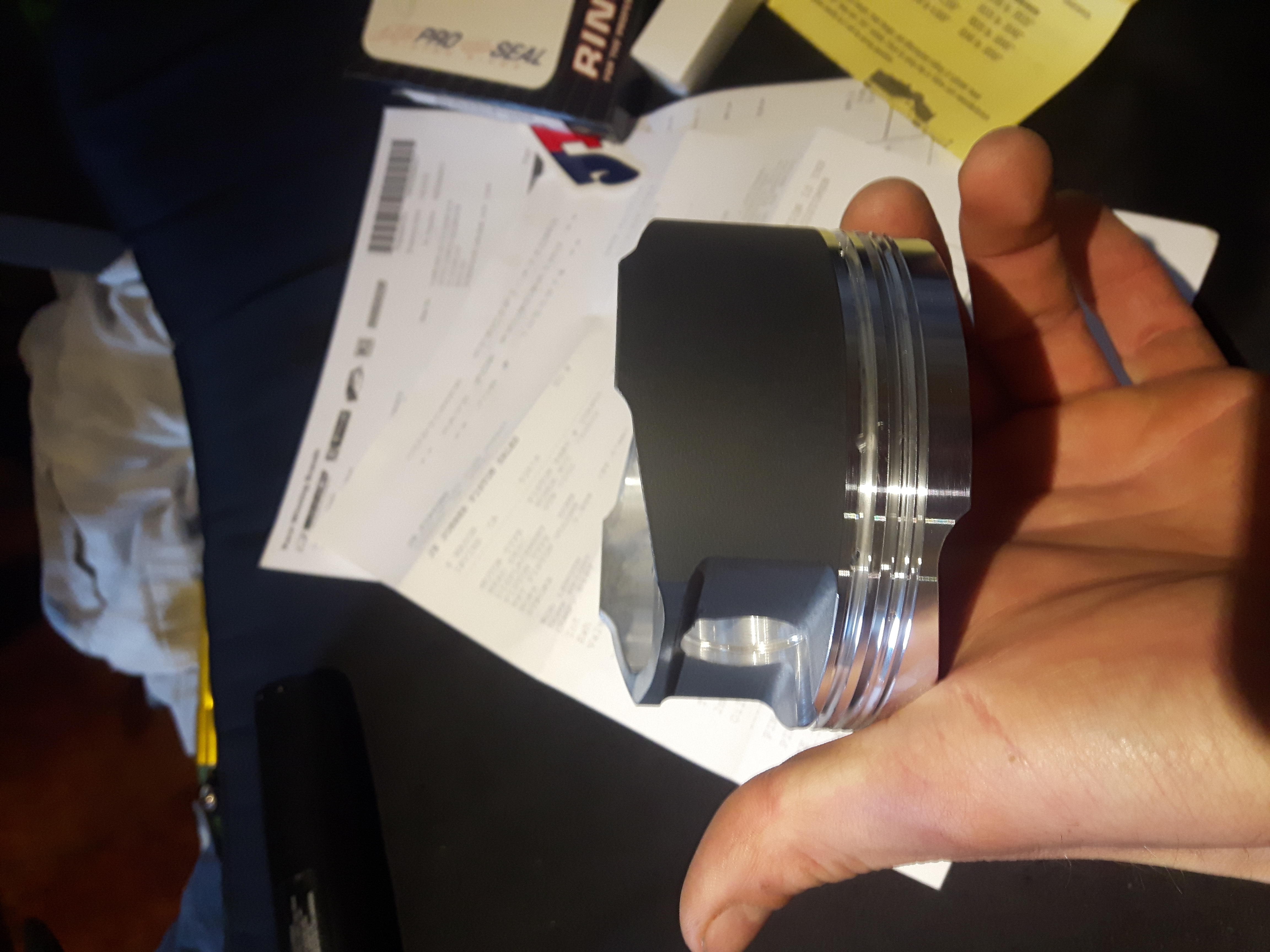

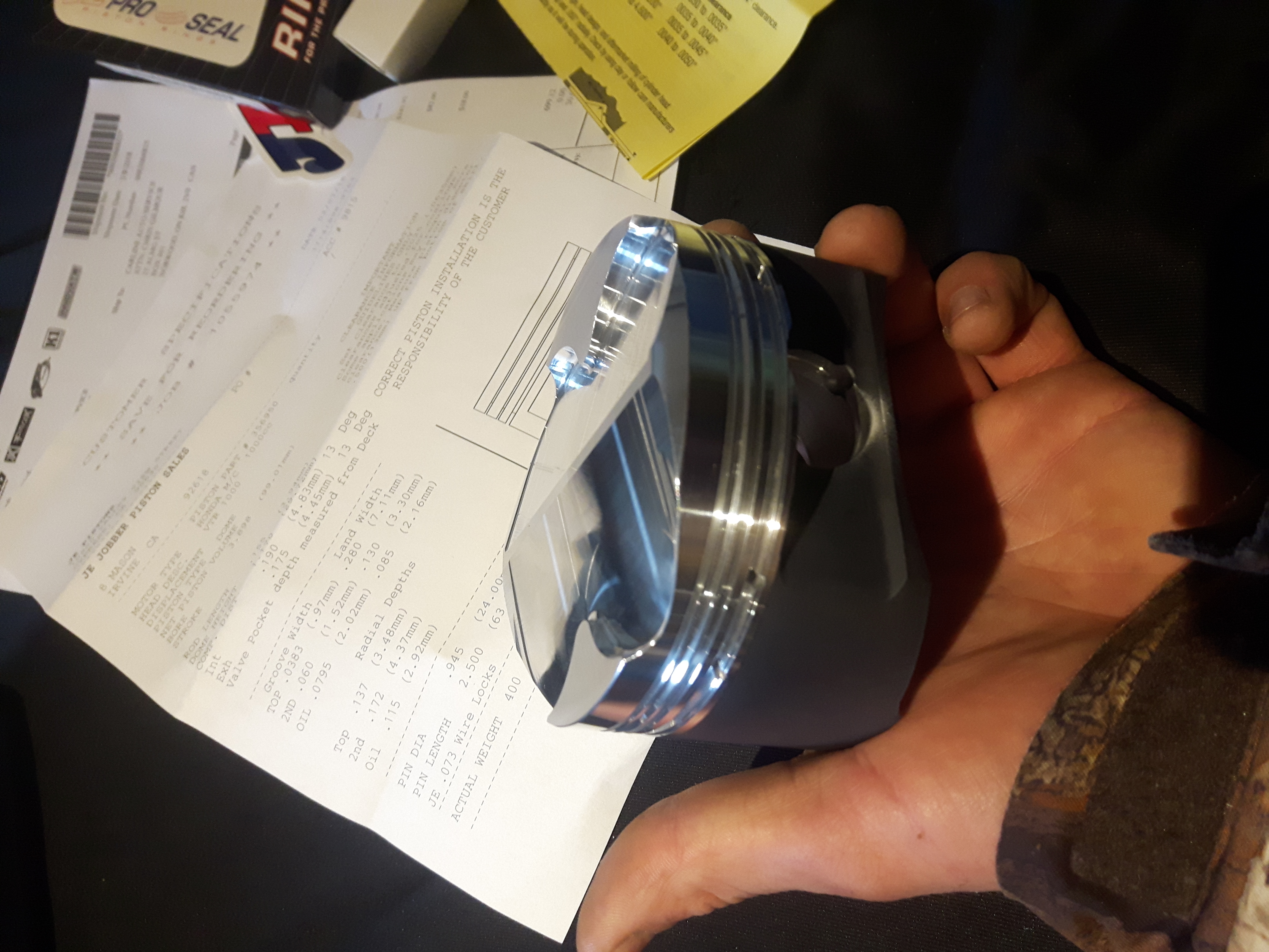

Received JE custom 99mm 11.5:1 pistons today, getting block bored next week.
I dealt with a guy named Bryant.. I would highly recommend dealing with him.
Heres a few pictures with a bit of useful info. Notice on the spec sheet it has a job # for reordering...
