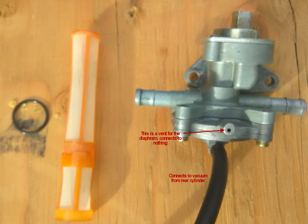

Wicky wrote: Tue Mar 12, 2019 2:21 am Yes the angle on the reassembled vacuum spigot plate could possibly be interfering with the proper action of the diaphragm.
Definitely worth swivelling around to rule that out so its pointing horizontal. And a chance to check its sited well and doing its job.
That is exactly what I was wondering.
Peeb wrote: Tue Mar 12, 2019 5:41 am
sirch345 wrote: Mon Mar 11, 2019 11:24 pm
Peeb wrote: Mon Mar 11, 2019 5:45 pm Image
Unless I'm mistaken the take off spout for the rear cylinder vacuum hose on the petrol tap is normally at 90 degrees to the vent spout, not sure if that would make any difference :eh:
High Chris, I can clock the fuel valve so the vac is 90 degrees to the vent. I did flow test the tank on a bench by applying vac to the valve and the fuel drains out the two supply pipes so fast it's empty from 1/2 full in just over a min. Thanks for thinking and helping. Peeb
I'm not sure which way you applied the vacuum to bench test the flow, but it could be worth bench testing the flow again using the pipe from the front cylinder with an extension (if you didn't do it that way of course) so you're getting a true picture of what happens on the bike. Also as Wicky said worth checking the diaphragm when you spin that plate it around,

sirch345 wrote: Tue Mar 12, 2019 1:47 pm
+1 to this. Although you have already ruled out the petcock it is worth looking into again. It may work if you suck with your mouth on the bench, but when you open the throttle on your bike there is not much vaccum causing it to not work properly (maybe a pinhole, or not sealing properly). At an idle there is a lot of vaccum, and it probably works fine.
8541Hawk wrote: Mon Mar 11, 2019 3:02 pm I doubt it is an issue with the pulse generator. When they go bad you usually see erratic running at higher rpms and it slowly gets worse and lower in the rpm range as the generator degrades more.
I would take the advice of trying to open the tank when it is happening and see what that does as it does sound like you either have a tank vent issue or the vacuum line was inadvertently attached to the wrong nipple. :thumbup:
Mr 8541 Hawk. Thank you for the reply. I think you were the guy who got me going on the Pair Delete, the 48 pilots and TPS adjustments that really made this bike sing.
I did try opening the tank and tried running with it open with no change in symptoms. I was CERTAIN the vent or screen or diaphragm or vac source had to be causing a fuel delivey problem, it just makes too much sense. I also bench tested the tank and valve by providing mouth vacuum to the valve. I'm aware of the similar but incorrect nipple on the fuel valve that is the vent for the diaphram. Photos of the tank bottom and fuel valve are attached with comments. I welcome your suggestions, there are plenty of times I have missed something and the symptom is so indicative of a fuel problem.
Thank you for the pics Peeb. Was struggling with similar symptoms but thanks to your notes on the tap realised I put the vac pipe on the vent so the carbs were just running dry. Cheers Ed
