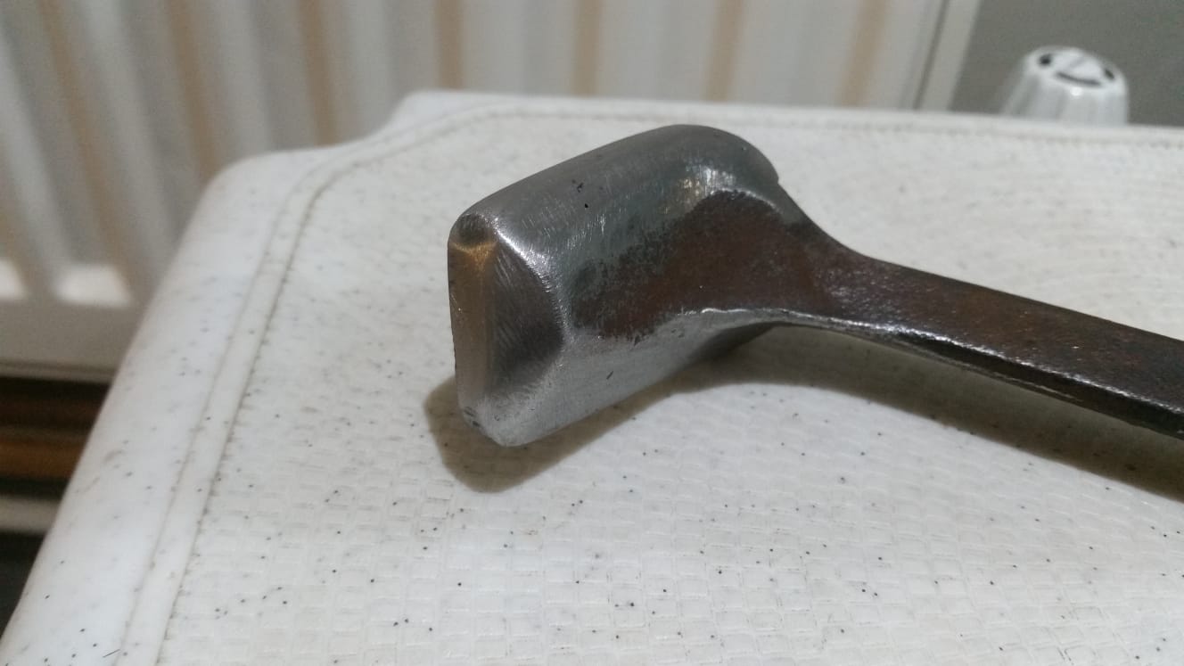

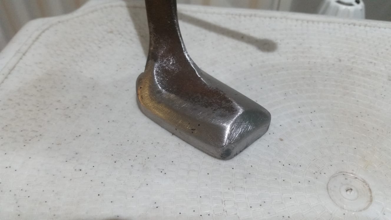

This afternoon I welded the 6mm plate to the bottom of the Storm's side stand. I need not have worried as the stand material seem to work well with the mild steel rods for my Arc welder :thumbup:
I will be painting the stand soon, this is where I'm at now:-
I appreciate the advice I received from all :thumbup:
Re: Welding a plate to bottom of side stand?
Nice clean job Chris, well done mate :thumbup:
Not bad at all :thumbup:

That looks decent, almost natural
Nice job Chris, once painted you'd think it came from Mr Honda like that.

Well done Chris, like I always say, if it looks like it belongs there, then it's right :thumbup:
I did the same when I retro fitted a storm side stand to my BMW Cafe racer :D
