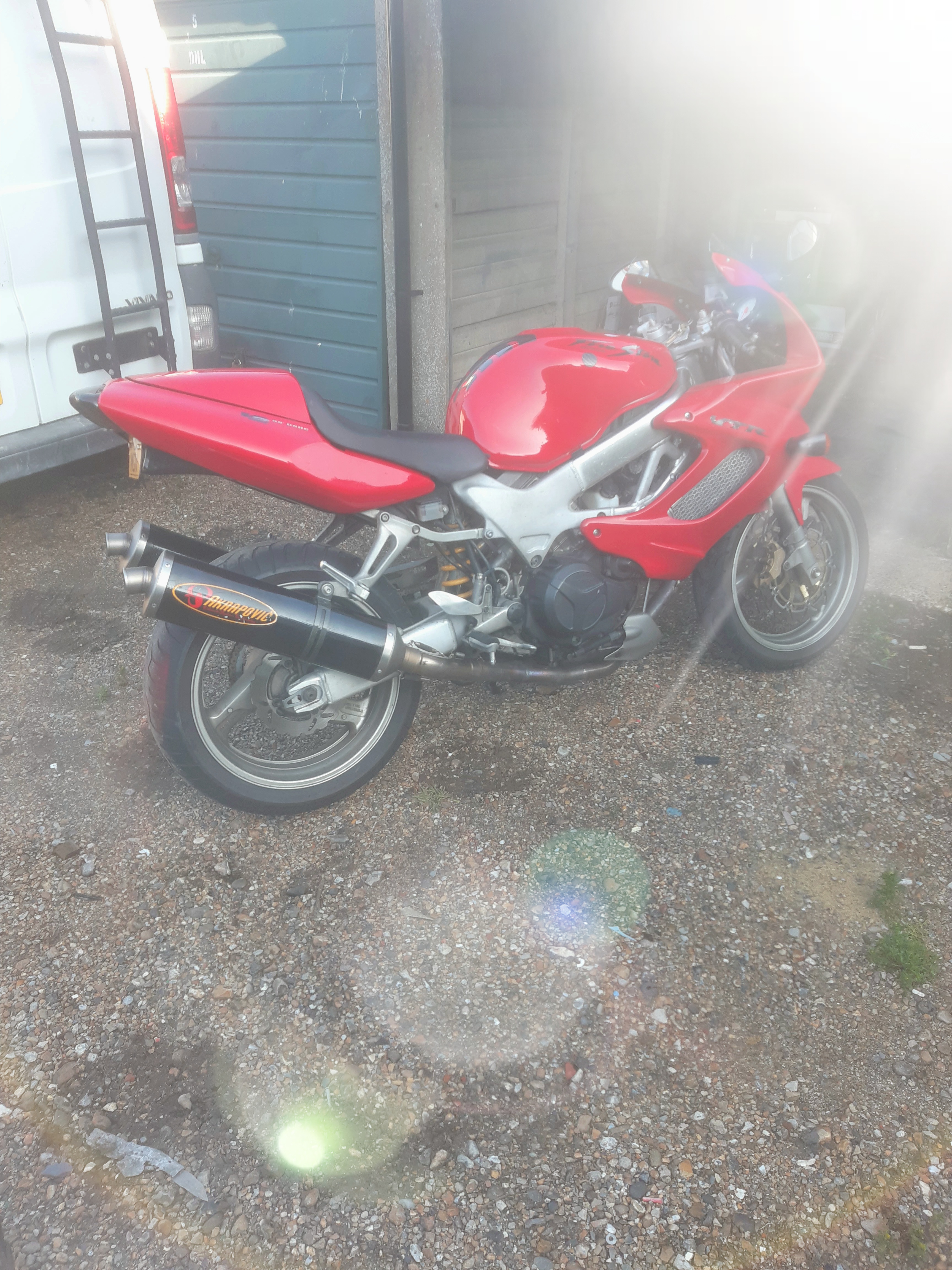

Well the akra system is on all up and running , sounds sweet but im still getting used to the humongous cans not my usual preference. It no longer pops on over run not sure if that's a good sign or not. Id like to get it dynod at some point but wont be happening soon. Still trying to upload pics bear me.

Ta da !
Re: Yoshi cans
The new exhaust system looks the dog-danglies 8)
Re: Yoshi cans
DJWALKER wrote: Sat Jul 03, 2021 11:55 am Well the akra system is on all up and running , sounds sweet but im still getting used to the humongous cans not my usual preference. It no longer pops on over run not sure if that's a good sign or not. Id like to get it dynod at some point but wont be happening soon. Still trying to upload pics bear me.
The cans are big but they work very well :thumbup: The carbon seems to hold up well also. I re-packed mine when I got them and been running them for a few years now with no issues. Actually longer than a few years and should really re-pack them again. 8)

Thanks chris , im still not sure about the look if im honest.
As for repacking does this just tone the volume? And i assume you have to remove the rivits to open them up ?.
Re: Yoshi cans
Yes, just drill them out. Use "blind" stainless rivets when you come to rebuild them. The baffle material also helps to protect the sleeve, as it prevents hotspots.
It's a lot easier to use a drill press rather than holding a drill by hand, and use a sharp bit. It's easy for the bit to wander off as you try to drill into the little steel ball closing the centre of the outgoing rivet, and using a drill press reduces the chances of this happening.
