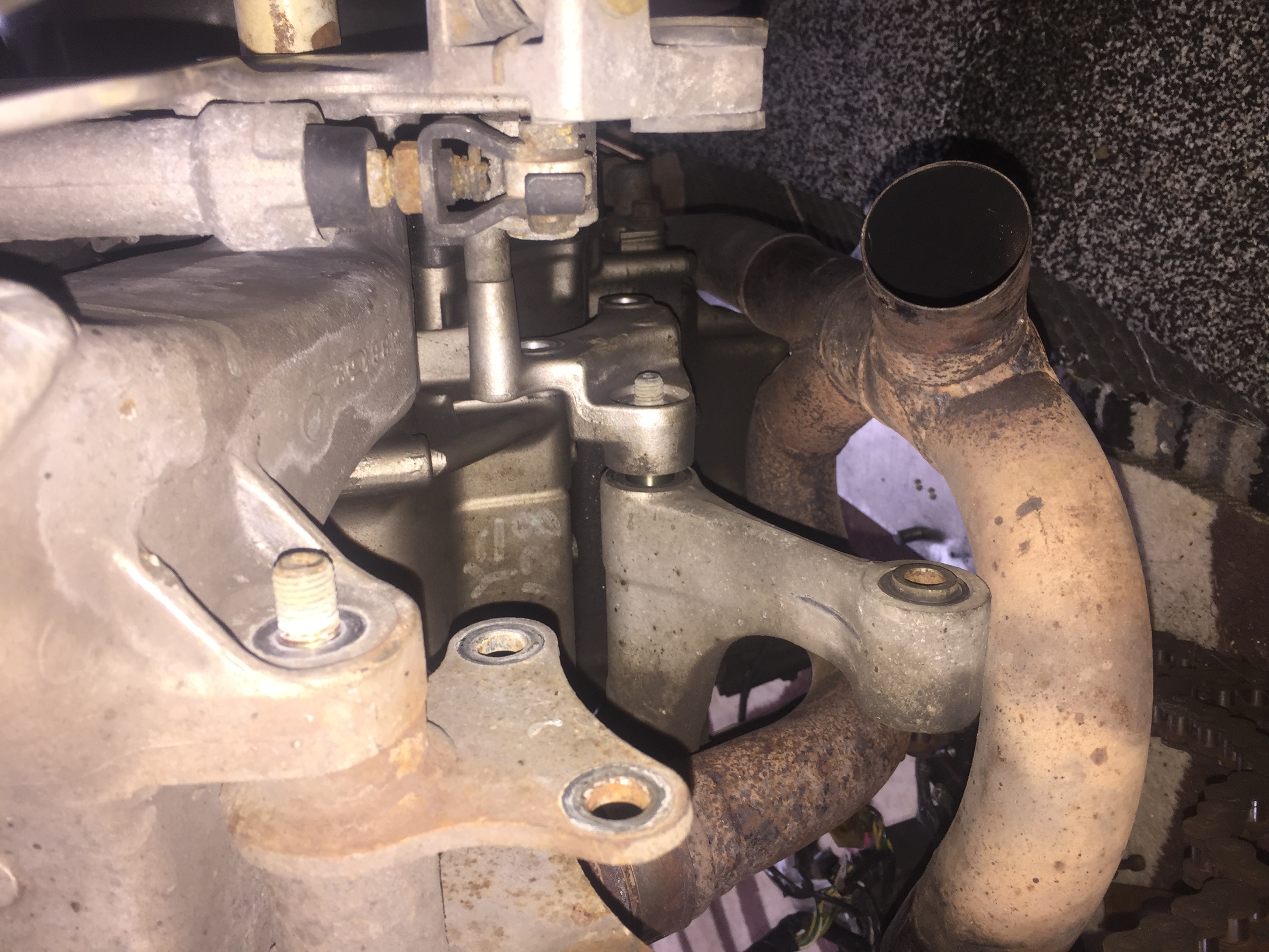

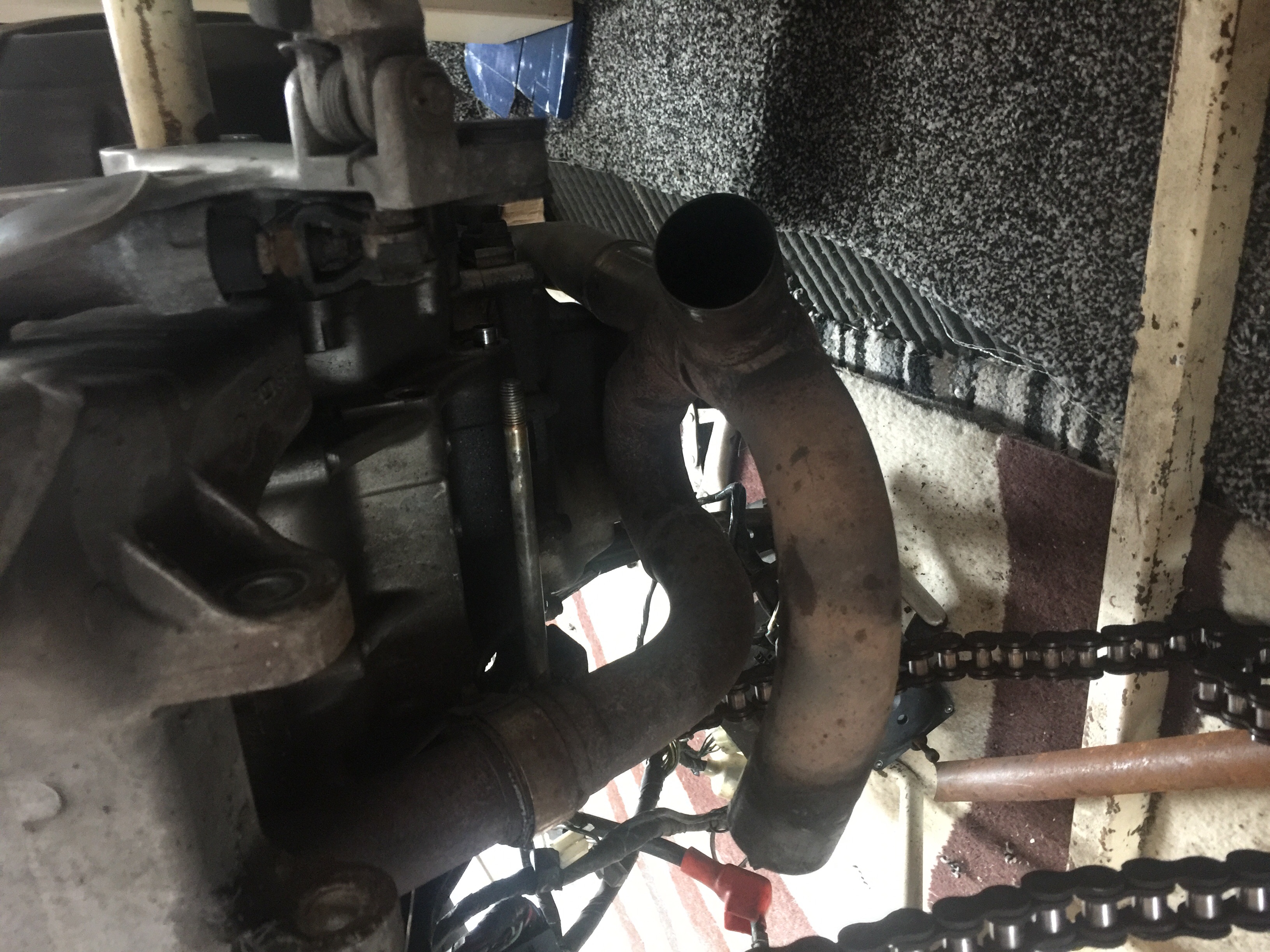

Hello all i just started to change all the bearings in the linkage and swingarm and got stuck with 2 of the bolts the one on the swingarm and the one that goes throw the back of the engine both have alan key heads on them it's like they or seized or sum thing. Can sum one please tell me how to get them out I've tried whacking them with a hammer to no joy thanks
:beer: I drink beer like my bike drinks petrol :beer:
VTR Phoenix
Posts: 710
Location: Slough, Berkshire
Re: *** IMPORTANT*** Swingarm and linkage bearings servicing***
Post by VTR Phoenix »
Whack harder with a bigger hammer, you'll probably find the bearings have collapsed and rusted which in turn seizes the bolt. Before whacking though get a socket on it and try to turn it, use a breaker bar if you have to then hit it
Paultandy
Posts: 124
Joined: Thu Jan 19, 2017 8:16 pm
Location: Rotherham
Post by Paultandy »
Used a bigger hammer and got the one on the swingarm out but nackerd the nut up the other one is sized solid ad to tack the bracket of the engine lol
The one in the enigine...Put the nut back on before any hammer action or you will knacker the thread. Once you get it moving take the nut off & use a punch to knock it through. As said use a long as poss bar on the allen key to add leaverage to try & move it...Plus Gas over night might help.
Once you have the whole arm off (hopefully) for the other bolt holding the triangle bracket on...again soak it with plus gas* then try this...
Its awkward on you own but do able, just much easier if you have an extar pair of hands...
Get a socket that fits over the bolt head** but fits into the recece in the webbing. Now holding this in place get your helper to lift & hold & guide the swingarm & clamp it in a large vice. (in theory you could do this with a G-clamp but I dont think you'll be able to get enough pressure on it...)
So the socket is againt one jaw & the end of the bolt is against the other jaw...Now tighten the vice & keep tightening it, use a scaffold tube on the bar for extra leverage...
Until you hear a satisfiing CRACK ! as the corosion bond gives way...
I've done a couple like this with no problems...The first one I ever did before I tried this way I ended up cutting out with a grinder... :lol: :lol:
* Plus Gas is way better than WD-40 for rusted in nuts...Trust me I tried both...
** The socket here needs to be bigger than the bolt head as you looking to push the head out into the socket...IIRC it's an Allen head anyway.
It's easier to do than explain in txt thats for sure... :lol: :lol:
