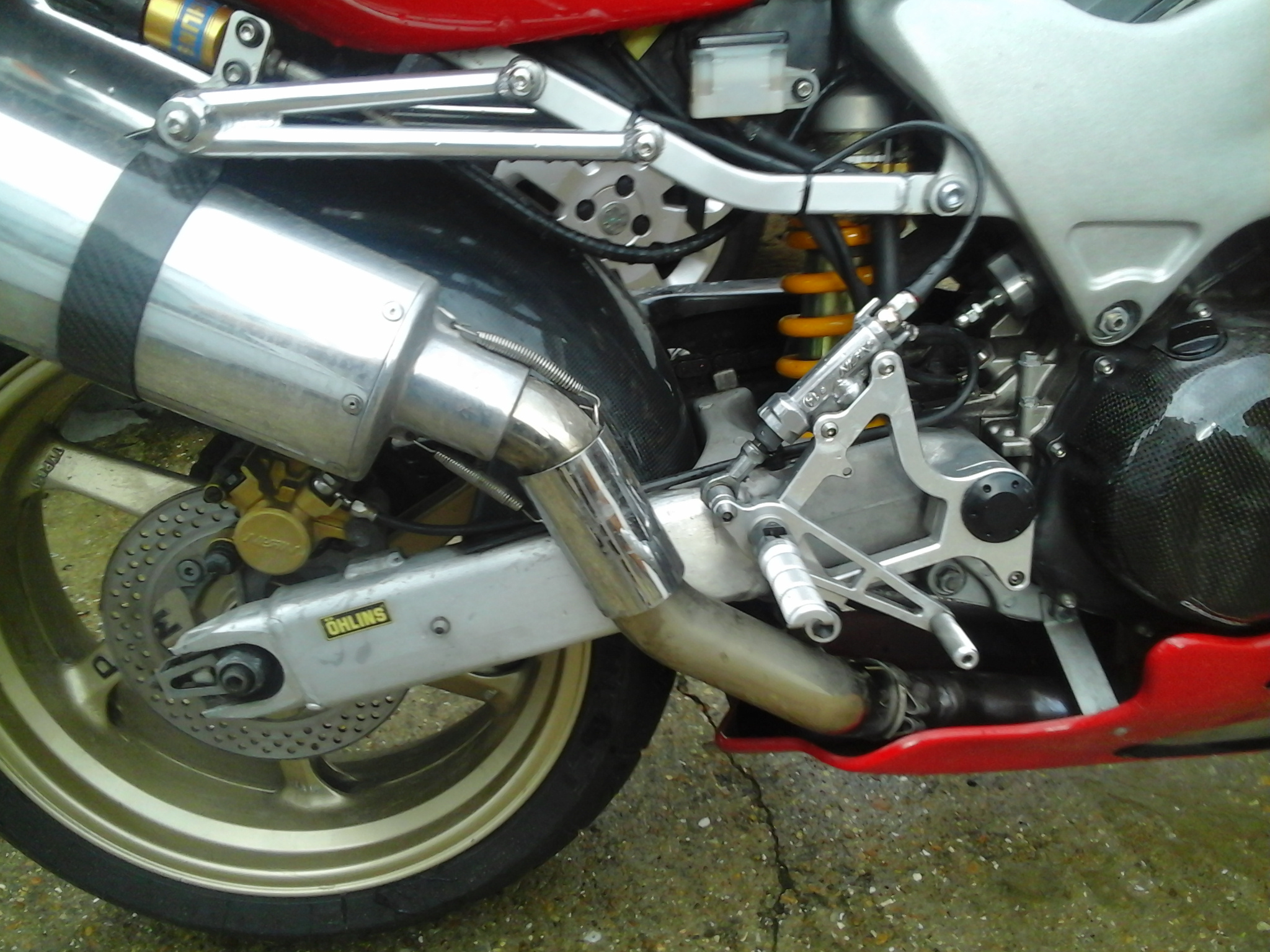

This is one of mine & shows Manual CCT...

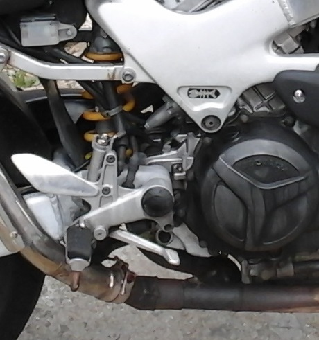

Blonkey 5 CCT crop-crop.jpg (75.26 KiB) Viewed 586 times
Another one that shows origonal CCT.
