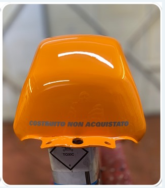

PS. I looked up what you had added to the rear of your petrol tank :clap:
I like it.

yea, its hidden by the seat... but I know its there!
