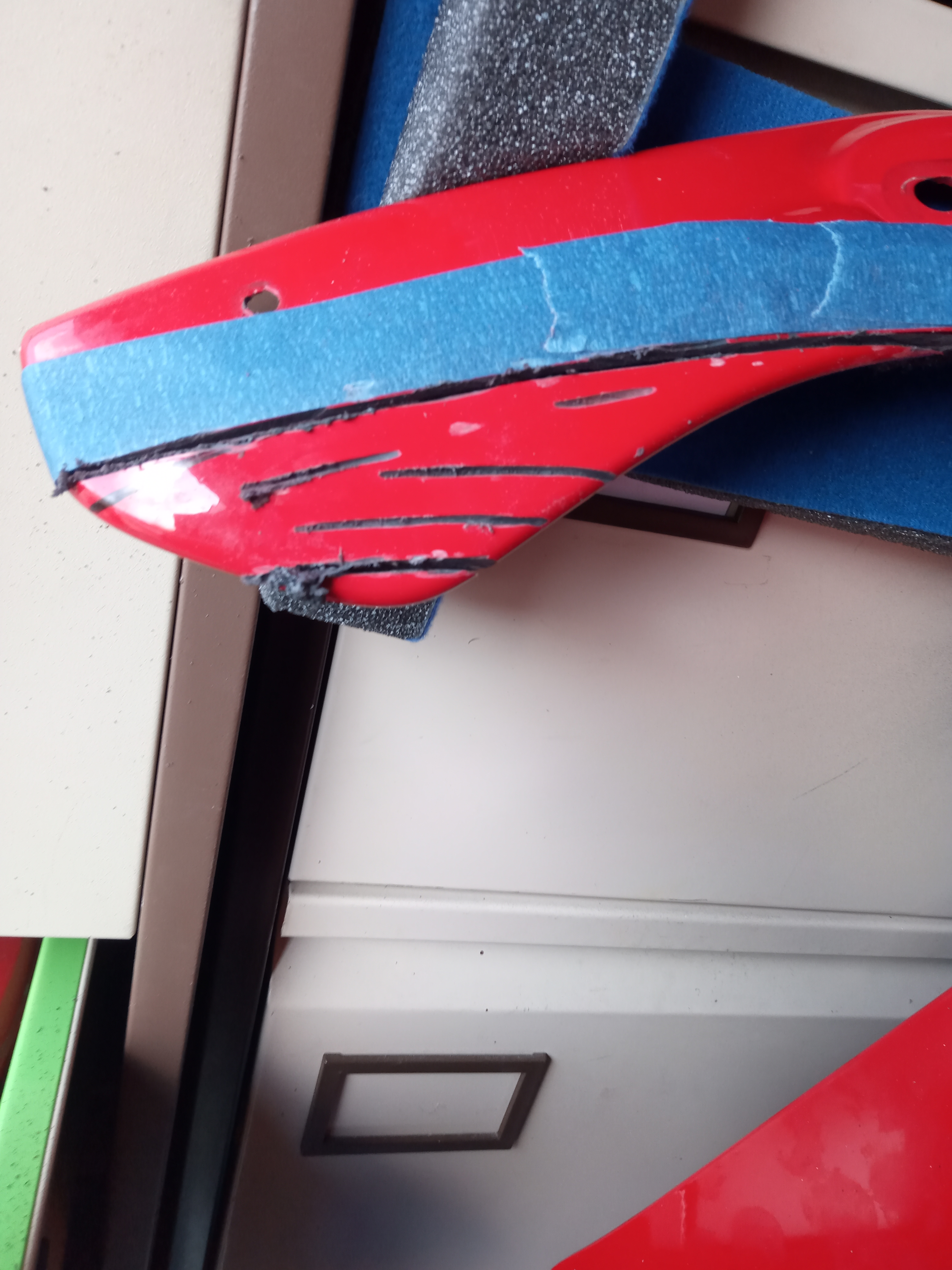

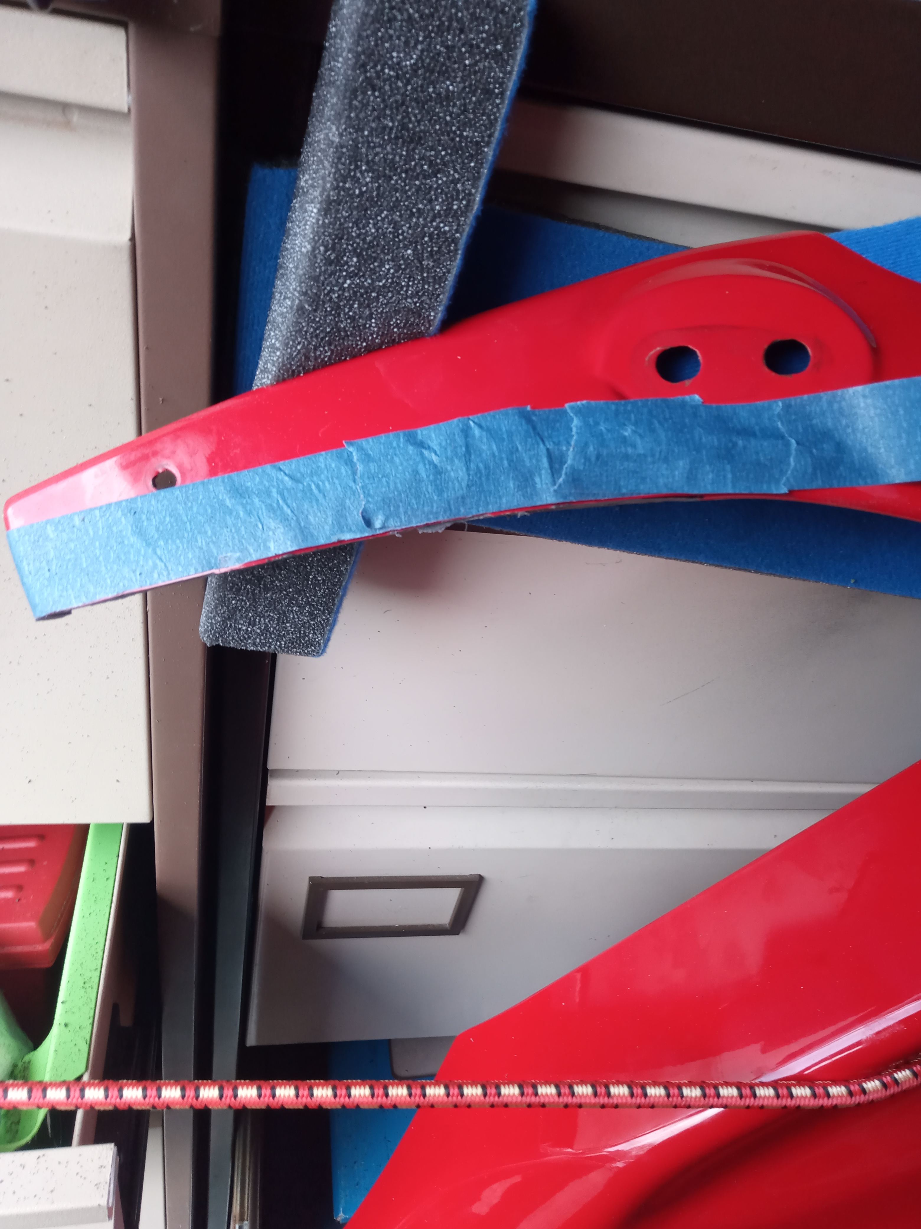

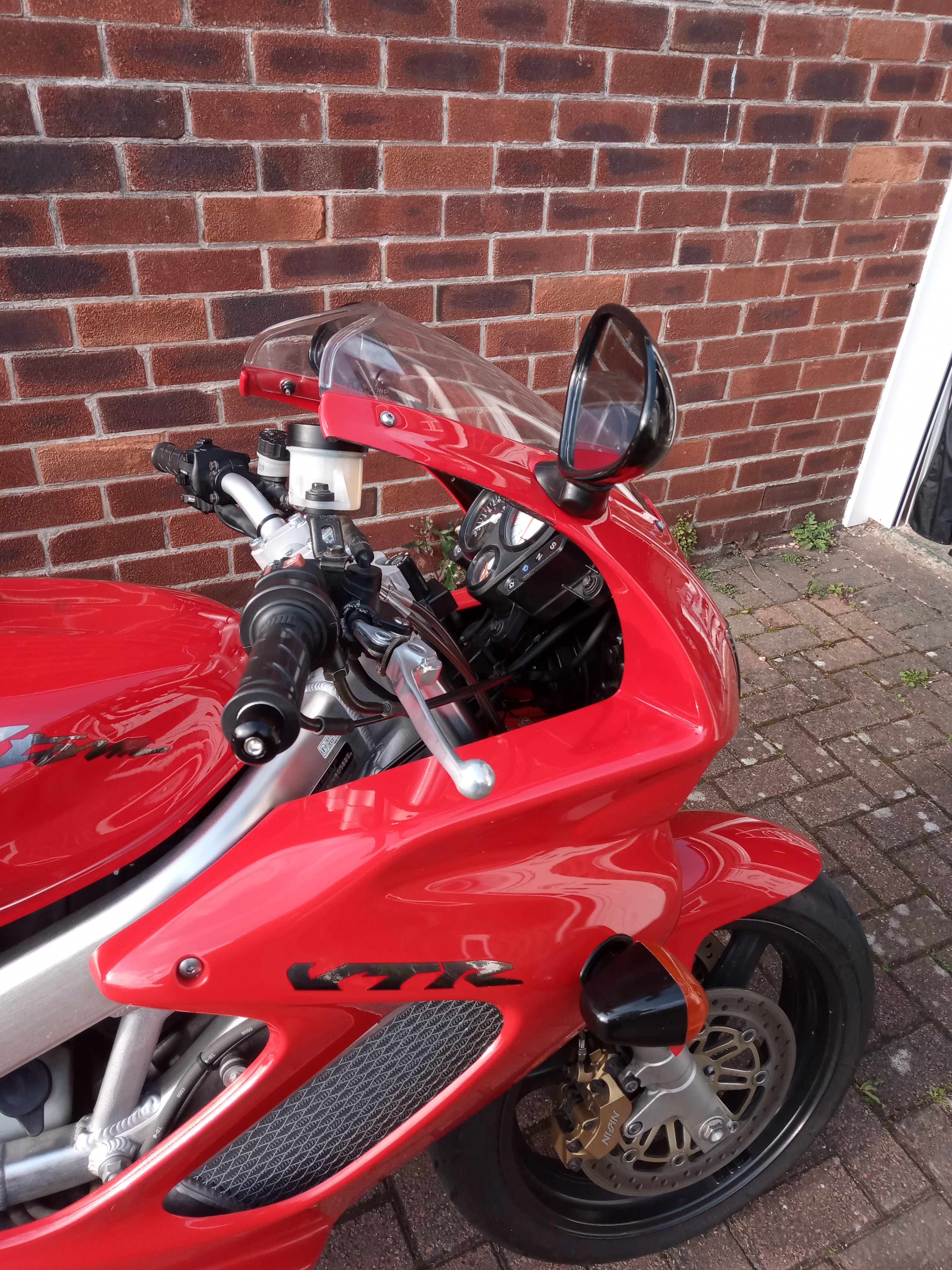

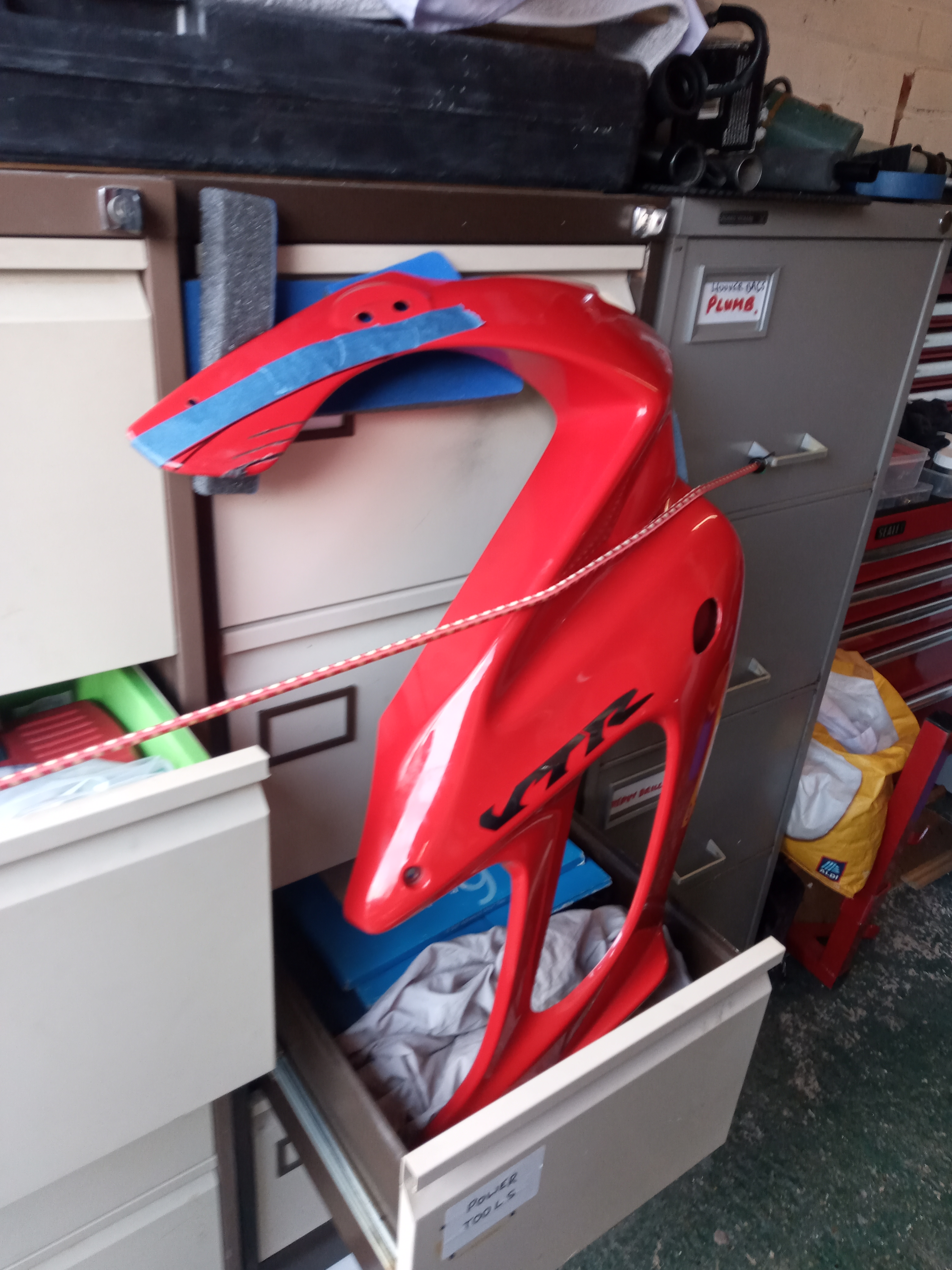

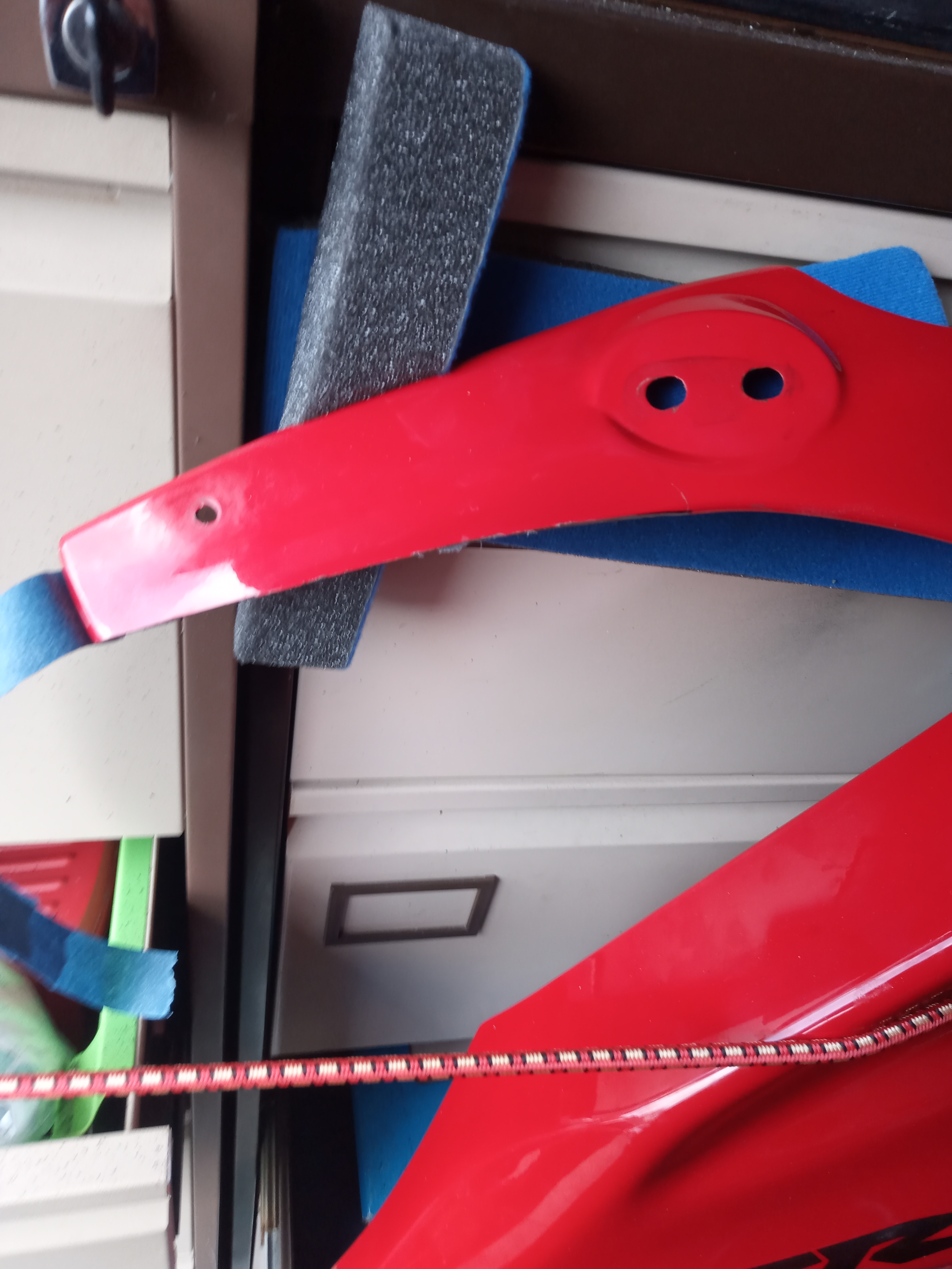

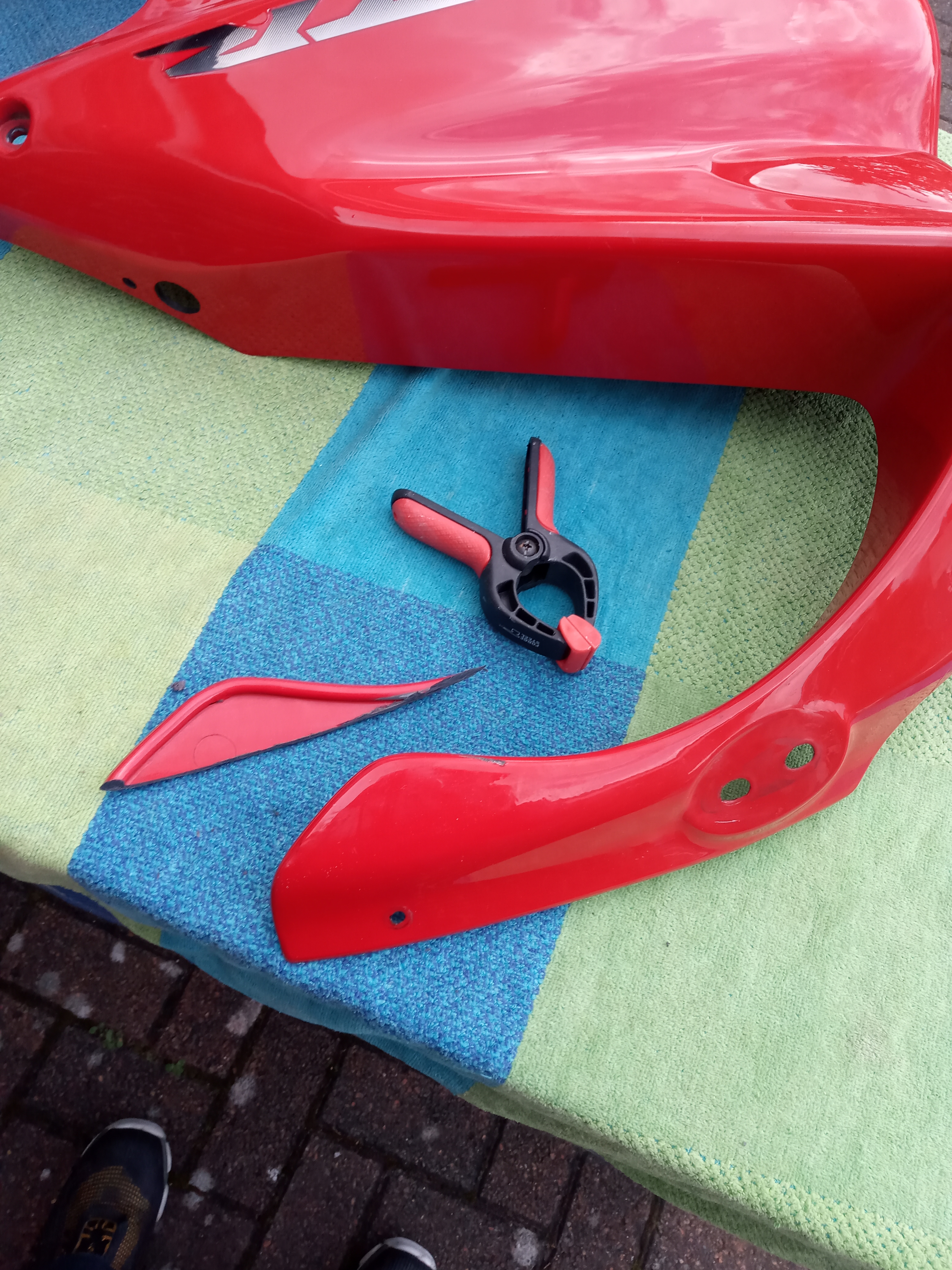

Finally did it. Top tips, get a bendy ruler, mark with indelible marker the desired cut line, mask non cut area off with 2 layers quality masking tape, use Dremel plastic cutting discs, set rpm 12,000 to stop plastic melting. I suspended fairing in filing cabinet, bungee holding it tight and foam blocks behind. Practice cuts on the waste ear lobe below your cut and get the hang of the Dremel. Cricket bat grip i.e. 2 hands. Take your time and score the whole line before going deeper. Was pleased with the results, the cut for each fairing took approx. 5 minutes. See pics. Had to move switchgear in 3-4mm each side. Its tight and surprisingly the mirrors come into play and get very close to your hands on full lock with my chosen Renthal bars. So maybe after market mirrors an option. Bottom line, fantastic, turns the Storm into a different riding experience. 100% recommended.

Like the filing cabinet idea, doing it at work in your lunch break?

I like your idea of using the filing cabinet to hold the side fairing panel upright :thumbup: :thumbup:

Thanks Tony, Chris, this is my garage, I've got 6 filing cabinets and 4 Bisley multi draws to keep all my "crap" in order ! Cant figure out if its OCD or a tidy nature ! I personally found Its easier to cut like this than lying flat i.e. I could control the Dremel better not leaning over the fairing. Cheers Sean

My pleasure Chris, this forum has been a great resource for me, so any opportunity to give something back and make someone else's job a little easier is more than worthwhile. Appendage.! I loaded the photos back to front i.e. the end result first !. Also the practice cut lines on the ear lobe show a raised blob of melted plastic in the lower end of the picture. This is what happened when I cut at 15,000 rpm with the Dremel plastic disk (single disc, not doubled up as per a previous owners suggestion). The plastic melted really quick and bubbled immediately, so recommend anyone doing this, err on side of caution and do a few practice cuts. All the best Sean
