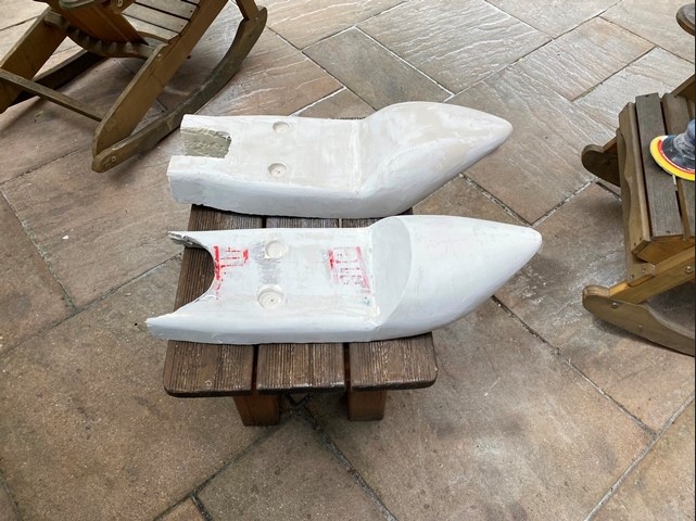

Next the messy job of making a seat, well I actually made two as I couldn’t decide on shape! Its the one thing many people ask how I do it, so I have written a tutorial on it rather than post all of it here.
here is the link to my blog page
https://jtccc.wordpress.com/projects-2/ ... nufacture/
So just a few pictures…

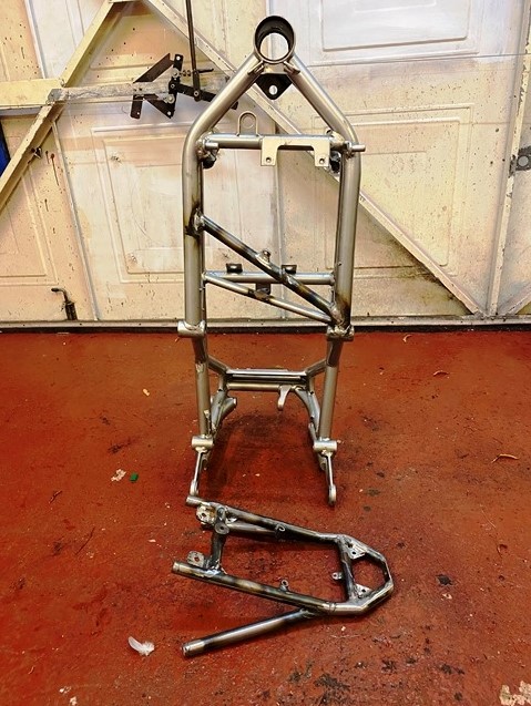

Lockdown is good for progress! I have finished the frame modifications to clear the carbs, and finished the fabrication on the rear subframe so it's off to the powder coaters tomorrow.

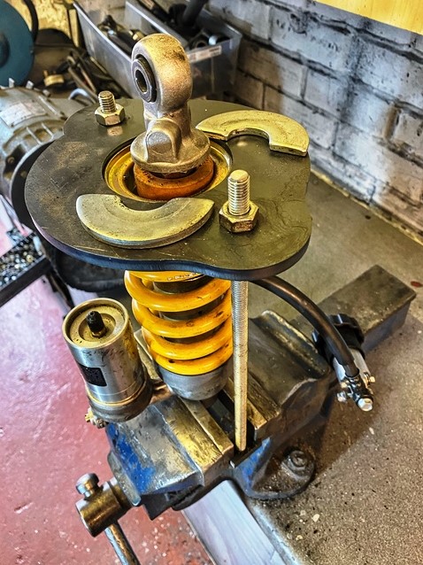

I have also stripped the rear shocker so I can change the colour on the spring... not sure what to yet, but definitely not yellow! had to make a clamp as these are strong springs and I have the utmost respect when working with them under this much tension, hence the beefy plate and studs!

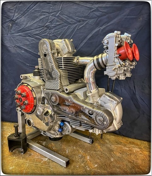

And here is the engine...

I like your spring compressor, like you say you cannot mess around with those heavy springs. It was a little easier when we had twin shocks :wink:

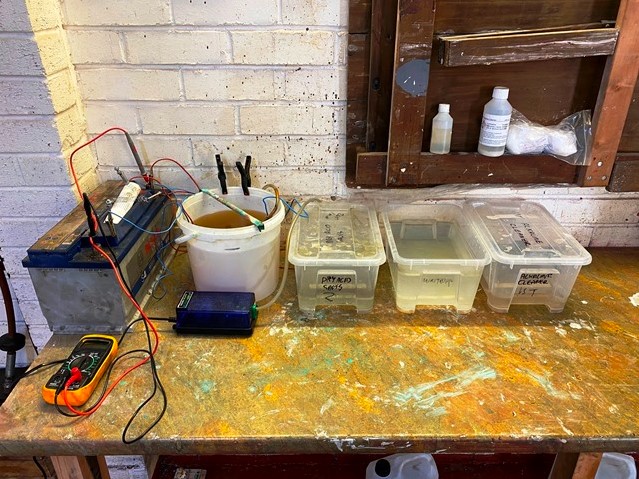

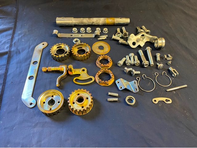

One of the things I have always struggled to get done is plating... I have had some terrible jobs done in the past, and lost critical small parts to the bottom of someone's plating vat!
so about 4 years ago I bought a plating kit to do zinc... Have to say it's VERY good and I have used it time and time again! its a bit time consuming, but time is something I have, particularly at the moment...
Here are the results for my latest build. the kit can do clear and yellow passivation, you can see the difference.
