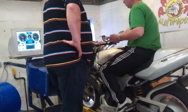

Whilst I havent been up to much lately, I did manage to rope one of my mates to put my bike on his dyno. He used to race karts back in the day and just so happened to have a dyno locked away :thumbup:

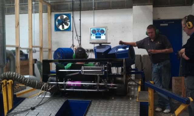

He was tuning some karts when I got there of which one made just over 60bhp (not bad for a 200cc - I think- 2stroke!)
After he had done this karts top power run it was time to get me bike on there...

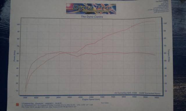

The result...

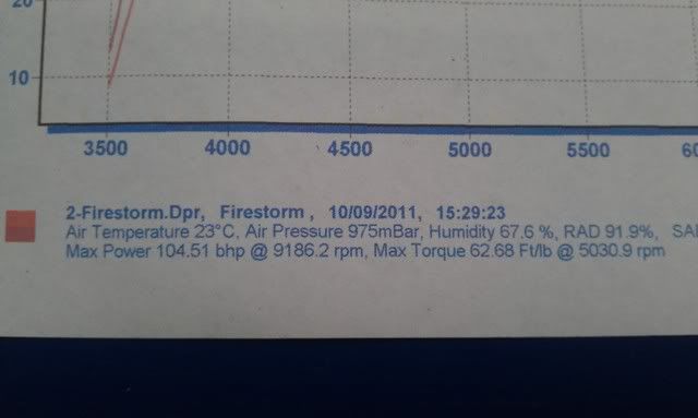

A very solid 104.51hp!! Considering I have a single sided exhaust on and according to other peoples experiences of such mods I was expecting around 80-90hp it has surprised me very much!!
WELL CHUFFED!!!!
Looking at the chart I've got a flat spot in the power around 6k rpm. Any ideas what this could be down to? I have noticed a bit of a stutter previously but seeing it on the chart kinda shows it for what it is.
My only real "problem" is I have no idea what mods have been done to the carbs (if any). Think my mate wants to the carbs down to see what jets are in there with a view to a DJ kit or similar. Any other suggestions? 8)

Much better than I was expecting too with the 2 into 1 system :clap:

it'd be interesting to see a fuelling graph next time you get near a dyno....
thing is, on a dyno, without a massive fan blowing air at it you'd never get the same fuelling as on the road but you will notice a difference in rideability if you get rid of the dip.
id guess it's when it comes off the needle and its a bit too rich.
maybe drop the needles a bit by removing the little shim...

Benny - Will get to the dyno as soon as I get some new rubber, tax, MCCTs a decent service and we move house (got lots on my plate at the min lol) Would love to get the mix sorted as there is a definite cough when pinning the throttle.
