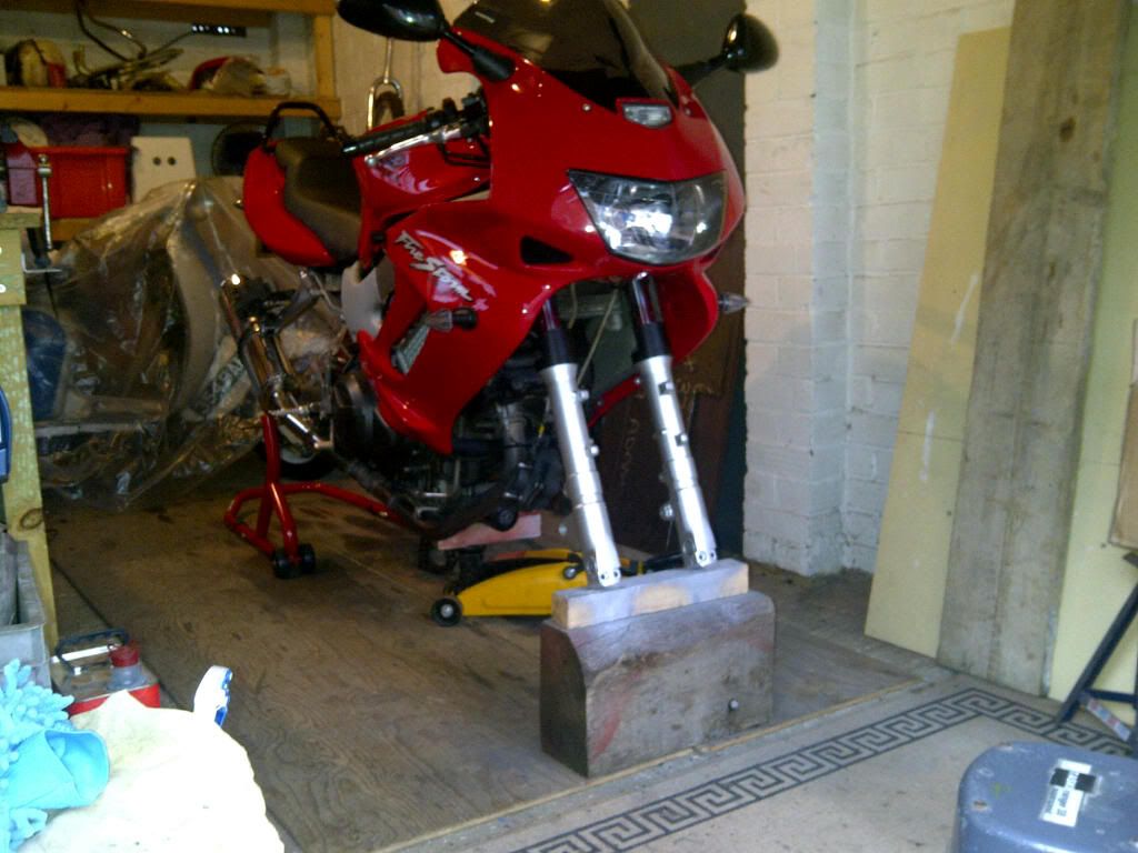

Here's one I hung up earlier, showing the difference between a wire brushed fork & as it was before, & when I'd finished the other one I did the down pipe!
Er no it dosn't it shows an attempt to use nitromors which failed as nitromors is now shite thanks to health & safety Hitler's so I got the wire brush
& an electric drill combo out.
Thats the one.....
