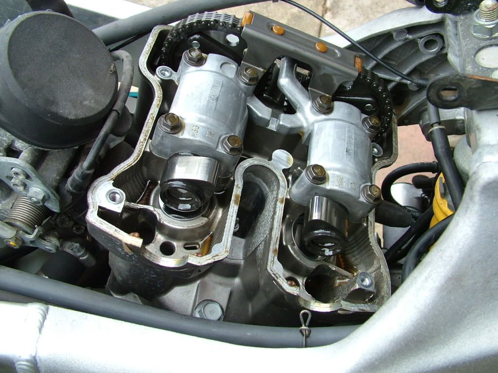

No, on the rear cylinder the cam lobes will be facing upwards and inwards. Image

The only thing I can see that you don't mention is the cam lobes need to be facing up as you say, but they also need to be facing towards each other [instruction (9) in the above link explains this], as in the position below photo. Also the RE and RI marks on the cam sprockets for the rear cylinder camshafts must be facing in the right direction too and inline with the top of the cylinder head. It's important you pay attention to those RE and RI marks, as those will not be inline with the cylinderhead if the cam chain has slipped a tooth or two as you're changing over the CCT's. Check those marks before removing the standard CCT, as you may find they don't line up exactly in the first place. Taking photo's of things as you go is a good idea, as sometimes they are very helpful when reassembling.

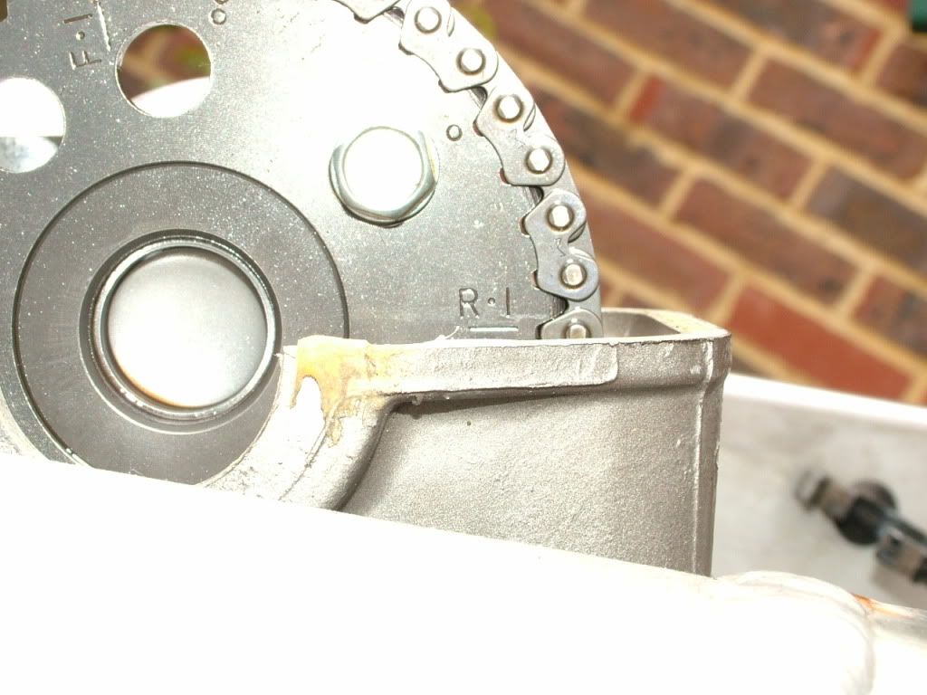

Here's a pic of the RI mark on the sprocket that Chris mentions.
ImageNote how it is inline with the top of the cylinder head.
The RE will be the opposite but is not as easy to see as the frame gets in the way.
