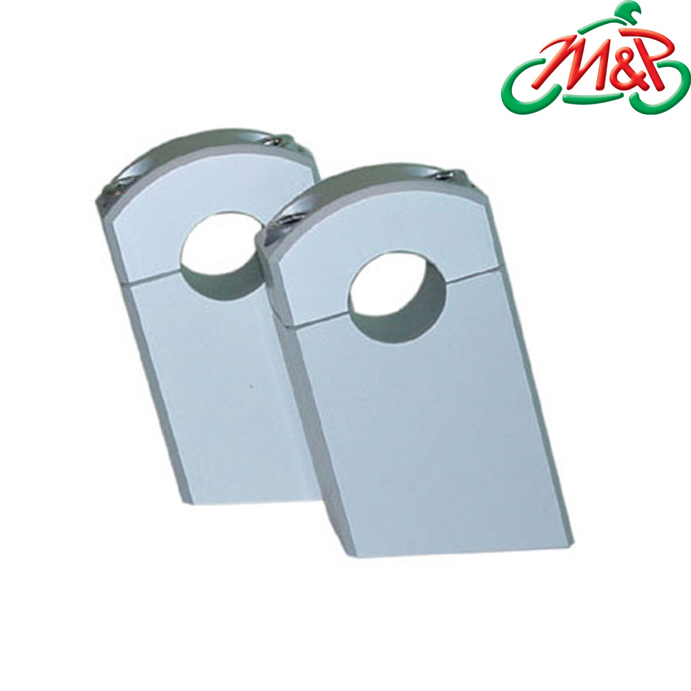

Good news is that you only drill 2 holes, and they are not threaded, the bar clamps i used have a single bolt holding the lower clamp to the yoke and there is a nylock nut fitted underneath the yoke
the problem with modding the standard top yoke is that you have to have the renthal bar sitting directly above the steering stem to avoid the fork tops which stick up through the yoke on the Storm. and when you move the yokes far enough back to clear the fork top, there is not enough of the yoke underneath to support the bolt or yoke.
So you need the clamps to angle back, not sit straight up, there are some like this
the ones I got were these
but I then had to machine them at an angle and alsu drill my holes at a matching angle, and have a spacer at the back at the same angle.........so it would be a real pain in the butt if you dont have a miller.
