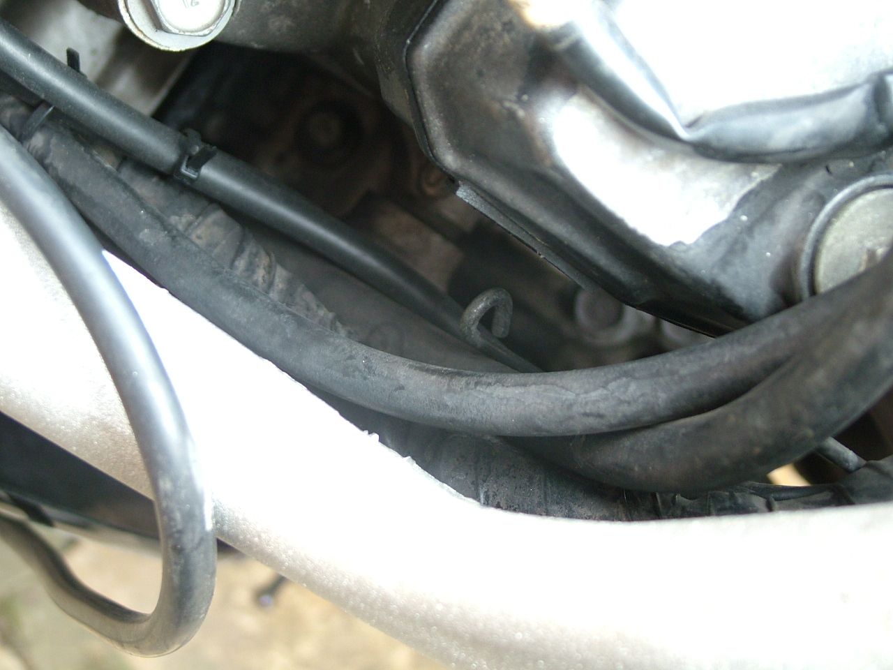

Here's some pictures of the routing of the breather and overflow pipe.
As you can see they run down the left side of the engine
And pretty much follow the main loom along the frame towards the front and hang loose in front of the generator cover.
If you have a fairing lower or belly pan on then it's important not to block the ends of these so best to have them hang slightly above the bottom of lower fairing/belly pan.
