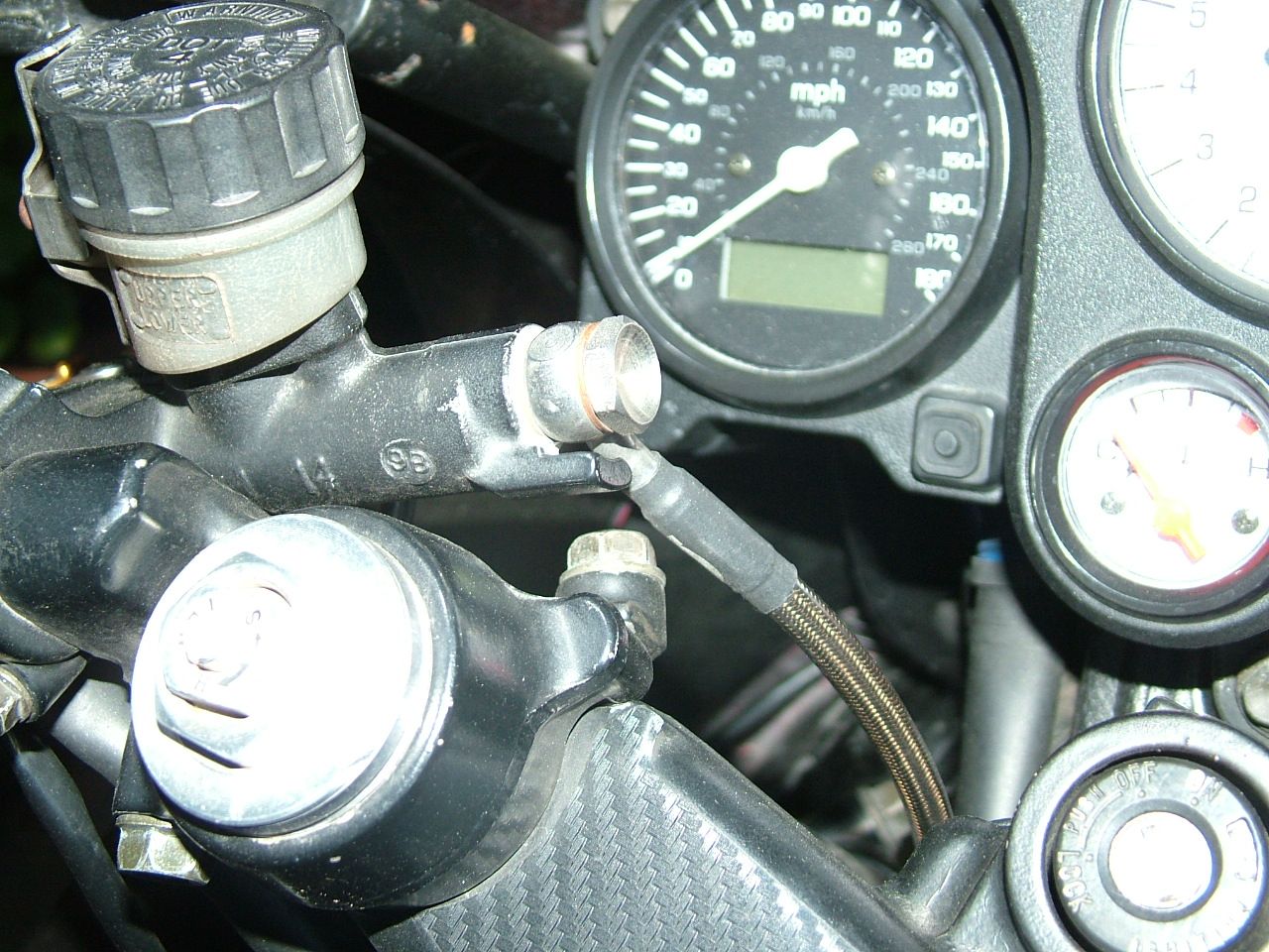

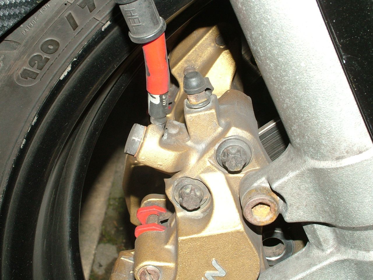

OK some more pics
Front brake master
Fr Right
Fr Left
Clutch Slave
Clutch Master

Niceone pretty much got the same. Hel made them up to the Firestorm spec they use. The only difference I can see are that both the master brake cylinder banjos are 20 degree bends. Its not an issue as they will both clear each other as I can offset them as well.

Cybercarl could you tell me what route you took with your throttle cables when you did the conversion. Below is a photo of my present setup with the standard clipons.
As you can see they pass round to the left of the right fork leg & then out & through the center of the diamond frame. Would this still be the best route to take when I fit the risers or do i need to go to the right side of the right fork leg?
Re: Race brake line setup
I left them all as standard when I had the vfr bars no change at all. You will find that braided lines are little longer than the original Honda rubber hoses so you should be OK.
