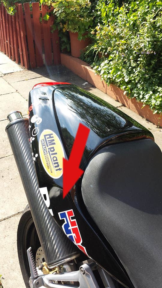

Black being the true test of any Detailers skill not only that, negotiating the curves of a motorbike as appose to a car proved a new and exciting challenge
i think she came up a treat, 1 or 2 spots need some more leveling but this was 4 hours work as it stands
what do you guys think ?

What you use on it?

Full process was wash dry then clay bar all bodywork
3m rotary polisher
hex logic orange pad with meguiers 105 ultra cut 3 passes
then Hex logic white polishing pad with meguiers 205 finishing 4 passes
Blue 3m super fine pad with 3m se to bring to a nice glossy shine 2 passes
Finished with chemical guys black light

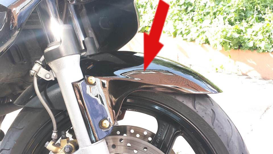

It may be the lighting or reflections but it looks a bit orange peely to me in places.
Zoom in
Lol cheers carl i know those are the only 2 spots left on the bike that need a tad more leveling this was 4 hours work and i couldn't wait t get out on the bike and enjoy the sun so i took the pics plus its my first time doing a motorbike. im to used to doing cars which are tons easier.
