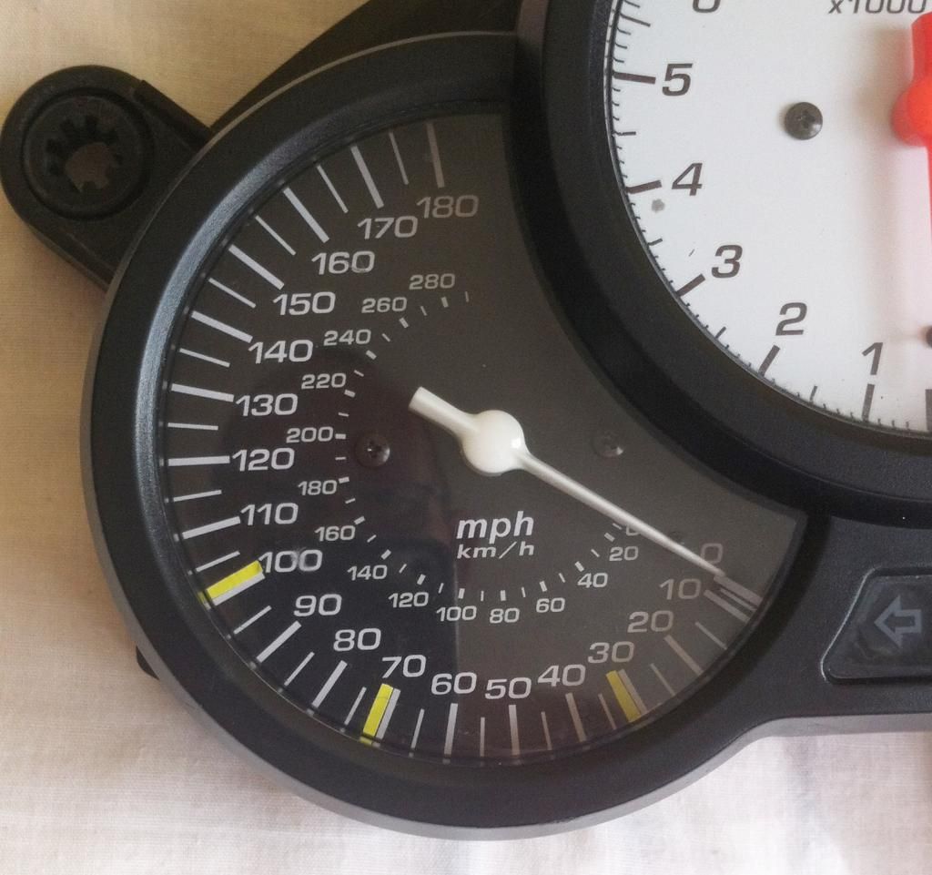

anyone who has a late model storm with the updated dash will know how hard it is to read the speedo at a glance, (lets face it we don't have time to stare at it) so I decided to add a little something, a few strips of bright sticky backed paper, easy to do, remove the clocks from the front subframe, just 3 bolts, then unplug them from the wiring loom, very easy as it's just one plug. then unscrew all the screws along the outside edge of the rear of the clocks, no need to unscrew the screws in the centre. then remove the casing. I used a scapel and some small sticky pads bought from ebay.
then carefully stuck them in place, I choose the 3 main speeds, 30/70/100, hopefully now i'll be able to gauge what speed i'm doing a little easier.

not sure the yellow tape was the best colour, i'm thinking fluorescent orange or bright red would have been better, i'll see how I get on with the yellow first tho.... :thumbup:

here's the darker dash.......Image
